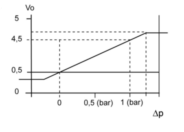

2. Vehicle fitted with Kavlico dpf delta pressure sensor. Replaced twice with kavlico sensors from ebay. Believe it is possible to replace with a Bosch sensor (can dig out reference). Anyone done this? Is it necessary to update the engine ecu, unable to find spec sheets on kavlico and bosch part to understand if likely to be direct replacements.
