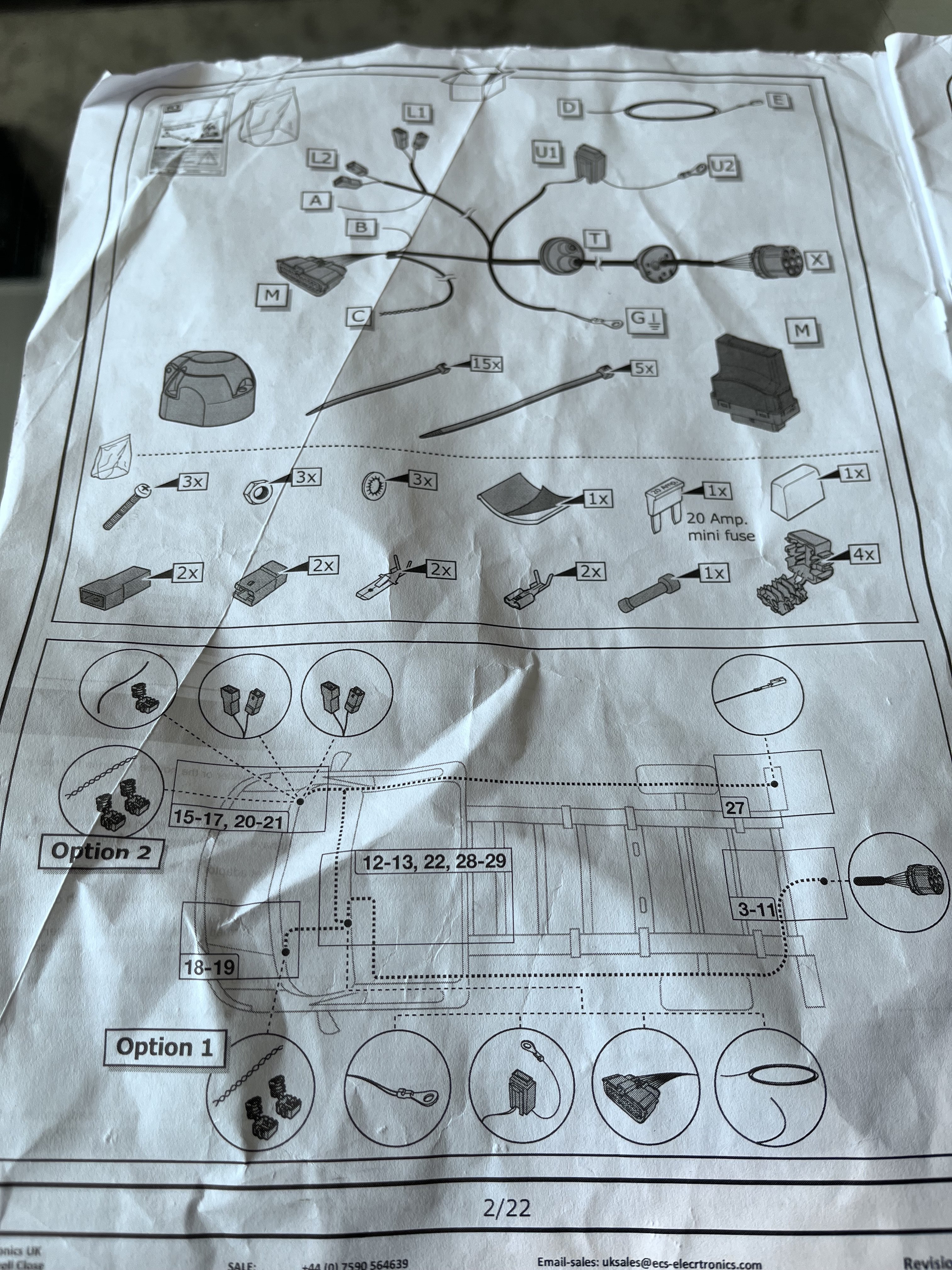

I just fitted a dedicated towbar electrics setup to my 2017 ducato camper conversion… they advertised “plug and play” but it definitely was not… had to do quite a bit of splicing into wire cluster near OBD unit and also on two wires at the back of the OBD unit… since then my Can-bus system had gone crazy… showing many faults and went into limp mode ( all wires are connected as indicated in manual) the mechanic said it’s the electronic pack that’s causing the faults… any advise?
You methods seems to be just like mine expect i didn’t run wires from the rear lights to the electronic unit ( the manual didn’t instruct this)
Fitted the factory sensors to the rear that was pretty simple no messing about and then the fun was towbar electrics it was even easier just daisy chain into the existing lights fit a few modules with double sided tape find an earth and run a wire to the battery like they describe in the instructions. All works a treat. I think it’s the type of kit people buy
sounds like your kit is different from mine… I think I may have to remove mine and get one that’s not messing with the canbus… which one did you get?
There seems to be several “dedicated” types on eBay for ducato. The one I got was ECS Electronics so I thought it would be legit… but there is no connection to the rear lights.. all connections are up front except for the sensor wire, which is optional if you are a sensor on/off switch like I have
View attachment 429212View attachment 429213
That is the one I have it’s simple it simply piggy backs onto your rear lights then you run the live under the vehicle to the battery. Or ring them guys they are really helpful
Hello Sfrain145,
I am not sure this is the one you have… this doesn’t piggy back off the rear lights… you need to take another look. This involves splicing into the wire loom under the dashboard behind the OBD socket
