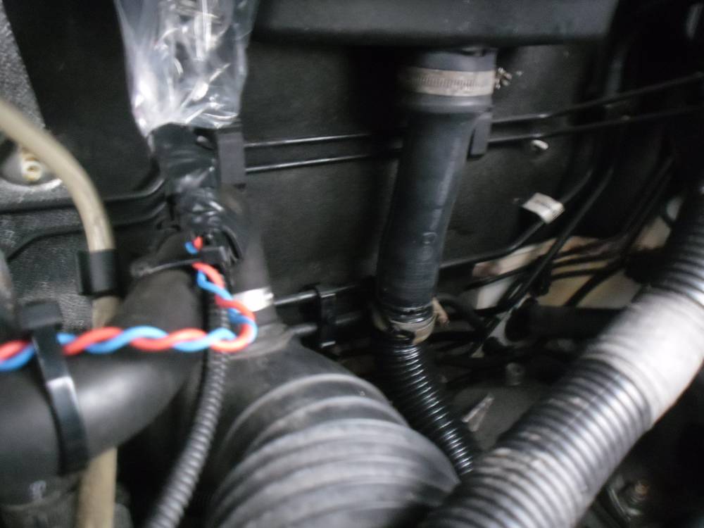

hi all I was talking to a chap who had to have a new gearbox because of water ingress from the drain pipe coming from the heater intake dripping on the gearbox so I have cut the existing pipe & extended it past the gearbox as in photo plus sprayed copper grease on the joints P.S if anyone wants to know what the red & blue wires are in the photo they are from the EGR cheater
