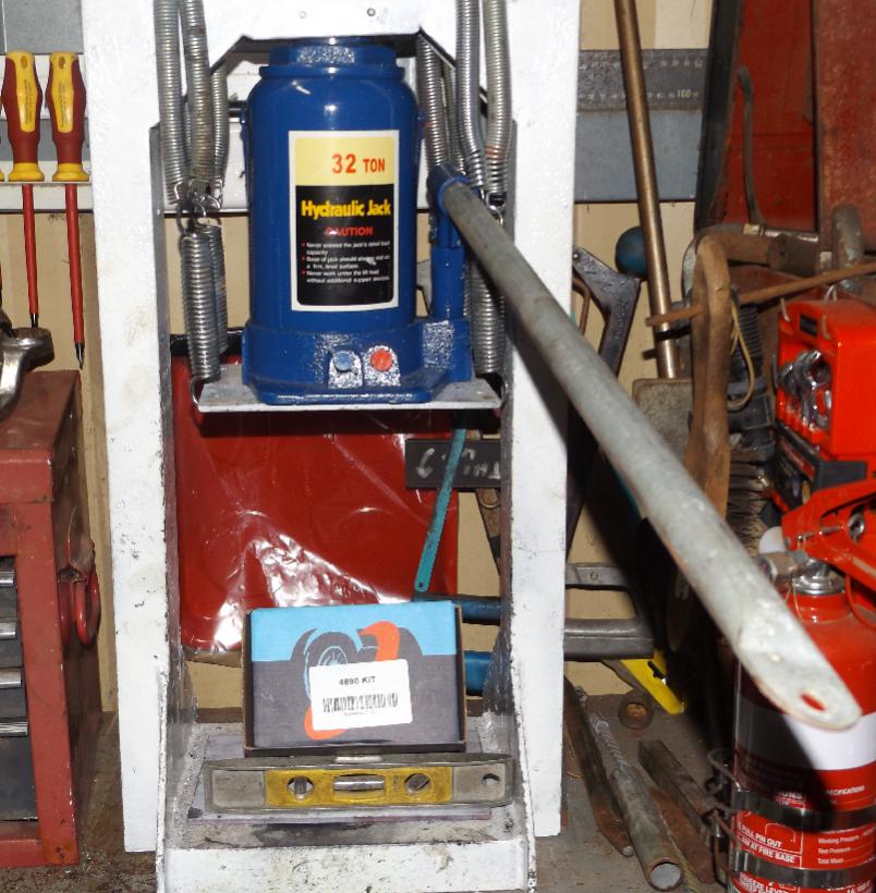

I changed out my passenger (gearbox) side, front wheel bearing, and it is unfortunately not for the novice
The front wheel bearing is a sealed and preloaded, double cone and cup, thrust bearing, which is pushed into the housing, held by a circlip, with the wheel hub pushed through the bearing
If your mechanic needs a few pointers here is how I did mine
I am not a mechanic, just an old Fitter Turner/Machinist. (Retired Maintenance Fitter), so you follow this guide at your own risk.
1. Remove the assembly from the vehicle. (Hard but not impossible if you have the correct tools).
2. Push out the wheel hub from the bearing. (I only just managed this using a 32 tonne jack, set up in a home made press/jig)
3. Remove the large circlip which is now visible
4. Push the bearing out of the housing. (Easier than the wheel hub, but still tight)
5. You can now measure the bearing, as there are different sizes
The size of my bearing was (in mm) 90 OD - 55 ID - 60 length
Bearing Kit # 4890
Below is a pic of the home made jig/press, with the oversize handle I had to use
