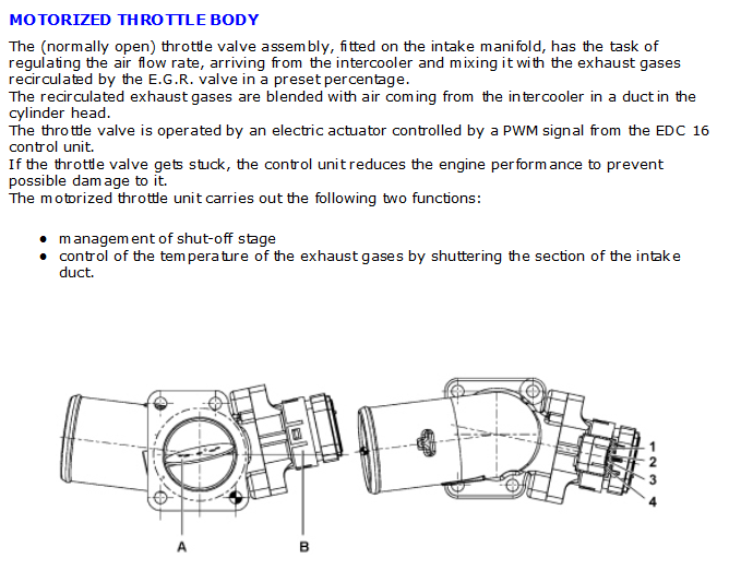

Btw, throttle body is normally fully open if I'm not mistaking. See screenshot.

Historically, the throttle body was added as part of the EGR system to manage manifold pressure and thereby encourage EGR flow, traditional diesels had no need for throttling. The flap will only partially shut during specific running conditions e.g. light load cruising and after idling for a minute or two. It also shuts during switch off to prevent judder, but that's just a bonus. The rest of the time it should be wide open.

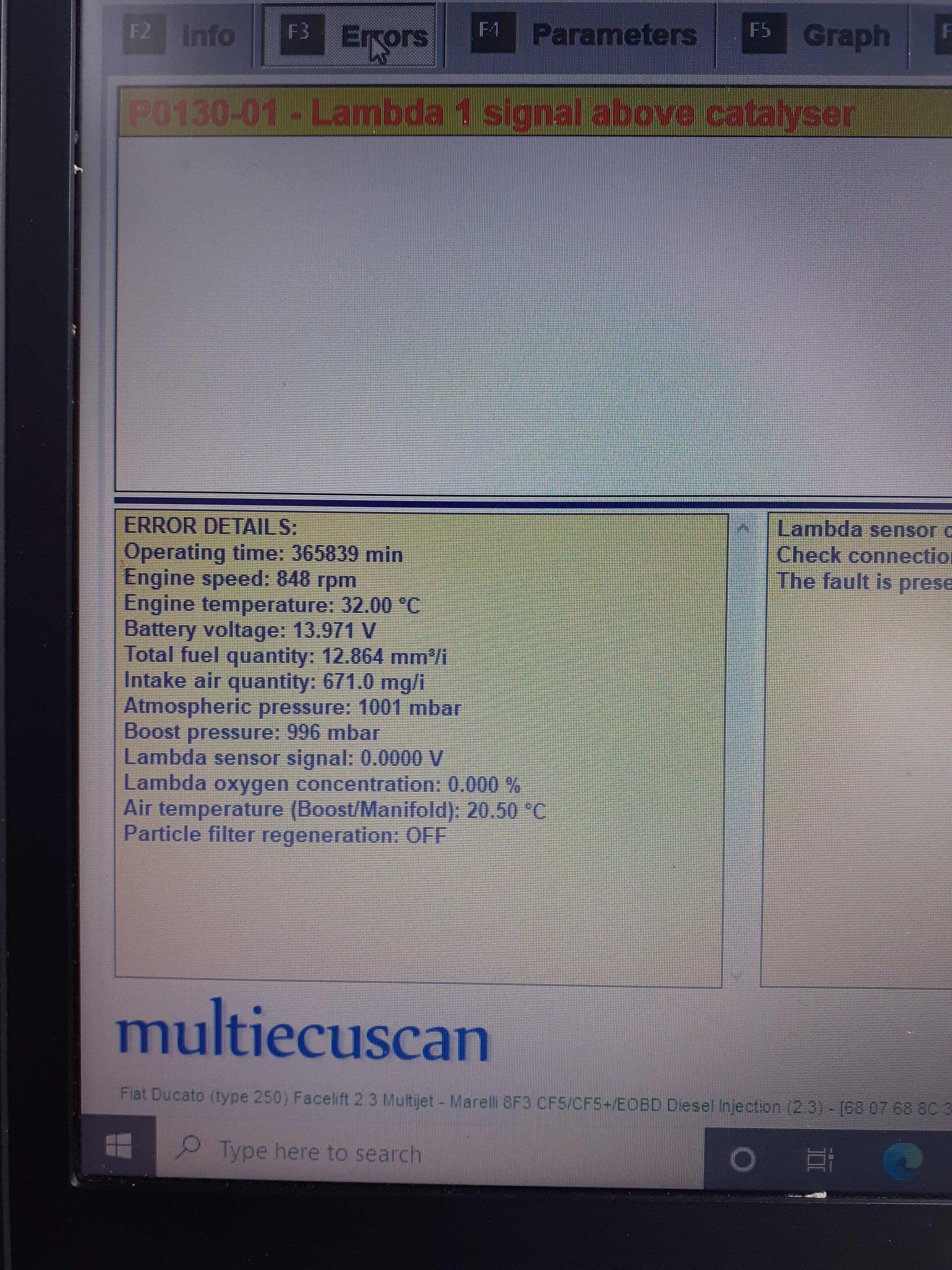

I've been meaning to post an update on that. Oddly, the answer is yes but also no. So injector 2 is coded using multiecuscan, no problem. Injector 1 however, using the same process looks like it's doing it but when checked in Parameters, the new code hasn't updated. So I swapped the injectors 1 + 2, same result. I can code either injector into cyl 2 but neither into cyl 1. Weird.
Anyway the better data collected by multiecuscan as opposed to my previous tool has given me something else to think about. The P0130 lambda sensor code which I thought was simply from the sensor reading being out of expected range turned out to be in fact the sensor not returning any data at all. So further probing, it looks like a wiring issue to pre cat o2 sensor. I've been trying to identify plug d004 where the wires from o2 sensor terminate so I can do a continuity check and hopefully find which is broken. Anyway that's about where I'm up to with it.
