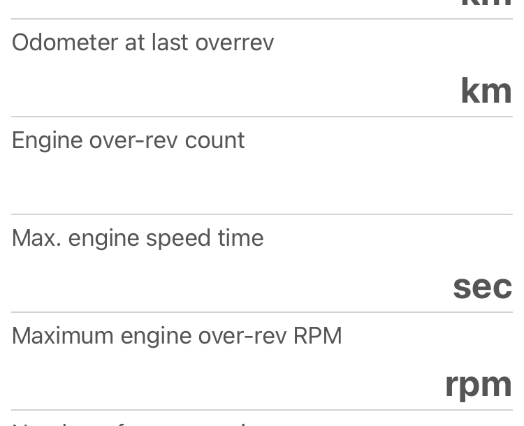

It might depend on ECU model, but for at least some Ducato 290:s (250 Facelift), the ECU actually holds info info on when the last overrev happened. Screen dump from parameter list in Multiecuscan, for Marelli 9DF CF6/EOBD Diesel Injection (2.3), which is the model installed in my 2018:
