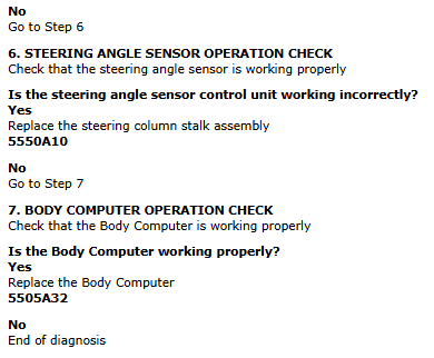

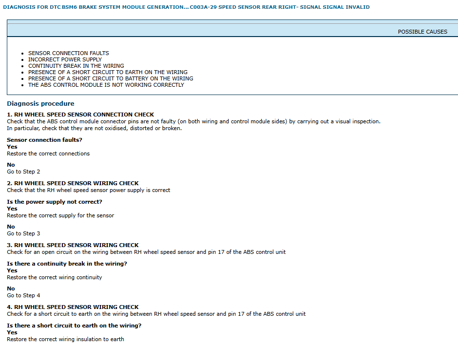

Hello,
The eLearn diagnostics description for the U1712-87:
The doc is missing for the C0034-29 front right wheel, but there's a diagnosis for the rear right one:
Attached also the ABS eLearn doc so you can adapt this part of diagnosis for the correct wheel.

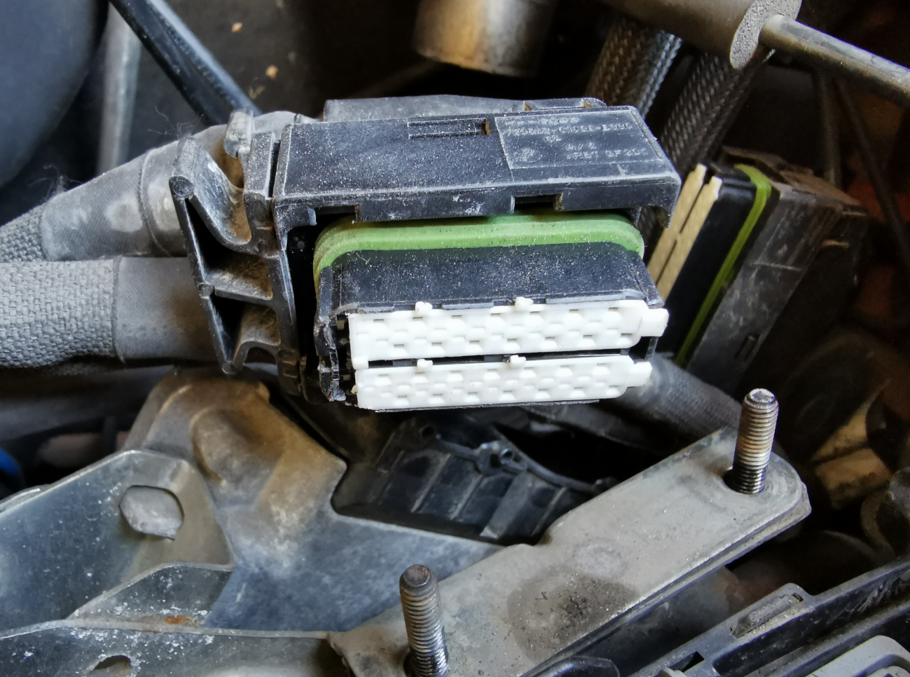

Wondering where the ECU / BCM are - in the engine bay?? Or are they behind the O/S fuse panel inside??
If you were the one to make all those preventive changes, there might hve been some damage done before. However it's not a 20 years old van :)
In the classic commercial van cab the BCM is behind the cover, by the drivers's external knee. The cab fusebox is a part of it.
Usually the ECU is in the engine bay. In my non-diesel van it looks more or less like that:
The connector you can see in the center of the photo is one of the ECUs connectors. The thing in the right bottom corner of the photo is the engine bay fusebox, just as a reference to help you locate the parts :)
