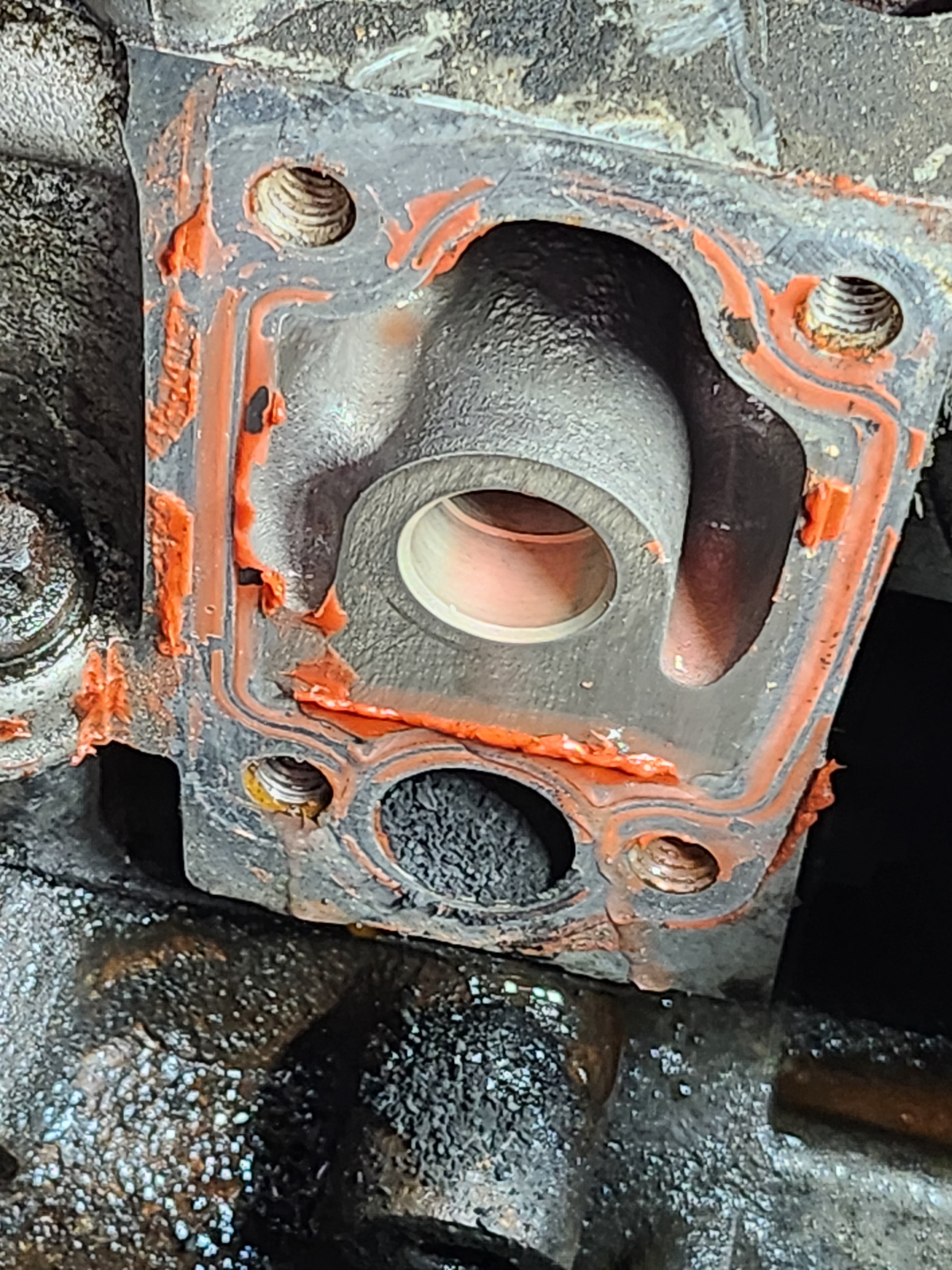

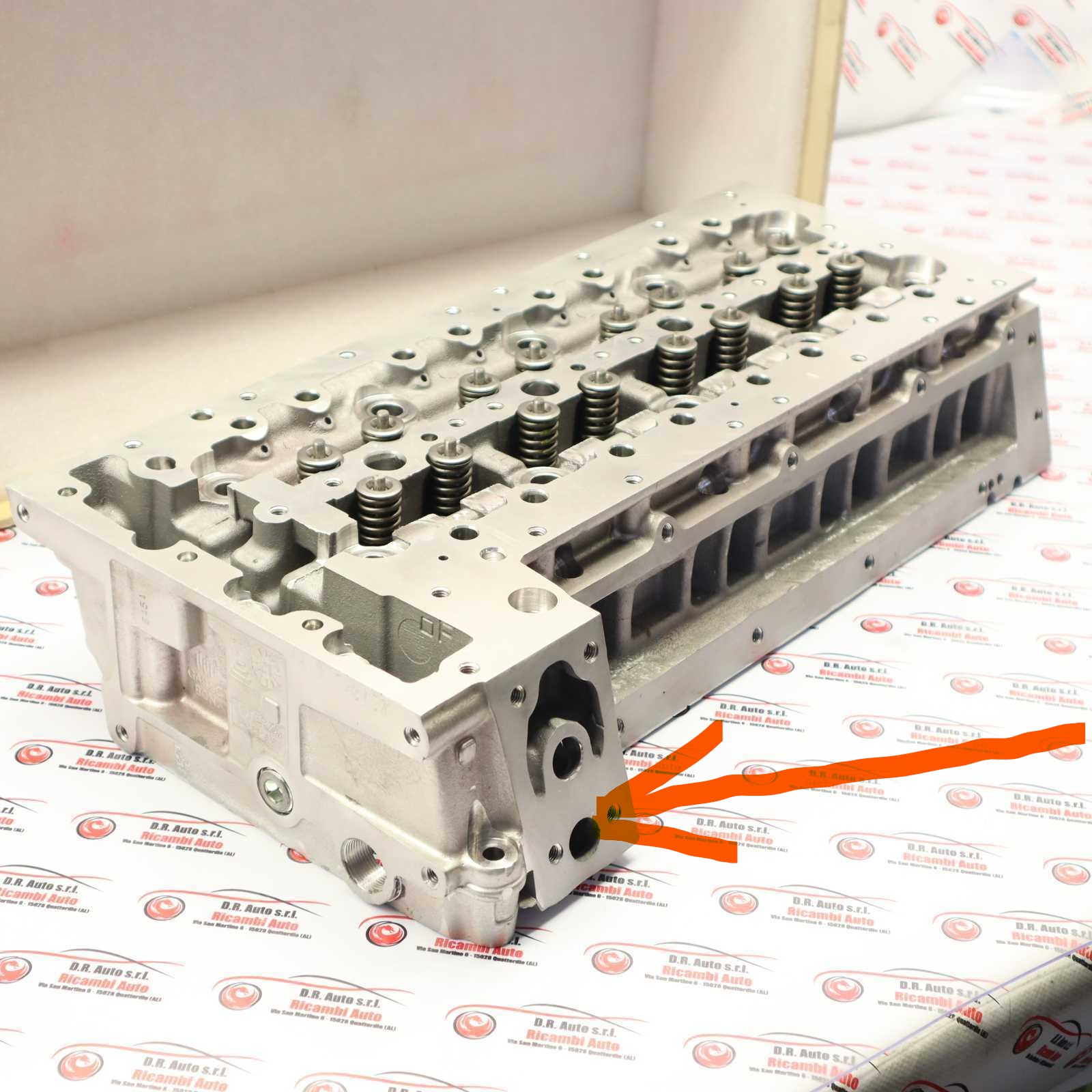

In the attached picture of a cylinder head, what is the highlighted hole for and should it be full of carbon?
The hole is blanked off by the thermostat housing, and the water gallery is the hole above .

As you say, the thermostat housing is clearly designed to blank off this hole. I suspect that it communicates with the inlet manifold, and will be full of carbon due to it being a "backwater" with no through flow. Also, the manifold carbon buildup may be more than usual in your engine if it has been run without a thermostat, as it will have been over-cooled to some extent for the whole time it has been running without one. Carbon/oil mostly condenses out from the recirculated exhaust gas when the EGR system is in operation. Why Fiat put a hole there can only be guessed at. Maybe for a sensor of some sort that was superseded ?
If you remove the throttle body from the top of the intake manifold (mind you don't shear off the bolts, stop if it looks corroded or they are very tight !) you will be able to look into the manifold and judge the carbon buildup. I suspect the passages are generously sized so a bit of deposit doesn't matter, but if it is seriously coked up you might want to remove it and get it cleaned out.
I'd recommend fitting the thermostat housing with a proper factory style solid gasket rather than silicone sealant which can break off and get lodged in the cooling system. Also, there is a small possibility that the gasket thickness will affect the thermostat operation.

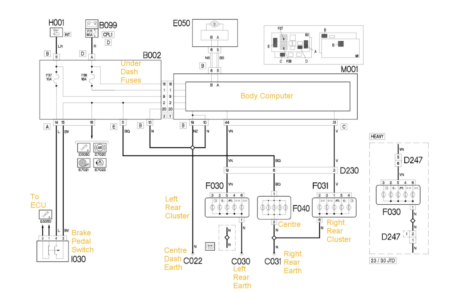

The only other thing I can think of is that if the ECU detects that the footbrake is being applied at the same time as you have your foot on the throttle, it will deliberately cut power. The brake light switch has two sets of contacts, one for the lights and one to signal to the ECU. A bit of a long shot but worth checking that the contacts are doing their job and the switch isn't coming on when it shouldn't be.
