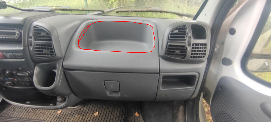

Hi! I have a Fiat Ducato from 2006, which we have rebuilt to a camper. We would like to place a baby seat in one of the passenger seat but can't really find out for sure that there are no passenger airbag. Anyone now if this model is equipped with these? Looks like in the pics.
I'm fairly confident there are no airbag but want to be 100% sure :)

As far as I remember in the x244 the passenger airbag was installed here, in the place of the tray:
Here's a listing for a 2003 passenger airbag, you can see on the photos how does it look like:
Thanks!! Yes that is how I have understood it aswell. Tried to remove the tray to see if I could see anything, and didn't see anything resembling the unit you linked. So seems I could be pretty confident I got the no airbag version! :)
If youhave the tray as you do, then no passenger airbag.
