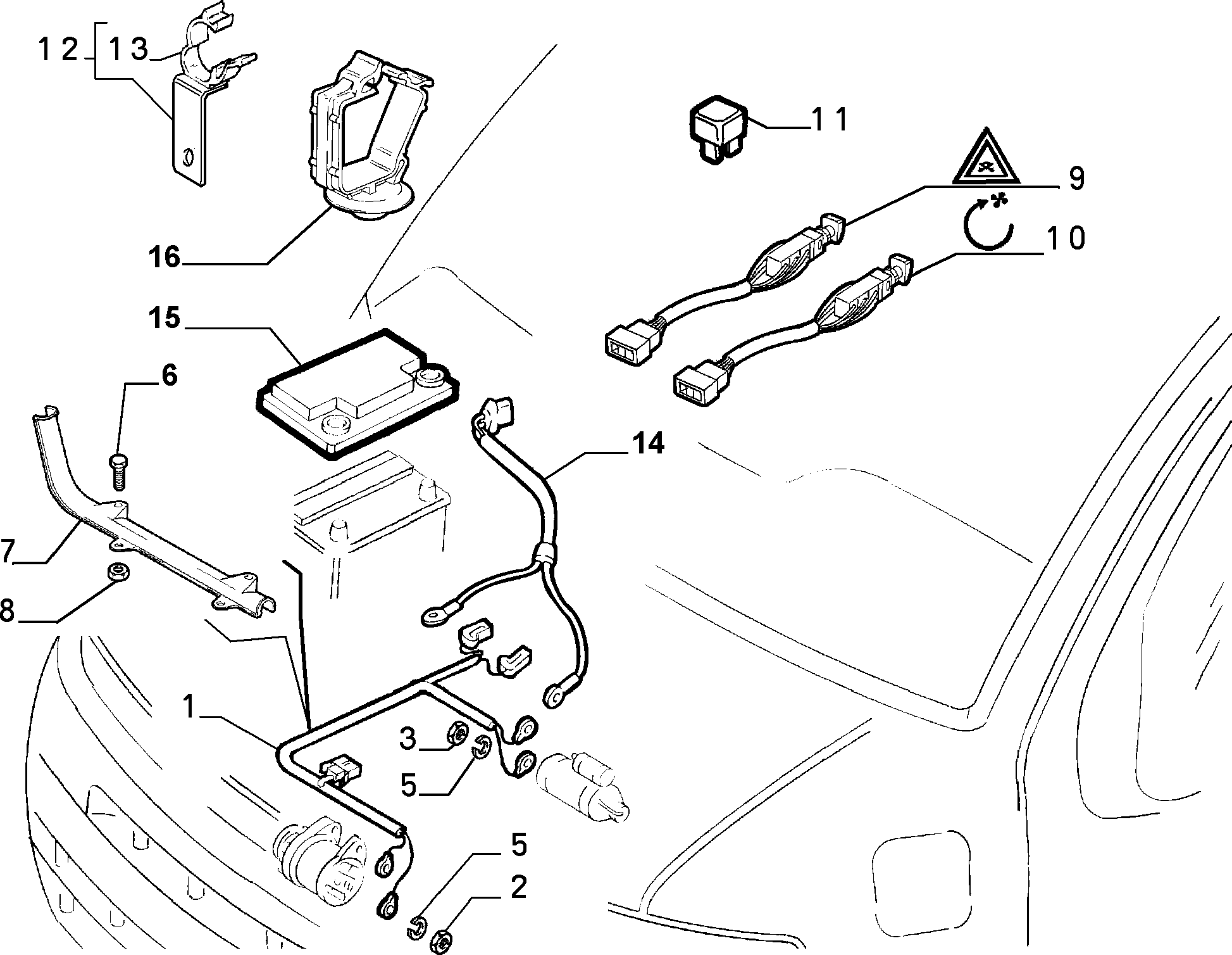

Hi Im new here. I just replaced a very corroded cross member on my 2005 Ducato motorhome. It was fairly easy job all done from underneath. However there was metal tube conduit clamp that curled up on the offside attached to the top of the member holding a braided hose which literally crumbled apart. Mounted on top of this was a plastic box type cable holder. Could anyone please identify what this metal conduit is called please? or what the hose is for as i cant find one anywhere. I have used a piece of plastic trunking for now but im concerned why the original part was metal?

I have this afternoon, examined my 2006 x244 Ducato from underneath.
At the RHS of the crossmember, under the intercooler and for about 7cms, (3") under the radiator the battery positive cable to the starter solenoid is protected by a shaped semi-circular metal shield (starter cable shield?) which curves upwards at the RHS end. The starter cable is further protected by a braided plastic mesh, which can clearly be seen where this cable bends backwards towards the solenoid. The other end of the cable can be seen where it terminates at the battery fusebox to the RH rear of the battery.
I think that the braiding on the starter cable is your crumbling braid. The starter cable protector, or shield, will be a steel pressing to give extra protection to the cable. See below.
Again under the intercooler the is a plastic box like cable protector. It is fixed over the starter cable shield and carries the battery negative cable, which runs to the clutch housing close to the starter motor. This same negative cable has a "tee" flag terminal to the main chassis earth point under the front (-ve) end of the battery, before continuing upwards to the battery -ve clamp terminal.
In addition to the previously mentioned heavy cables, there is a split corrugated 16mm plastic conduit which passes all the way under the intercooler (through the plastic "box" protector) and under the radiator. This conduit is only loosely held by oversize cable clips. I am thinking of adding some small cable ties to secure it to the clips.
The conduit carries 3 or 4 thin wires, the purpose of which I have not ascertained.

Thanks Varesecrazy, using the link I identified the part numbered 7 in this attached diagram.
ts called protection but i still wasnt sure what it was protecting and from what.
Thanks Communicator you have identified it as the protection for the braided starter positive cable, which I assumed was a hose.
Just to verify it was the metal protector that crumbled apart not the cable or braiding, that looks fine.
What I need to know now is what it is offering protection from heat/impact etc? and do i really need to spend 49 Euros for a new one or could i improvise something myself?

I think that the protection is more likely to be physical than thermal, as the cable is in the possible impact zone of a front end collision, as I previously stated unfused
If it was thermal, the negative cable is probably more exposed.
The part number 1312045080 only seems to bring up results from other countries. Does anyone know where I can get the part in the UK or if has a different part number here? Thanks.
