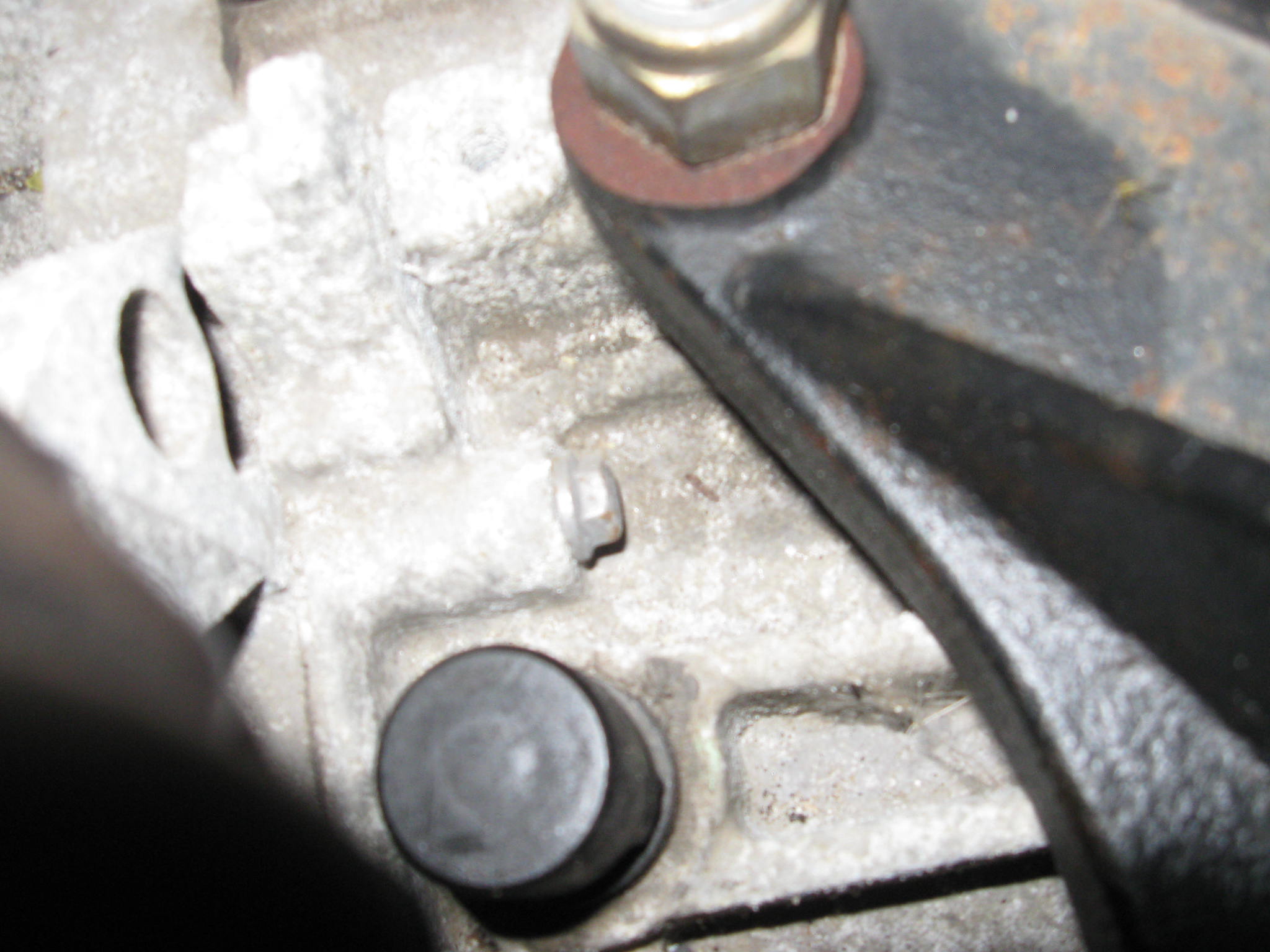

I have recently changed my gearbox oil and while inspecting the various brands noticed that Carlube 75W80 has the specification API GL4/GL5 so bought this!
I have attached a picture of the breather through which I topped up (the black casting is the gearbox mounting bracket so will aid location) however the airfilter housing needs to be removed first.
PS My van is a 2006 2.8JTD so picture will apply to this model only.
