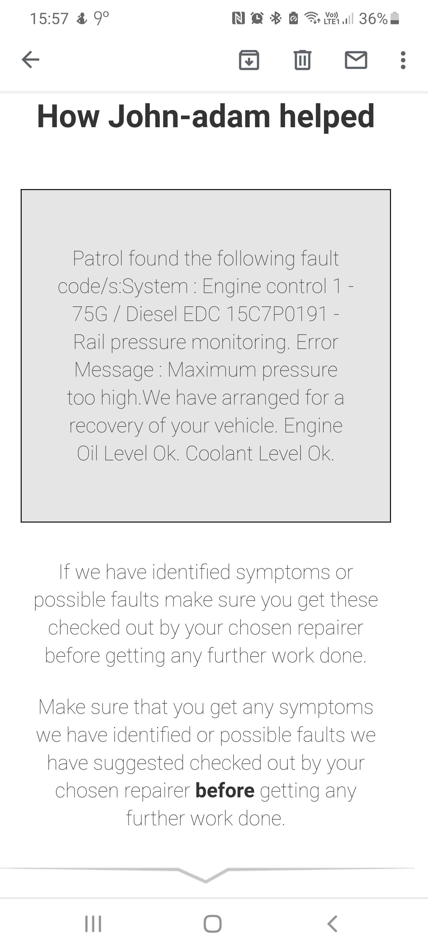

Hi all, I've a Swift Sundance 590RL with the above engine, went for a drive last weekend and after driving for 30 minutes when pulling into a parking space the engine cutout. Got towed back by The AA. The engine starts but cuts out after 5-10 seconds. Does anyone have any ideas on how to fix? Many thanks in advance. David.

Thanks for the replies, take it or for a run about once a week but hasn't been out for a couple of weeks due to Christmas shopping/work, see attached for The AA codes.
