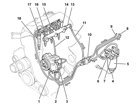

Found some diagram
It won't be easy, because return line needs to be intercepted, that means getting both 11 (rail return line) and 18 (injector overflow) flows back to can and it's hard or impossible to get access to 11.
They join at 10 and go with fuel line 9 back to fuel tank. Perhaps it's possible to intercept the return at the fuel pump on the driver's side (at least for LHD) and feed it back to can.
If I manage to work it out I will post some pictures.

I see what you are trying to achieve, possibly another way would be to do it at the fuel tank using the flow and returns at the fuel pump in tank but disconnecting the fuel tank wiring plug if no where else easy to access.
My main concern regarding in effect running the vehicle on neat cleaner is at that concentration the lubricating properties that diesel injection system relies on to function will be almost zero as cleaning agent is going to be more detergent/petrol? than lubricating diesel so could cause excessive wear in expensive mechanical moving parts in the pump and injectors, also damage any rubber types seals designed for diesel.

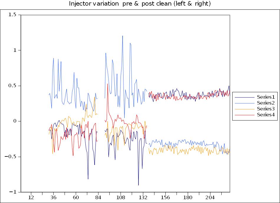

Still haven't had chance to drive test properly after cleaning, but car is running just fine.
Corrections on idle have improved on 1st injector (even though it hasn't been coded properly it just yet due to IMA code incompatibility).
I can still smell diesel a bit when engine is cold, there is some improvement here, but not 100%.
What has certainly changed is that pressure builds up way quicker, so car starts couple cranks earlier than before. Not sure if this was the 1st injector stick leaking or perhaps couple others that have been cleaned now, but there is an improvement here.
