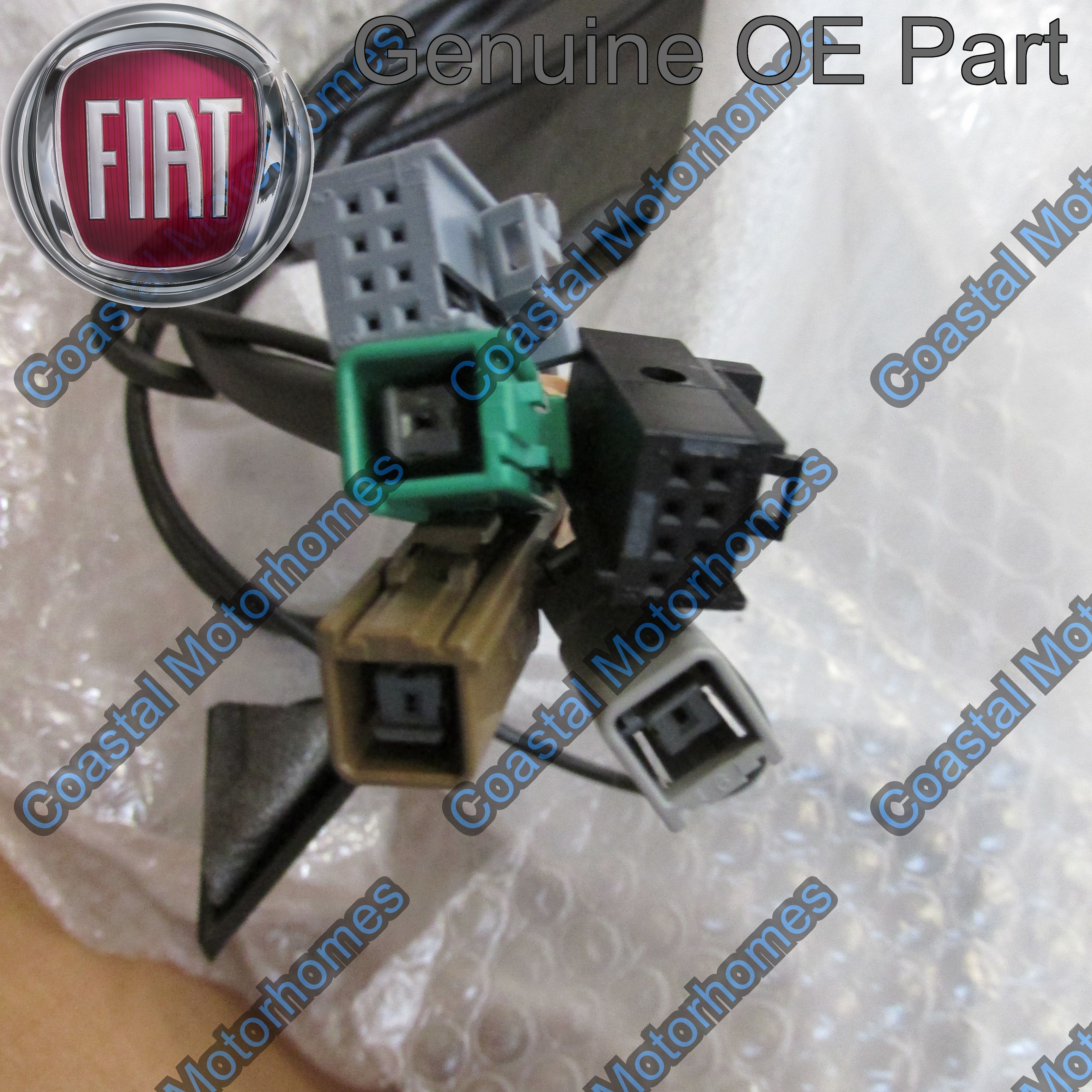

fiat_ducato_peugeot_boxer_citroen_relay_long_arm_rear_view_mirror_2006-2014_34546_3_.jpg
The eight-way connectors fit into a (retained) mating block under the door window switch panel. I could, however, believe that any aerial connection(s) might be "floating", and I'm not clear on how that is routed.
So viewing the image of these threads 2 of them have female 8 way connectors, and the other 3 have single female plug in connectors. I haven't used a single female connector on my MH, just a be 8 socket female plug in connector.

As already said, it's only conjecture as to any additional cabling being for an aerial (though it is a likely option).
In the picture above, the additional (grey) 8-pin would be used to provide power to the amplified mirror aerial. (and, I think, power-fold if fitted, which is unlikely). If it reflects practice at the other mirror for the temperature sensor, it should connect in the door next to the black 8-pin.
The other single female connectors are for the aerial signal (though I would have expected at most two, FM and DAB - the picture is simply an example of differential wiring).

I can assure you that (where heated mirrors are fitted) they are fitted to both sides. All the standard mirror functions (movement and heating) are provided through the black 8-pin connector on either side.
Where other options are present, the grey connector is used - power folding on each side, mirror aerial amplifier supply on passenger side (RHD) and temperature sensor on drivers side (RHD). Where a mirror aerial is fitted, there will also be at least one aerial lead present.
(BTW, I wasn't suggesting the pictured mirror was suitable for your vehicle, simply using it as an example of the connections that might be present).
