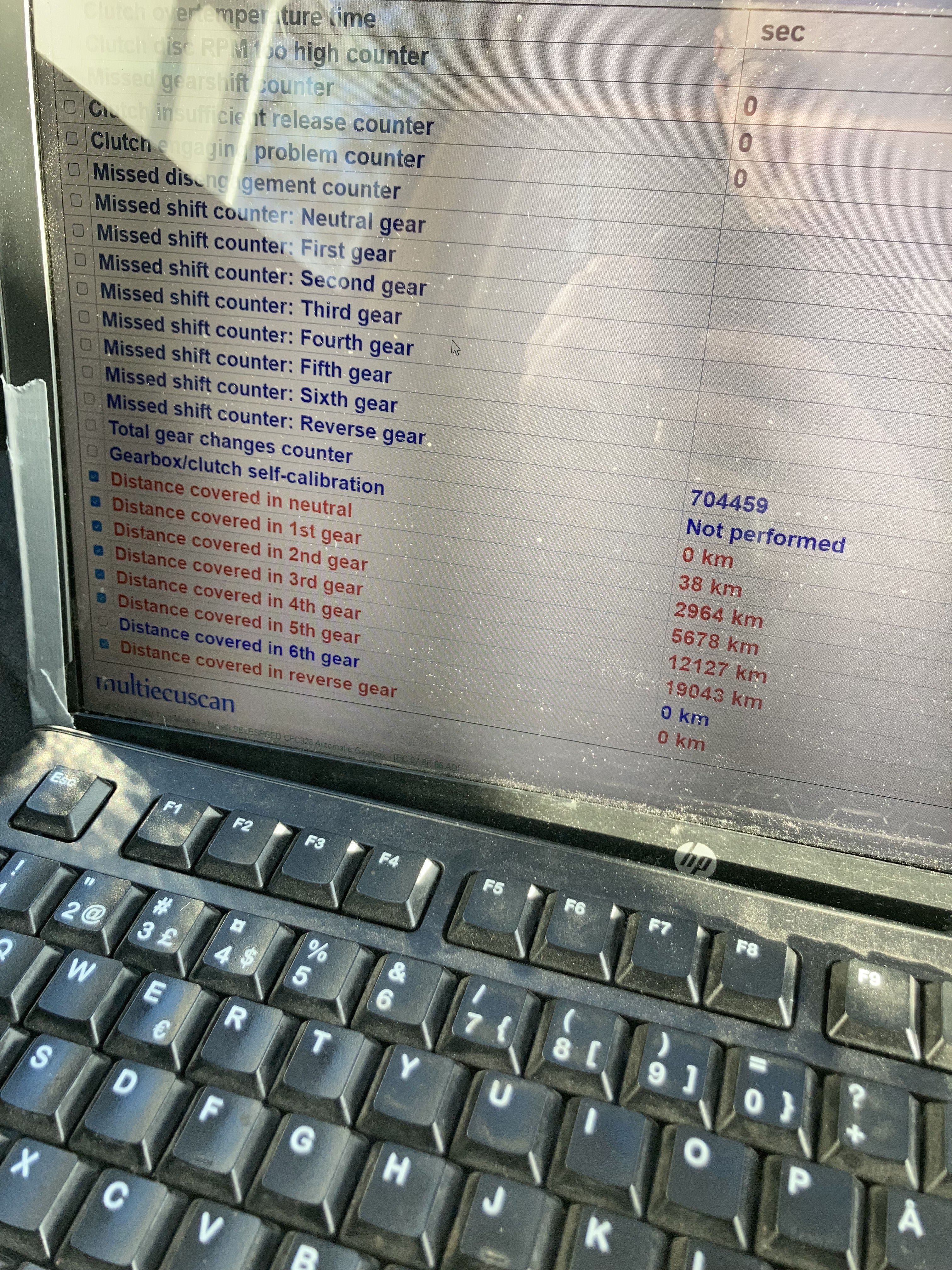

Id had been cared for real good, MES Says last delete of fault codes in ECU was at 5400km and we are at 189.000km now.
But one thing his mechanic forgot is, the hydraulic fluid had newer been changed. Same with gearbox oil.
I changed the ATF with help from the web, and MES. Drives good, no problems. But i also want to change the gearbox oil, but i just can't see no fill plug.

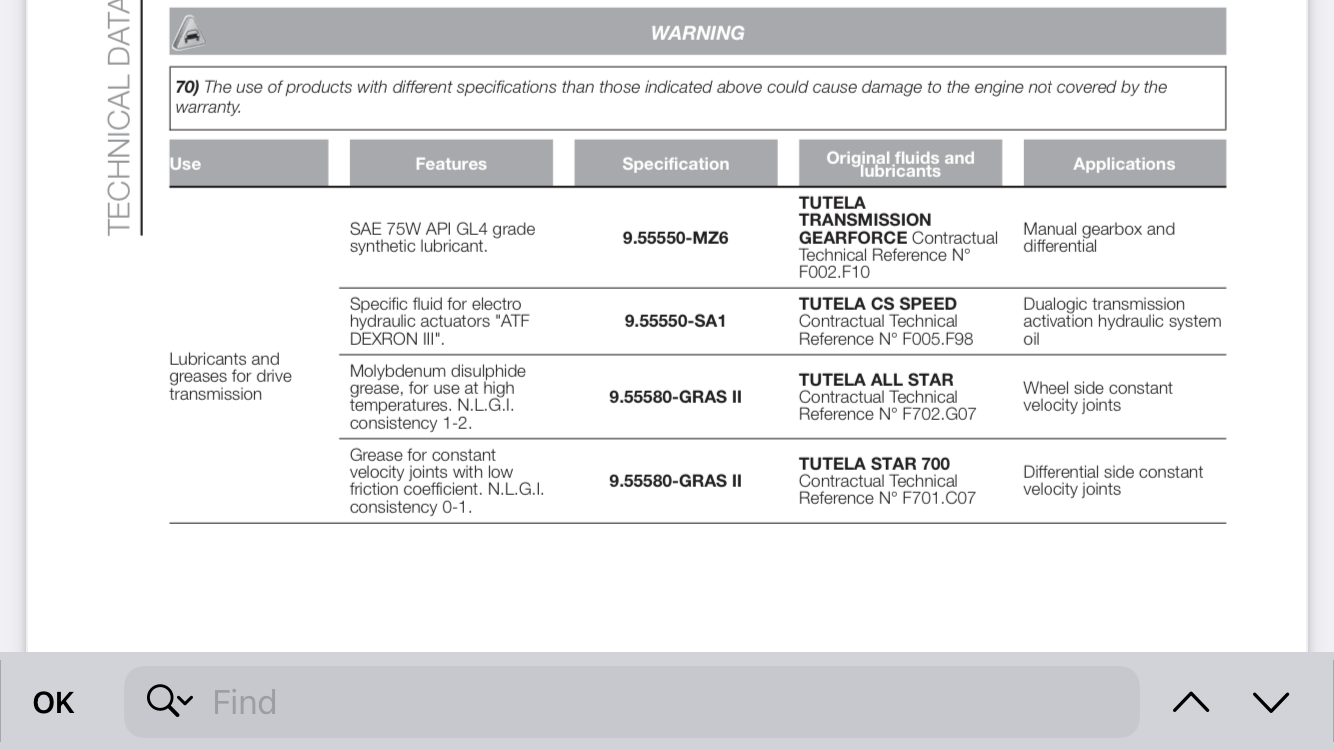

I looked in the manual to see which fluid the selespeed needed, it said ATF Dextron III so that’s what it got, even from Castrol. So it should be happy.

Used to MES to remove the air, filled it up to max. Then used MES to check there still was no air, no probs.
And then calibration.

Not sure if you had a handbook for the US automatics (which are conventional torque converter boxes) but the Dualogic/Selespeed normally uses Tutela CS Speed fluid in the actuator - straw coloured. Different fluids can shorten the life of the seals and accumulator....
Unless the spec was different in far northern Europe, maybe because of climate? Might be worth double-checking.

It sure says Tuttela, but also states what it equals too. So that’s what I used, since I can’t get a hold of Tuttela so easy here.
