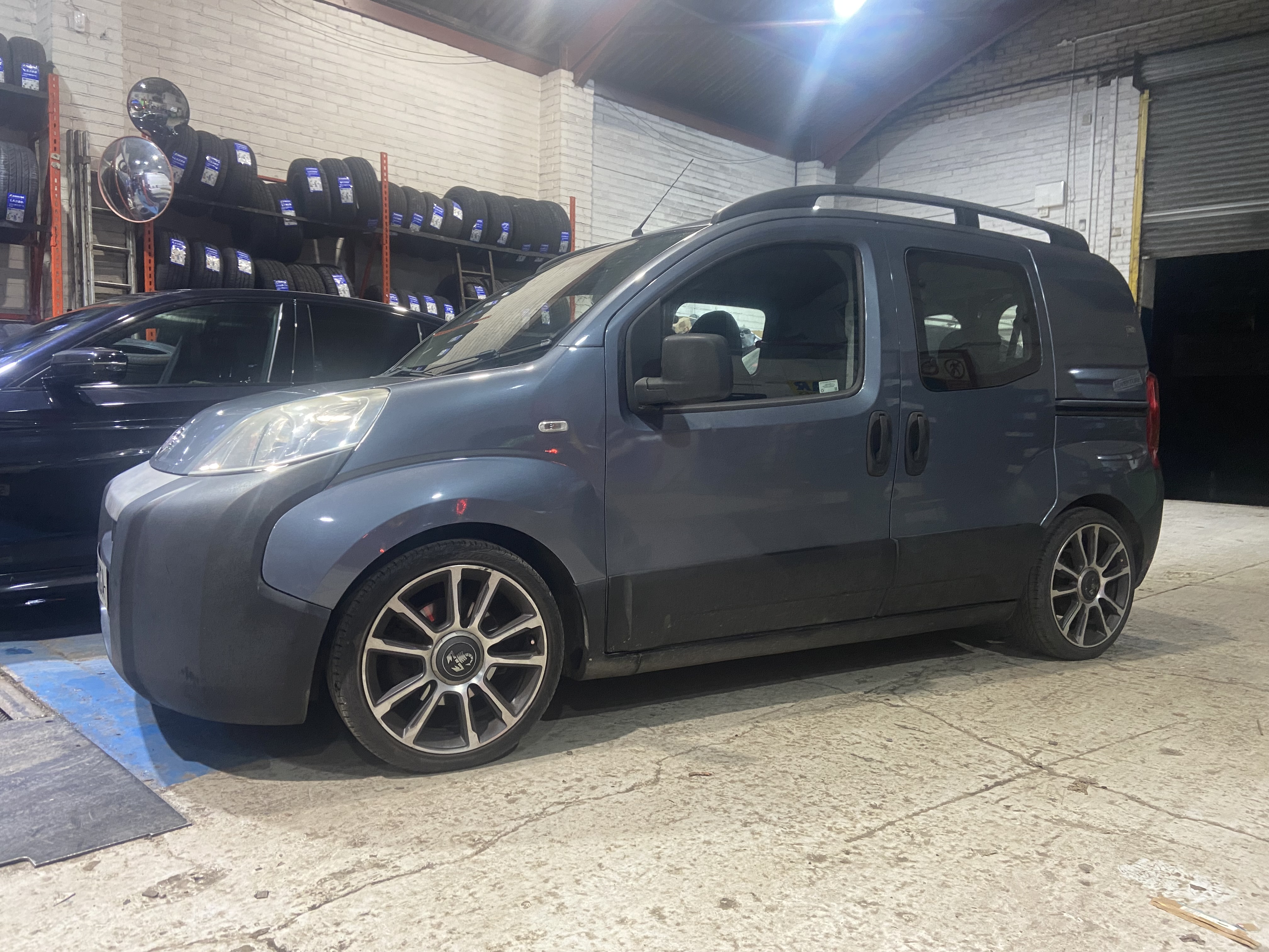

F Fiorinofan69 Member Parked in the garage Joined Apr 17, 2025 Messages 27 Points 60 Location Blackpool Feb 14, 2026 #1 Before and after lowering on corsa d springs and new dampers. Rear springs ended up on the bump stops, so cut the originals down half a coil. Model Fiorino 1.3 multijet Year 2015 Mileage 72000
