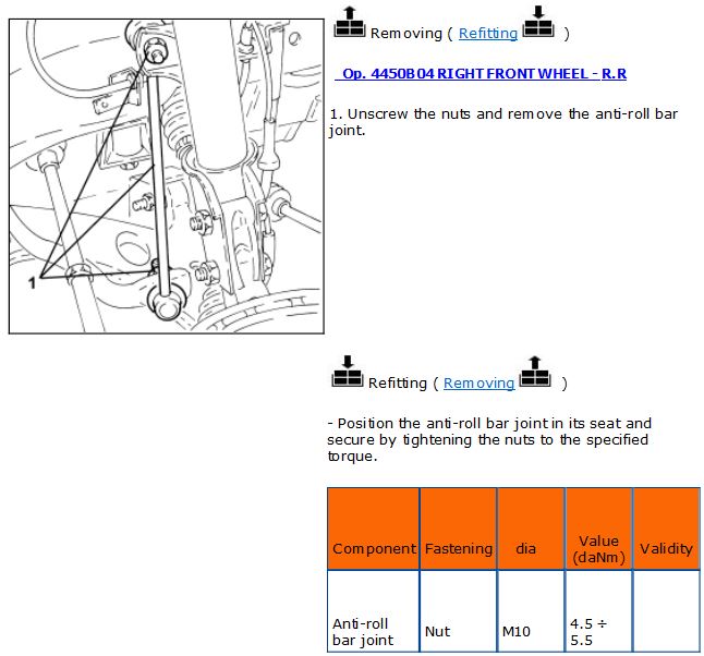

Hey guys
Have a grande punto tjet 2009.
I need to change.my drop links in next few days was wondering if anyone knew what the torque spec (in Nm) is for the nuts that hold the link in place?
Thanks
Hi Emerson,
here's what you asked for ...
BRs, Bernie

Hi,
Changed these myself last week, was 50nm of torque or if you have an old torque wrench like mine it was 37 lbf ft.
