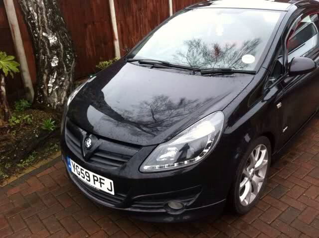

The reason why you might not find the Built in ones is because you will need a control module
When DRL's are near the indicators, you need to have a unit to DIM or turn off the DRL units when indicating, so the indicator stands out

So is it worth the hassle and cash?
Got a link to the control unit out of interest Ziggy?
Yes IMO, although I'd just fit some in the bumper for ease and will be cheaper.
Decent set from Ring automotive lighting will only be about £60 all in, even less if you shop about![]()
But Ring make kits which are alot easier to fit from the video's
Here is the ebay link the Genlabs Dim on indicator setup
I too would highly recommend having Bumper DRL's instead
Why?
Cheaper - Alot cheaper (£15 switch difference to start with)
Here is a Dim on sidelight/headlight unit
You can also get some E-marked units cheaper with a seperate switch vs Ring
