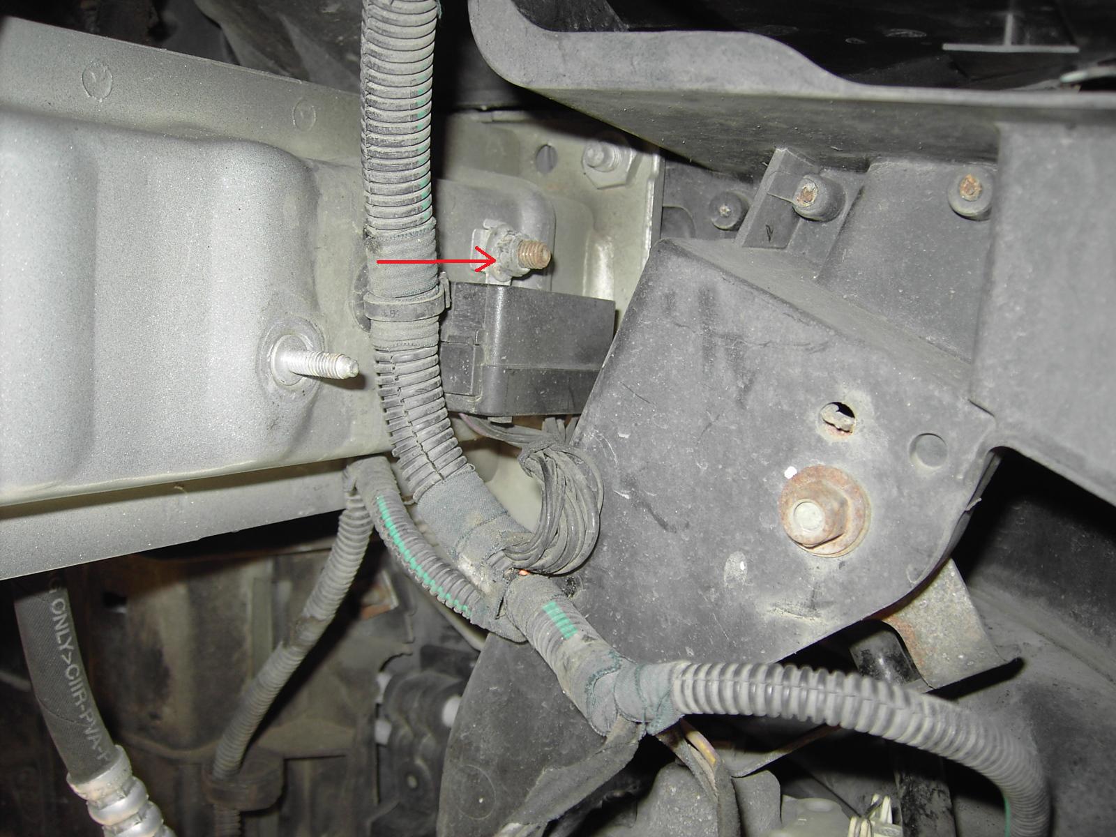

A light going dim when switching another one on in the same cluster suggests a poor earth connection. The right front light earth connection is inside the right wheel arch below the headlamp. Remove and clean the connector where the nut holds it to the body. The left earth connection may be inside the left wheel arch symmetrically opposite or may share the similar looking connector on the inner wing near the battery.

A light going dim when switching another one on i the same cluster suggests a poor earth connection. The right front light earth connection is inside the right wheel arch below the headlamp. Remove and clean the connector where the nut holds it to the body. The left earth connection may be inside the left wheel arch symmetrically opposite or may share the similar looking connector on the inner wing near the battery.

Its not going dim Daveren the fogs are not illuminating at any point be it side lights headlamps or main beam and headlamps when the main beam is put on with the fogs it kills all the lights in the headlamp cluster bar the side lights and indicator where as when trying to turn them on with the headlamps or side lights the tell tail lights (as it does with the main beam) BUT no fogs but the headlamps stay lit.....
someone looks to have been in the fuse box before as the fuse was in on the **** slightly but that is sound and getting 12v constantly on both legs of the fuse
the battery cover is in place and the board on top anyway looked dry with no water staining or furry terminals
Am i right in assuming the headlamp clusters share the same earth for all functions?
Yes.... the earth from each light cluster is a black wire from pin 14 on each cluster connector.
