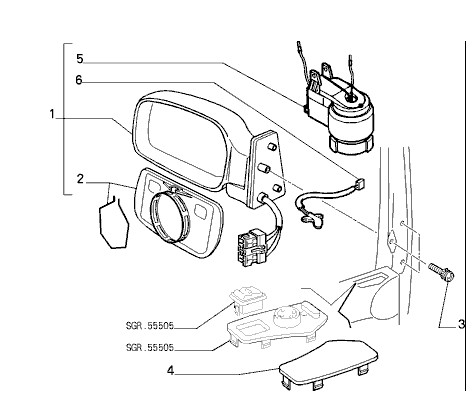

I have just found a picture of what the mirror looks like, its item 2. The spring clip holds it in place.
Gordon
PS hope this works

I have now purchased the part and have included pictures of the Mirror Housing and the back of the mirror for future use. It is similar to the picture Gordon posted. I eventually bought it from Desira for the price of £13.09 inclusive. This worked out less then Melbury Motors once the postage was taken into account, plus no risk of losing it in the post. The part number for the drivers side mirror is 9464243680.

Hi Lou
Yep that looks like the same fixing, its fiddly but its just a push fit in. Glad you didn't have to pay £30 plus like I did. Don't break this one.

Here is the Ulysse mirror - click for pricing info for each part :) I think this is cost to the dealership, although prices may be slightly out of date. However, knowledge is power.
