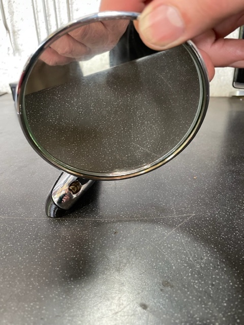

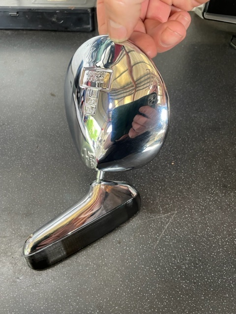

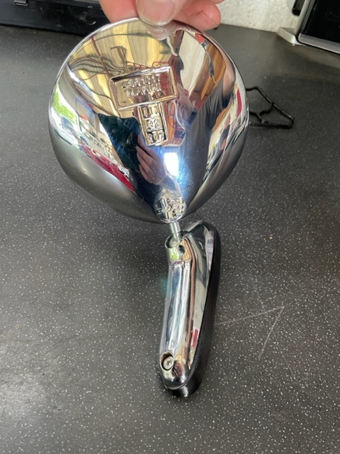

We have a customers Fiat 500L in the garage at the moment and the owner wants to improve safety whilst his daughter drives the car, The driver's side has a classic Marin Door Mirror fitted (car is right hand drive). We are led to believe they are now difficult to obtain but we found one with a

Alfa Romeo symbol stamped into the chrome housing and very nice to, however, there was not a chance of it working because the angles are all wrong (common problem with door mirrors). Having 3D printers in the garage we quickly printed a plinth that allows the mirror to be fitted and more importantly to actually work and allow vision down the rear n/s.

We have a customers Fiat 500L in the garage at the moment and the owner wants to improve safety whilst his daughter drives the car, The driver's side has a classic Marin Door Mirror fitted (car is right hand drive). We are led to believe they are now difficult to obtain but we found one with aView attachment 407109View attachment 407110View attachment 407112 Alfa Romeo symbol stamped into the chrome housing and very nice to, however, there was not a chance of it working because the angles are all wrong (common problem with door mirrors). Having 3D printers in the garage we quickly printed a plinth that allows the mirror to be fitted and more importantly to actually work and allow vision down the rear n/s.
When you buy these mirrors as a set,they normally comewith 2 'handed' plinths---one for the o/s and one for the n/s. How did you attach the plinth to the door---they normally come with rubber'plugs' that put into a correctly spaced holes in the door and then the plinth is held by self-taping screws screwed into the rubber plugs. A sounder system is to use "riv-nuts" insteadof the rubber plugs (and threaded screws)

We 3D printed a template so we knew the drilled holes in the door are in the exact position for the nut-serts. Our 3D printers gets us out of a lot of problems and not just car related.
