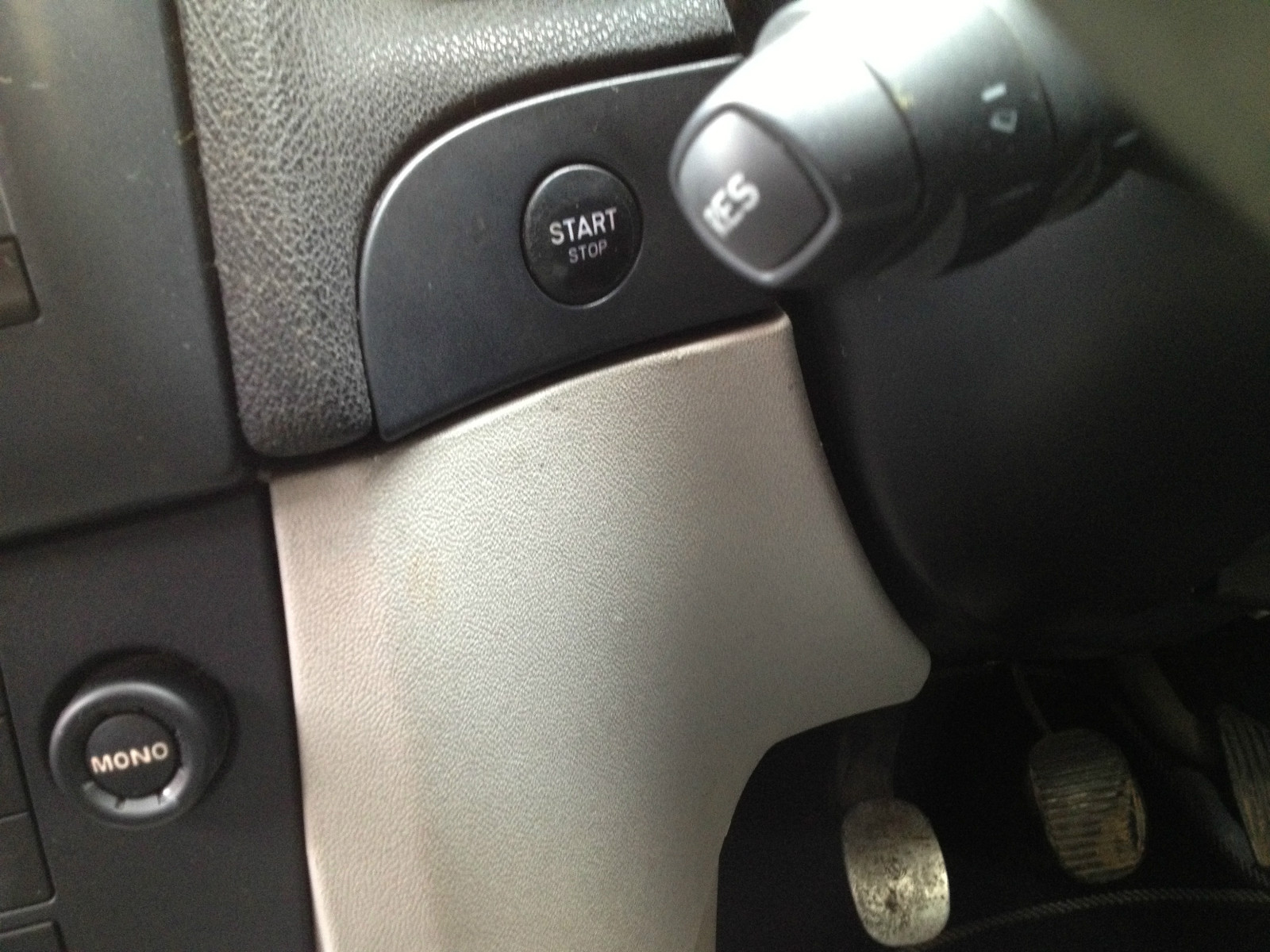

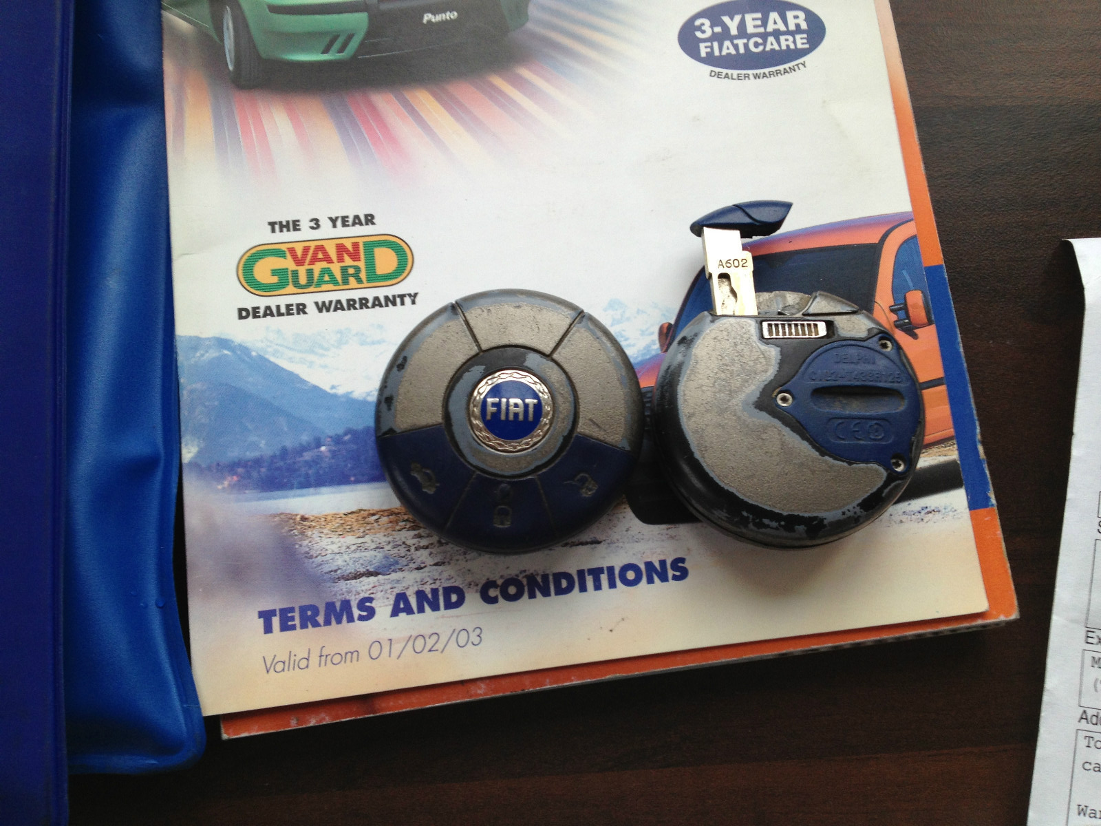

What is passive entry?
Keyless entry and start. Also known as "EasyGo"
You have a small fob that stays in your pocket. If you're within a few metres of the car, the doors unlock. As you walk away from the car it locks.
You start the car with a Start/Stop button on the dashboard, but only if the fob is inside the car. Very few UK registered Stilos had passive entry.
