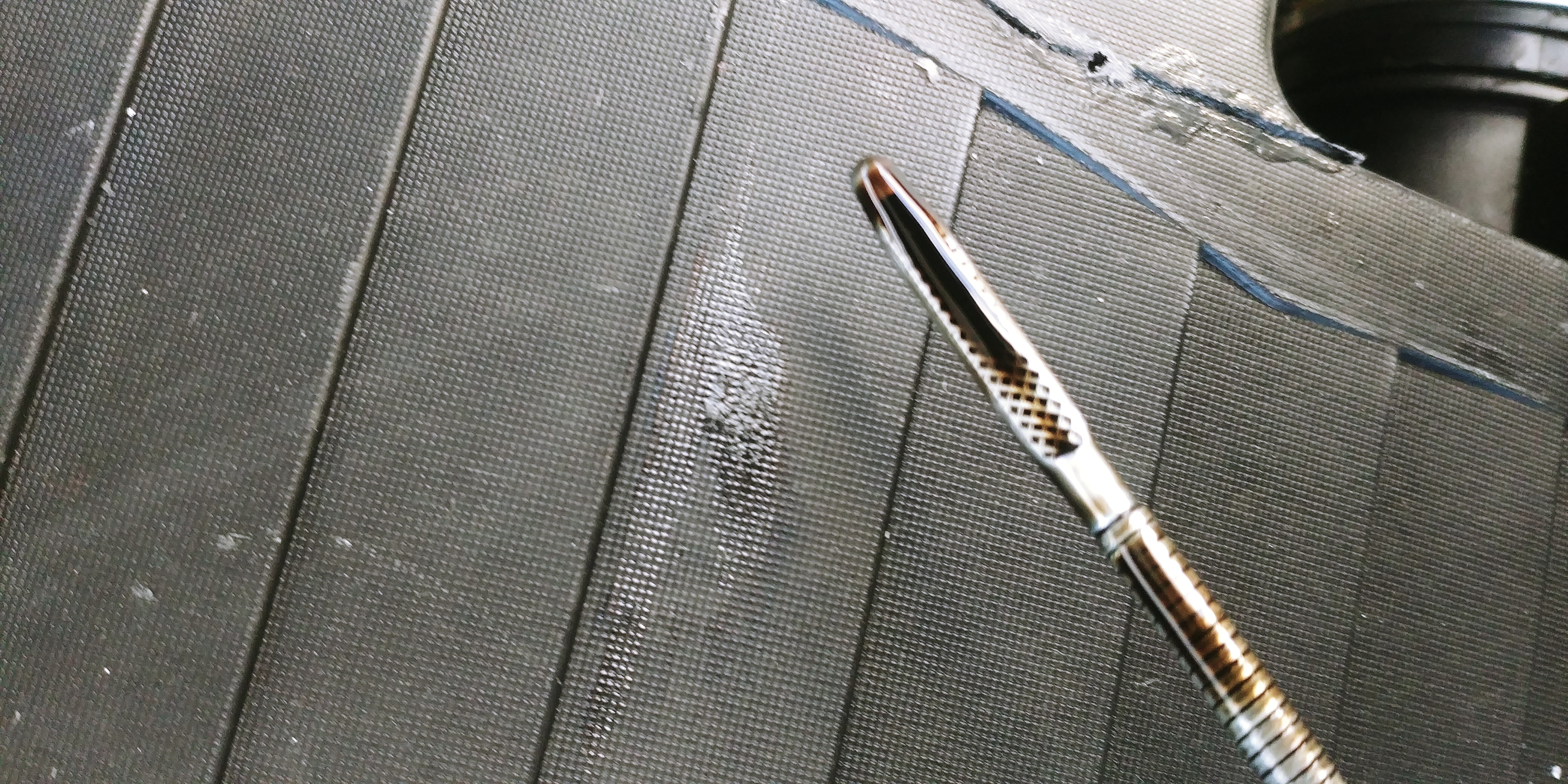

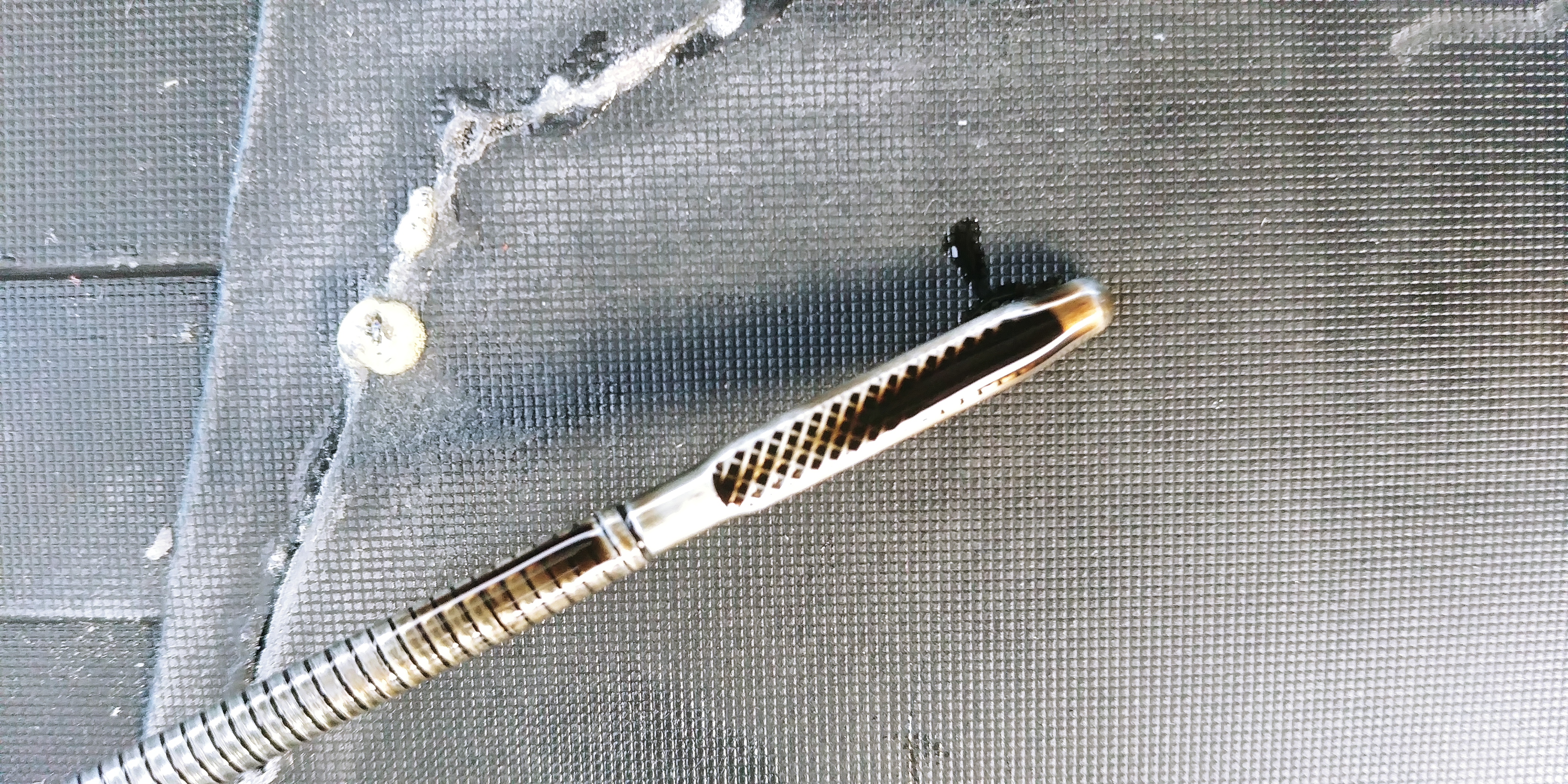

slightly related matter would you say the oil level on this is about right the oil on this dosnt seem to leave a clear mark of the stick to me
ive cleaner the dipstick off before reinserting it to get a new reading
Ps excuse the cracked Engine cover
Yes that oil level looks OK. The flattened and hatched area is the acceptable range.

Maybe it's just my eyes going wierd but it looks really clear now I looks at it again ?

Regards dip stick take it out wipe off again put back in but don't push fully home leave 1/2" out then when you take out the level should be 1/2" down from the max mark
That's an issue with most modern oils.
To check the oil level, I'd suggest you follow this procedure.
1. Make sure the car is on level ground. Usefully, most garage forecourts are level, reasonably sheltered, and well lit.
2. Remove the dipstick and clean the whole length of it (not just the tip) using a clean cloth. This prevents any residual oil running back down the dipstick. You may need to repeat this process a couple of times to clear any oil from walls of the dipstick tube.
3. Insert the dipstick fully, then remove it, keeping it vertical.
4. Without turning the dipstick on its side, take the reading. It's important not to turn the dipstick on its side (the natural thing to do), as oil will flow along it, giving a false or confusing reading.
Hope this helps.
