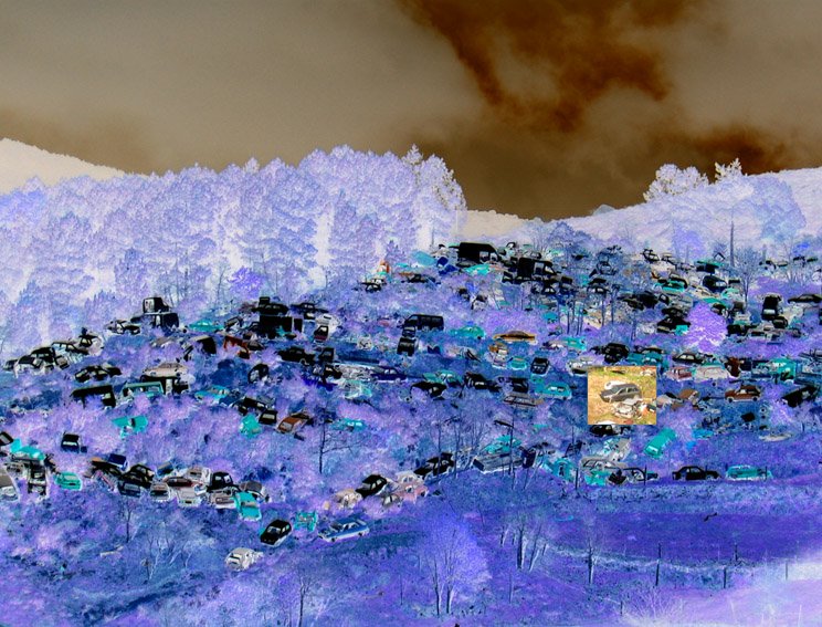

Heres a picture of a scrap yard in Portugal, theres a metallic grey Tipo 5 door to the right of the red Renault 5, I`ve highlighted it... I`m sure there will be something similar close to you.
http://www.flickr.com/photos/89707735@N00/25889191/
