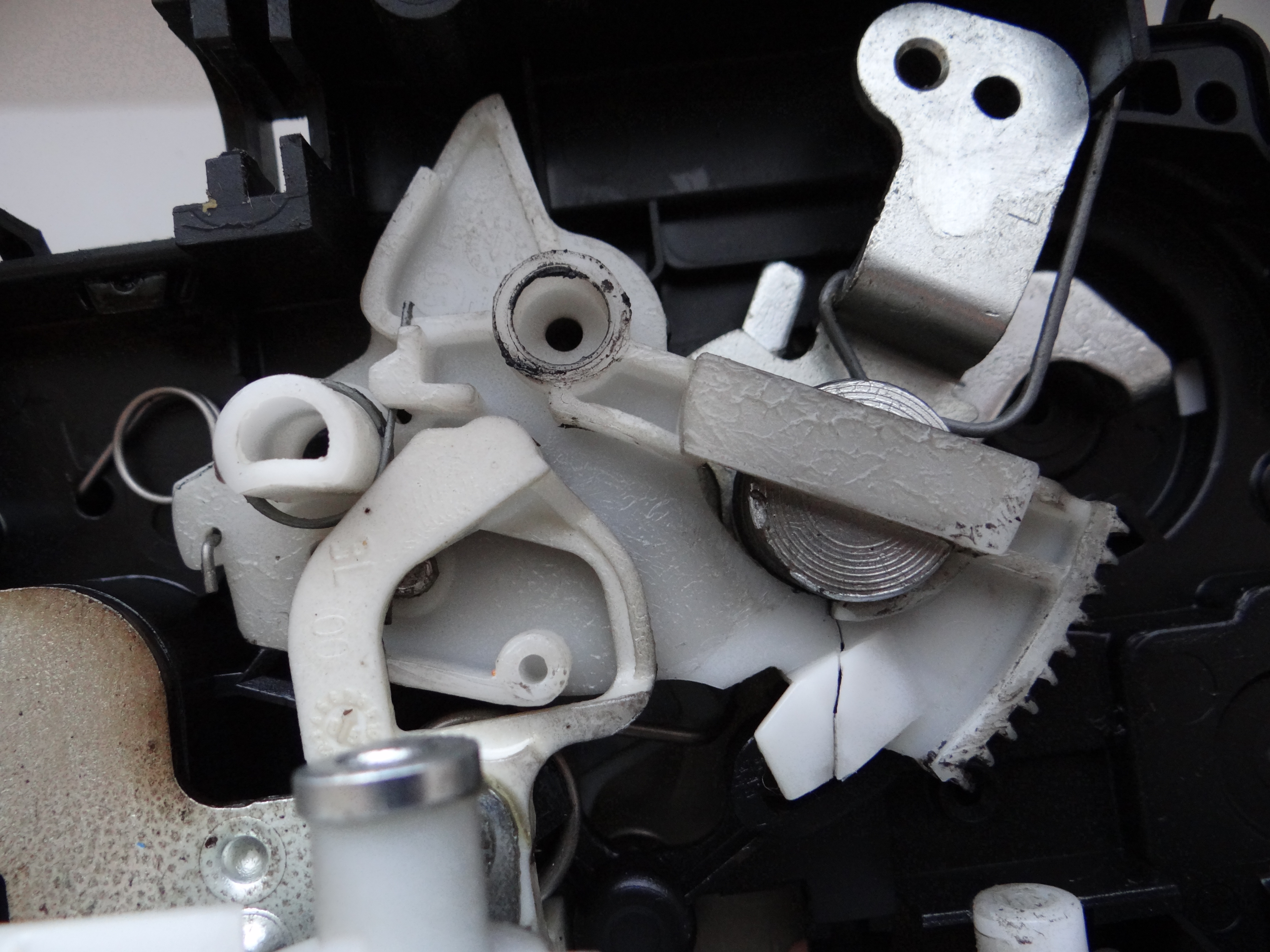

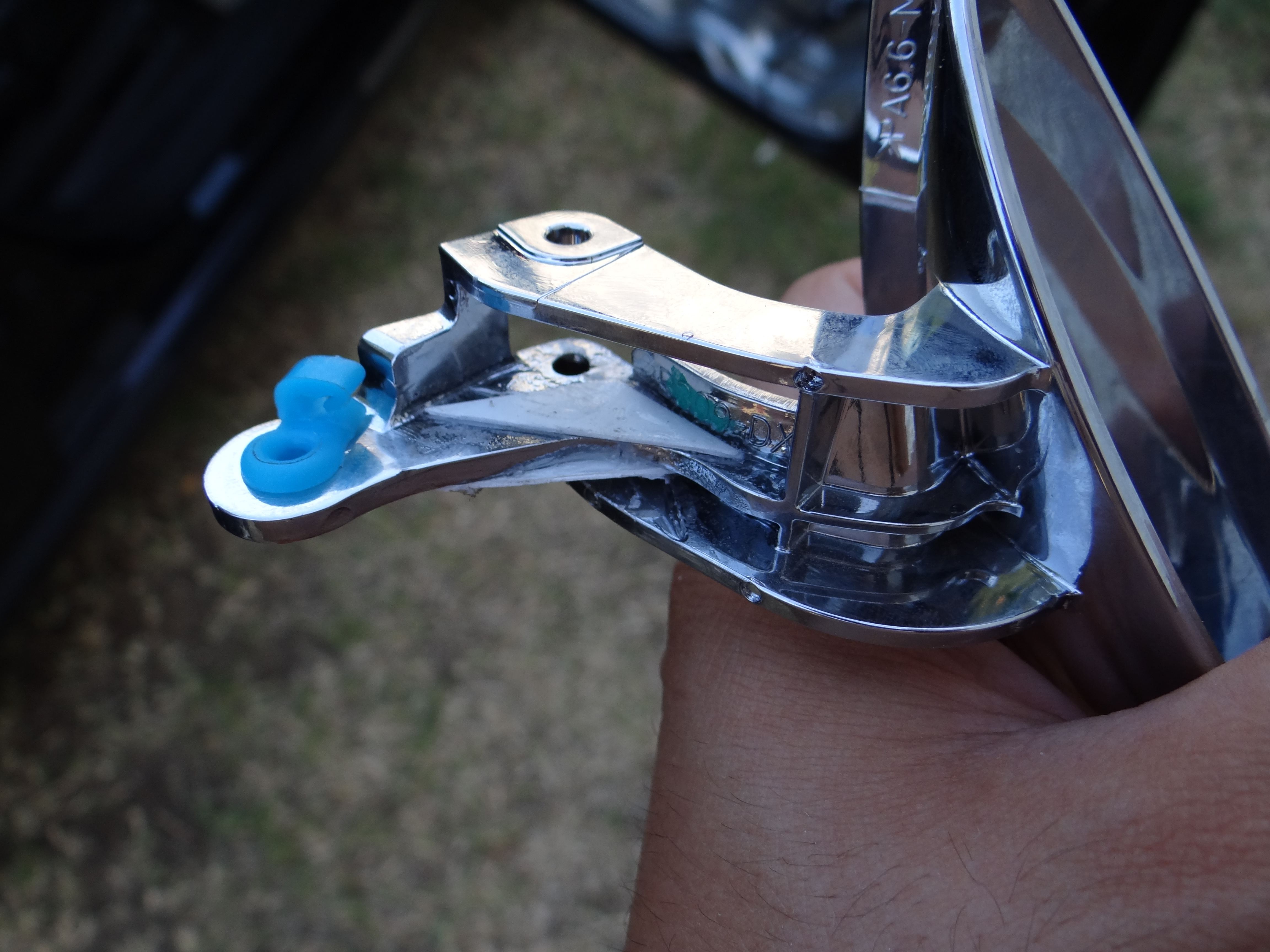

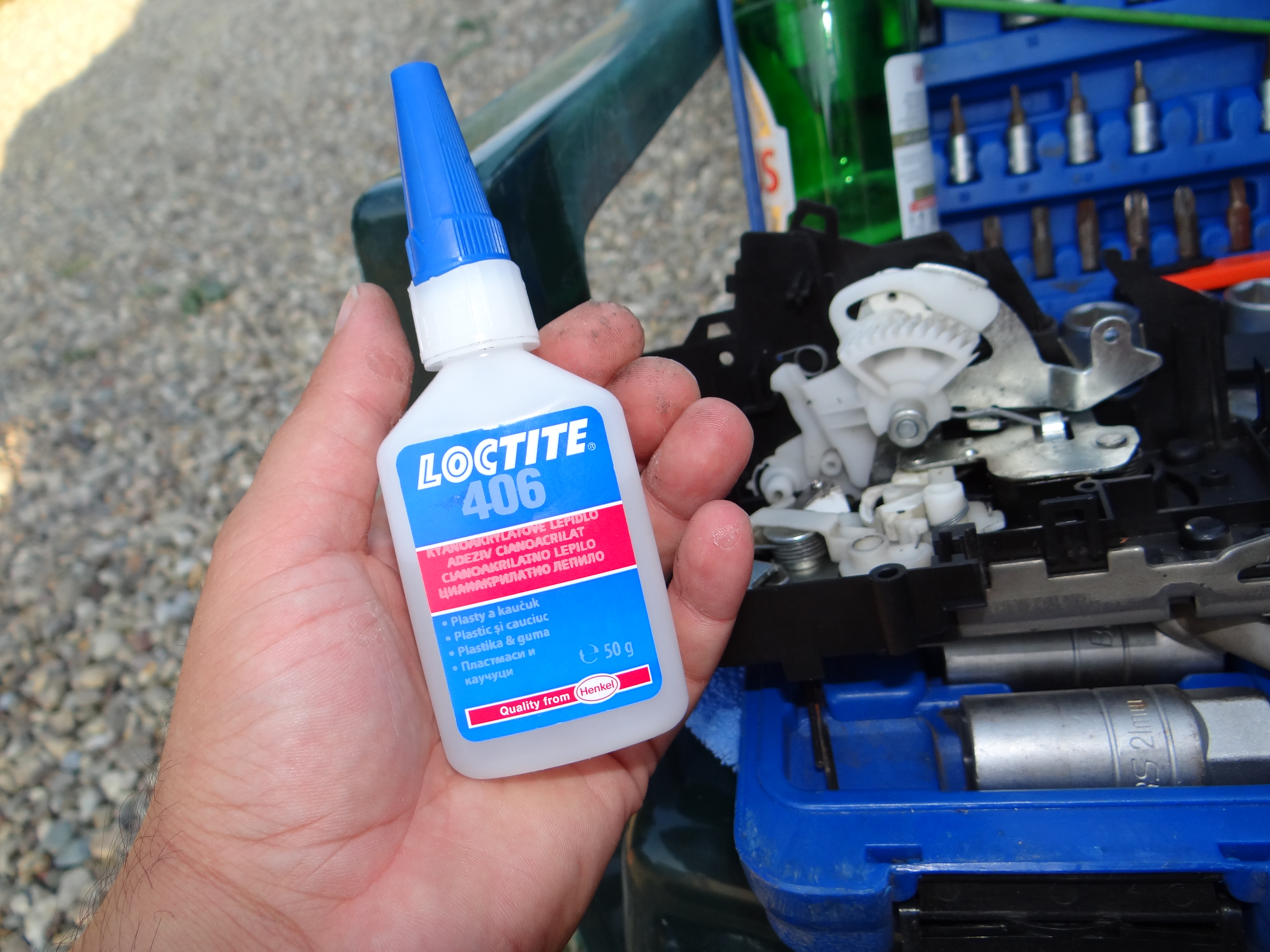

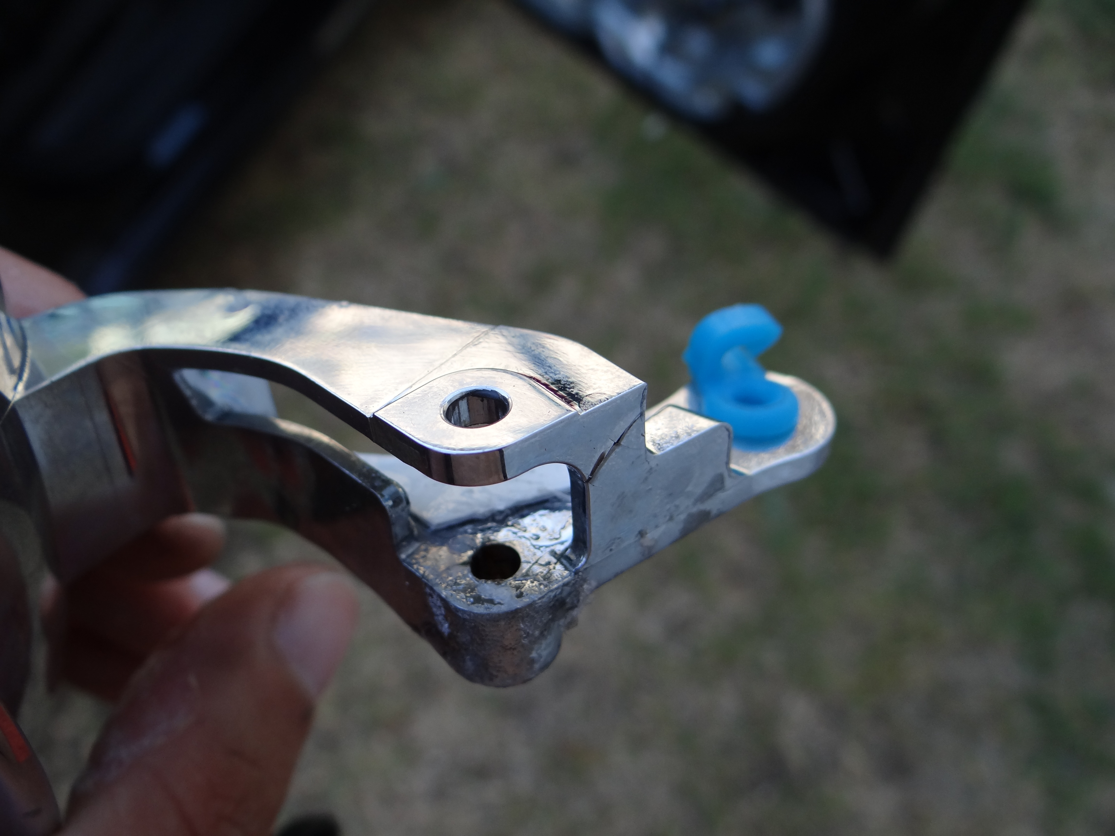

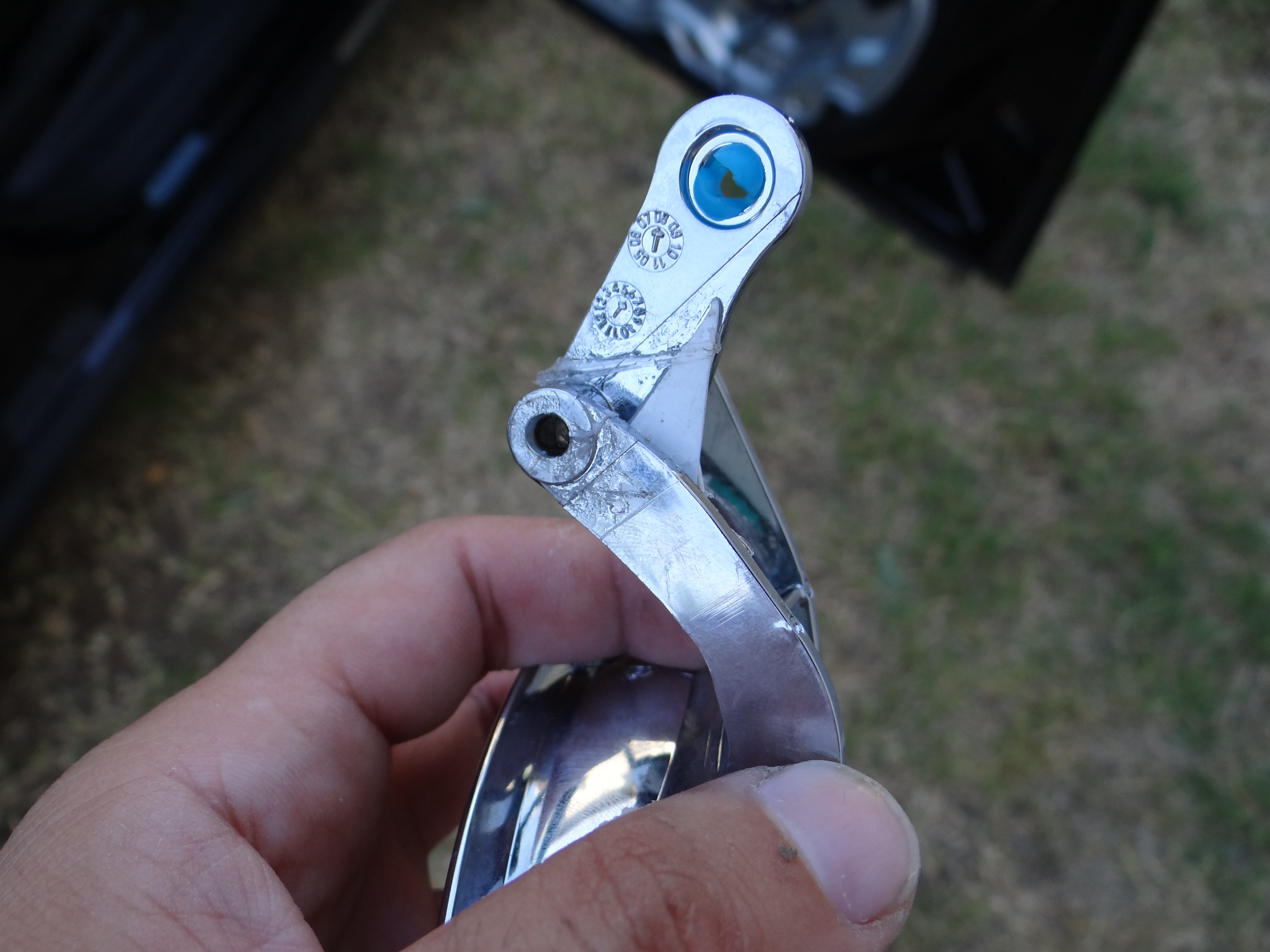

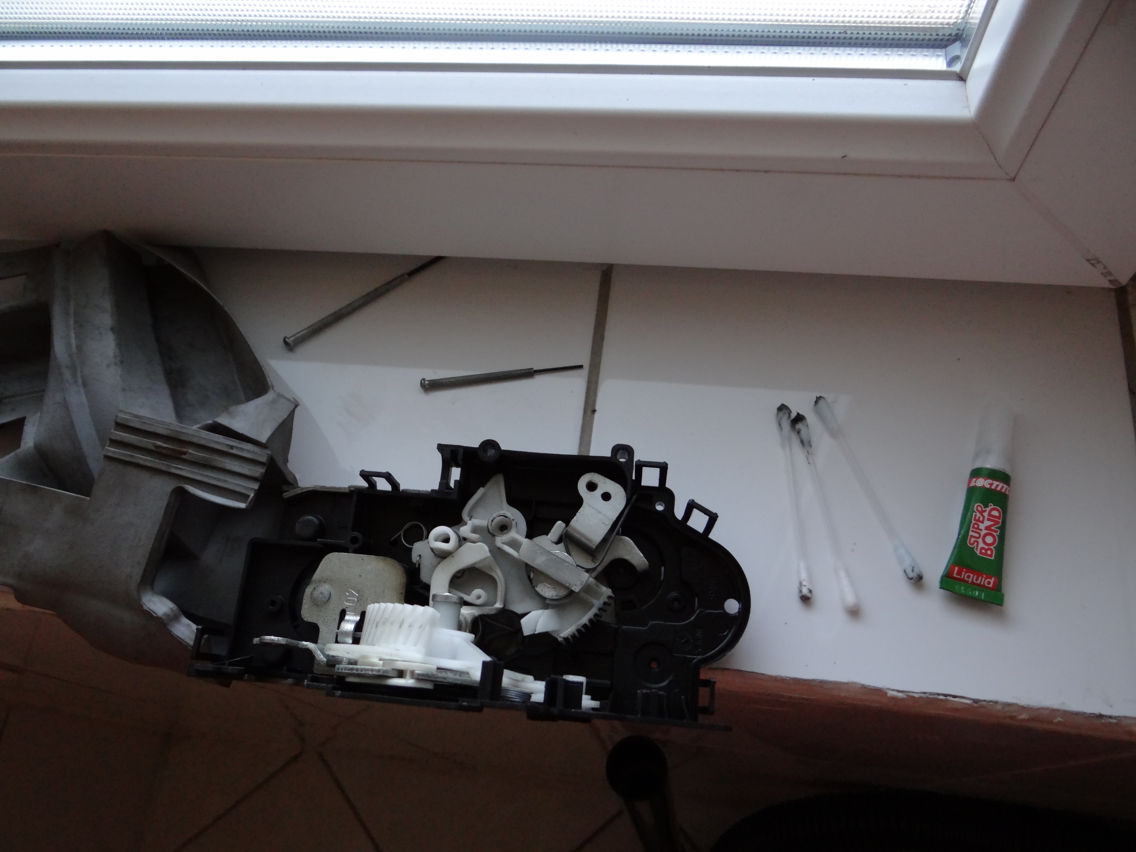

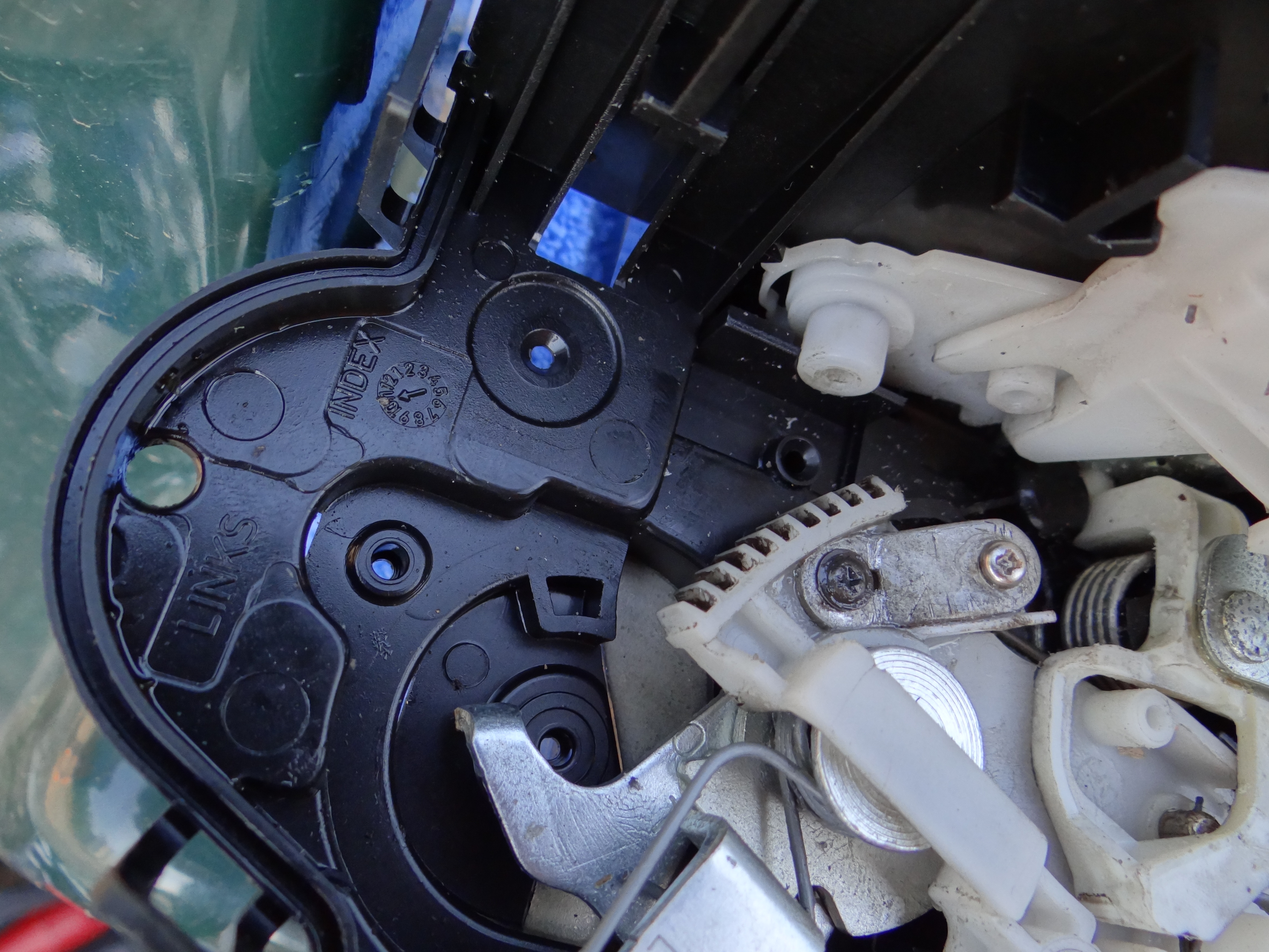

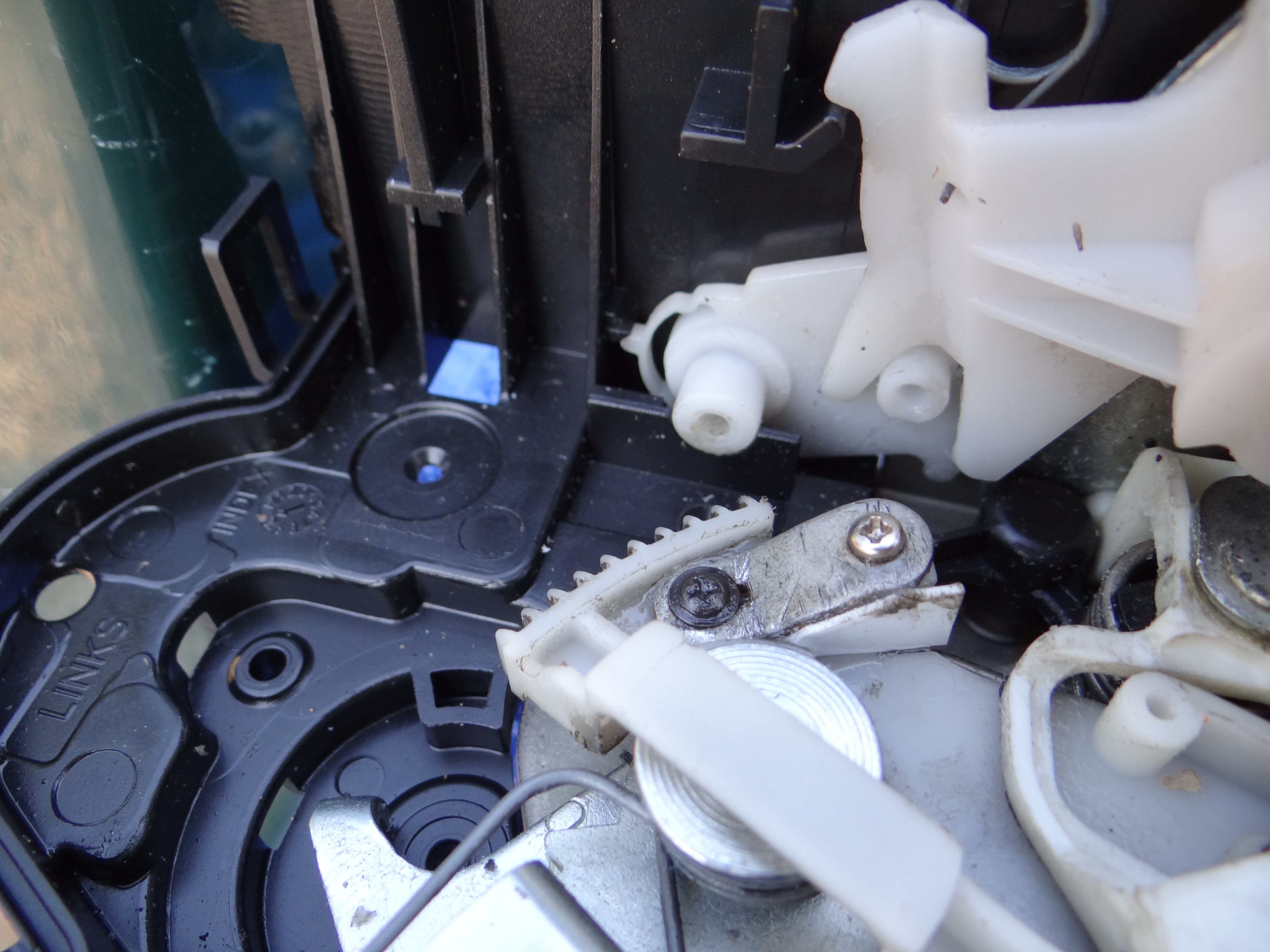

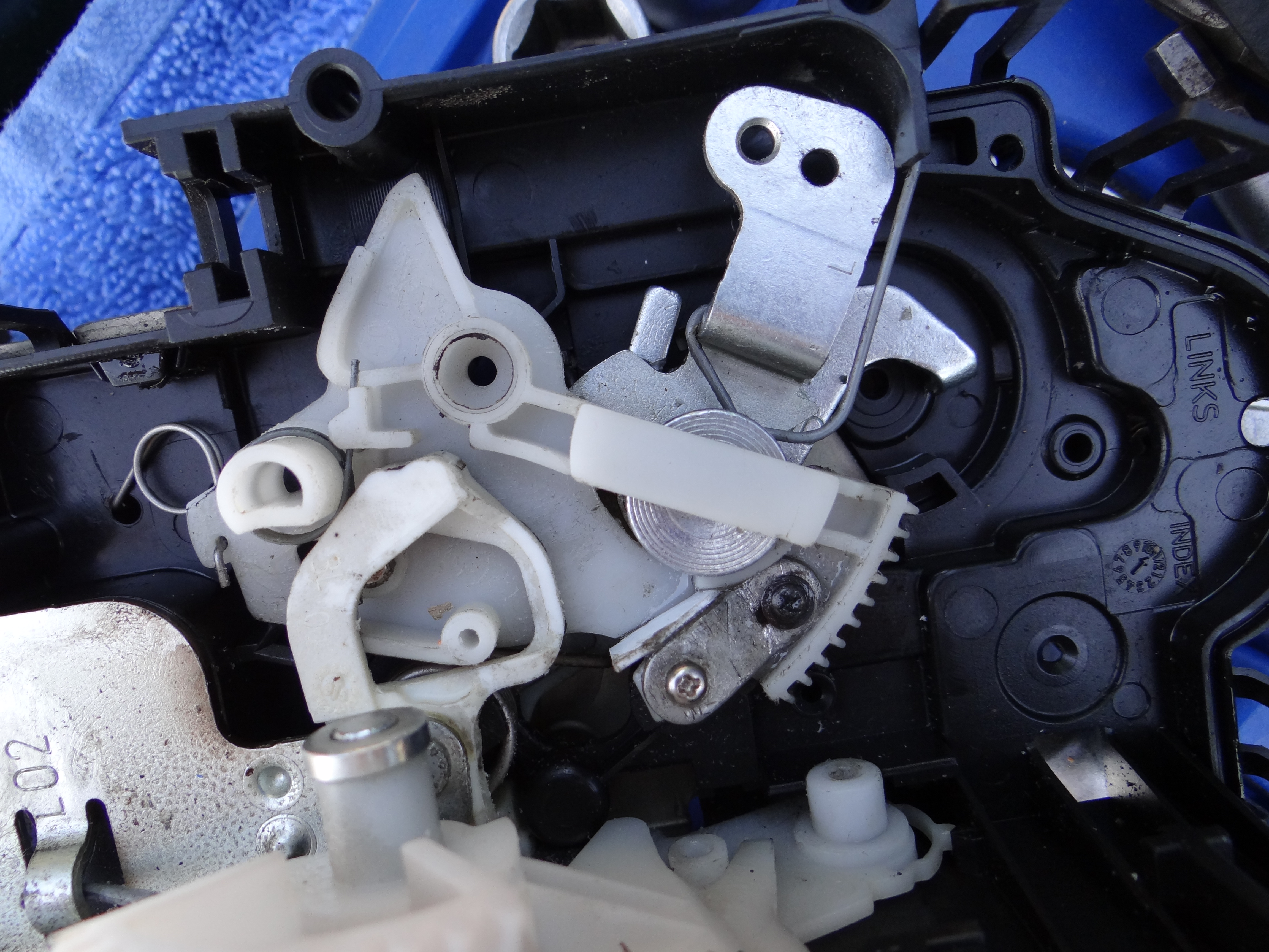

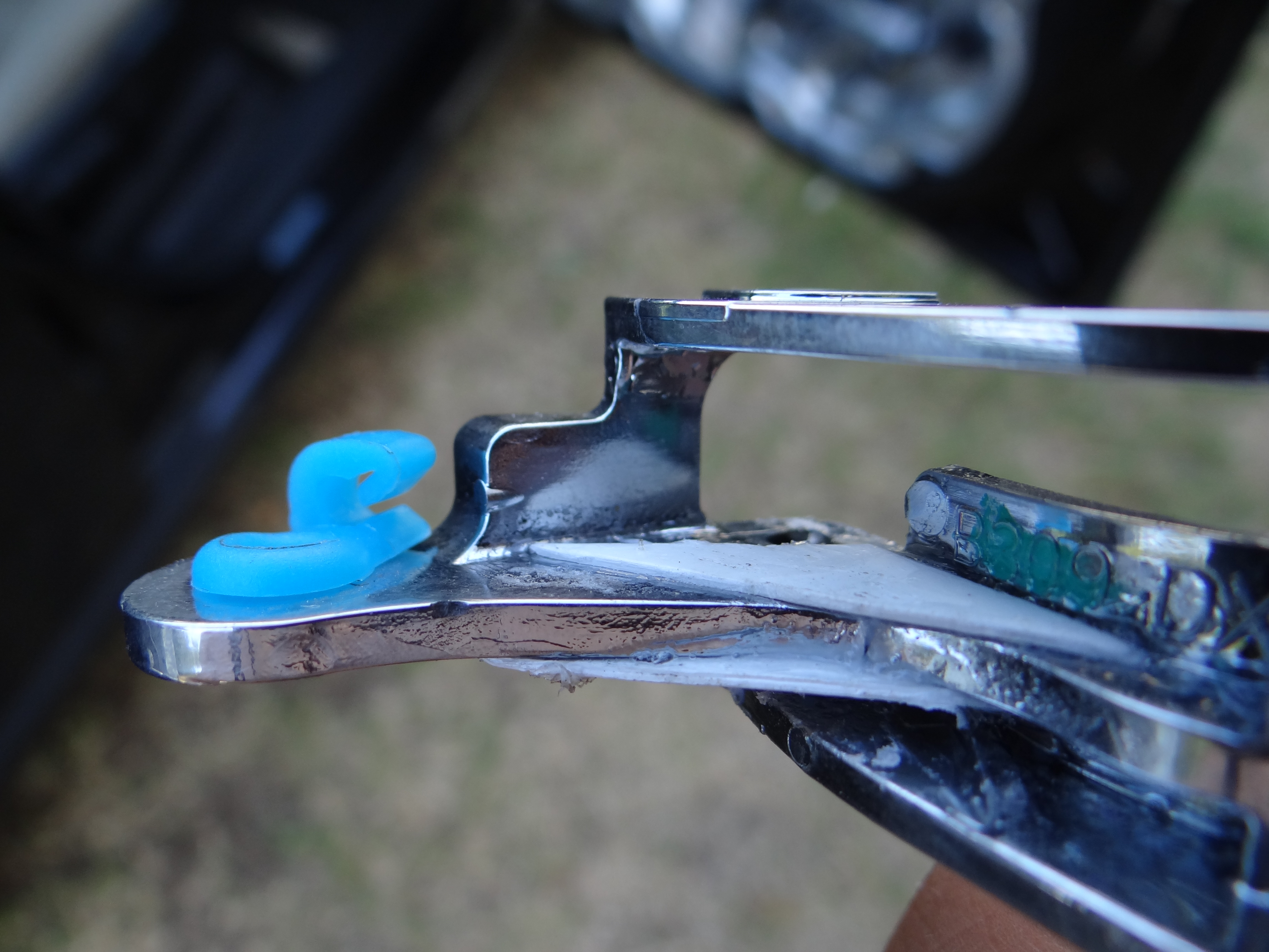

I had same problem at same door 11 months ago. Used some plastic from an expired bank card and some loctite glue as you can see in the pictures. 11 months since the repair and still working great. I had a problem also with a lock on the rear left door, which I solved it in the same way and its still working after a year. Below you have some pictures with the repairs. These are easy and lasting fixes if you like making the job and saving your money. The door handle maybe its not so expensive, but the door lock sure is. I enjoyed making the repairs, had to try until ordering a new components and was worth to try. I was thinking of making some DIY's and I will if others thinks this is helpful. Enjoy :)

Drivers side inner door handle broken. I tried the glue and bank card fix. It lasted two days until the bank card cracked along the original fault. Maybe I should have used one from a solvent account! My friendly dealer got me one for 35 euro. Hardly worth the trouble of attempting the repair. Another Croma learning curve!
Thanks Roberto, The glue was fine but the bank card gave up.
