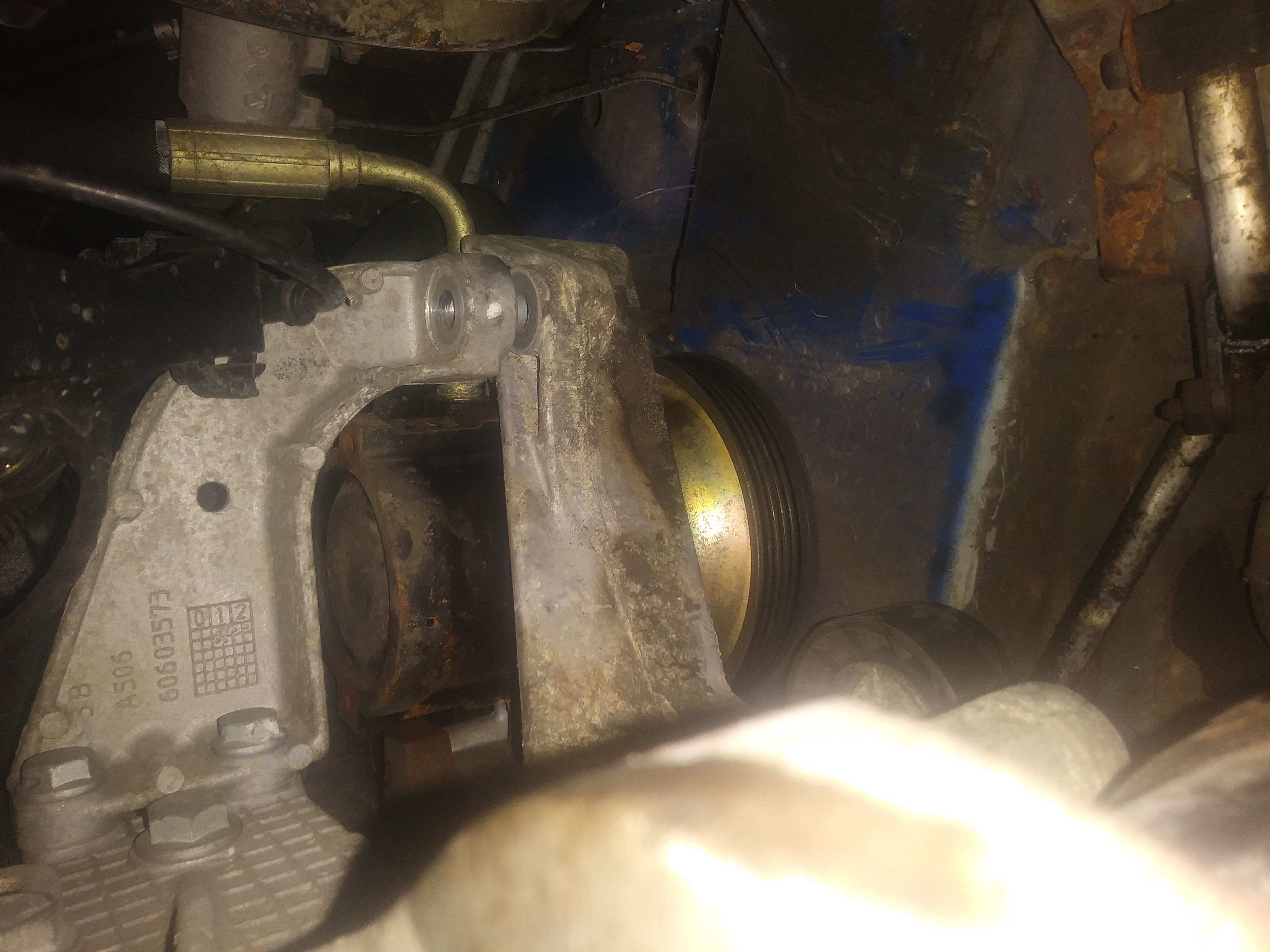

4) Undo the long bolt on the clevis of the lower engine mount and the 1 bolt and 1 nut securing the bracket to the transmission housing. It is then possible to remove said long bolt past the exhaust pipe.

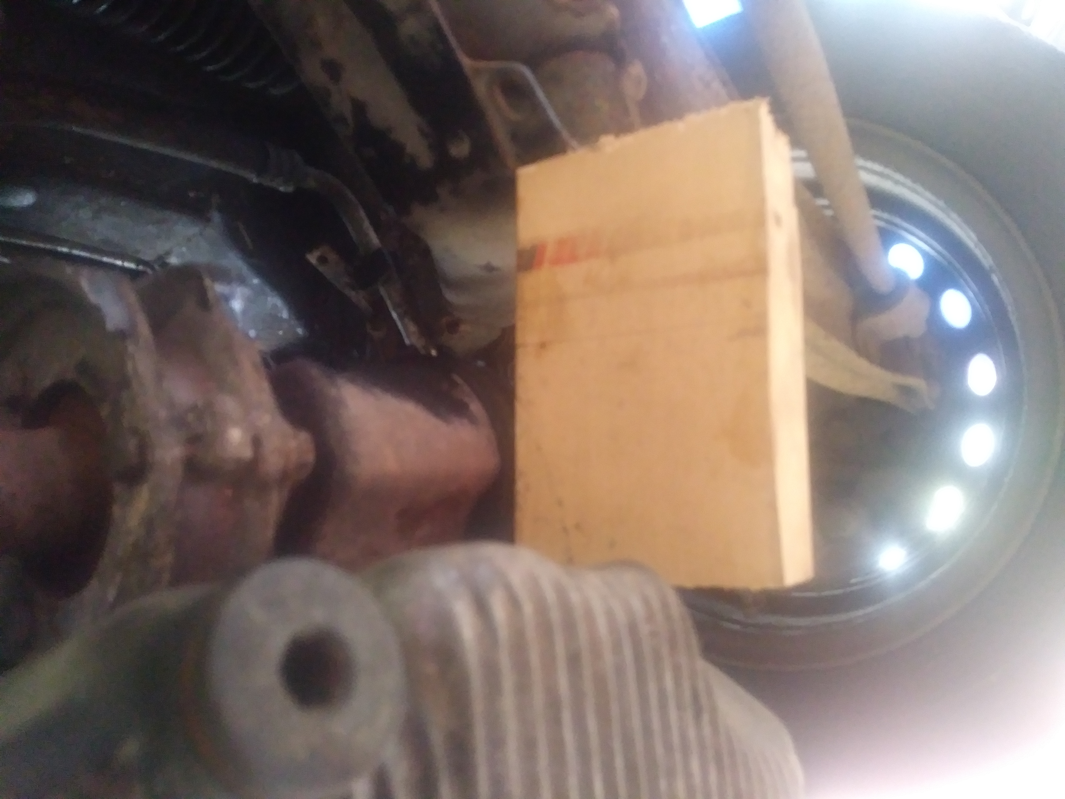

6) Get a suitable piece of wood, push the bottom of the engine as far forward as you possibly can, and wedge said piece of wood between engine and subframe.
7) You will now be able to see or feel the 2 bolts holding the alternator. They are done up ridiculously tight. Mind you, mine hadn't been touched for 20 years. With a ratchet and a length of pipe I cracked them off and then they undid quite easily.

10) Remove plastic bracket holding wires, 1 M8 bolt. Tie out of the way with a piece of baler twine :):).

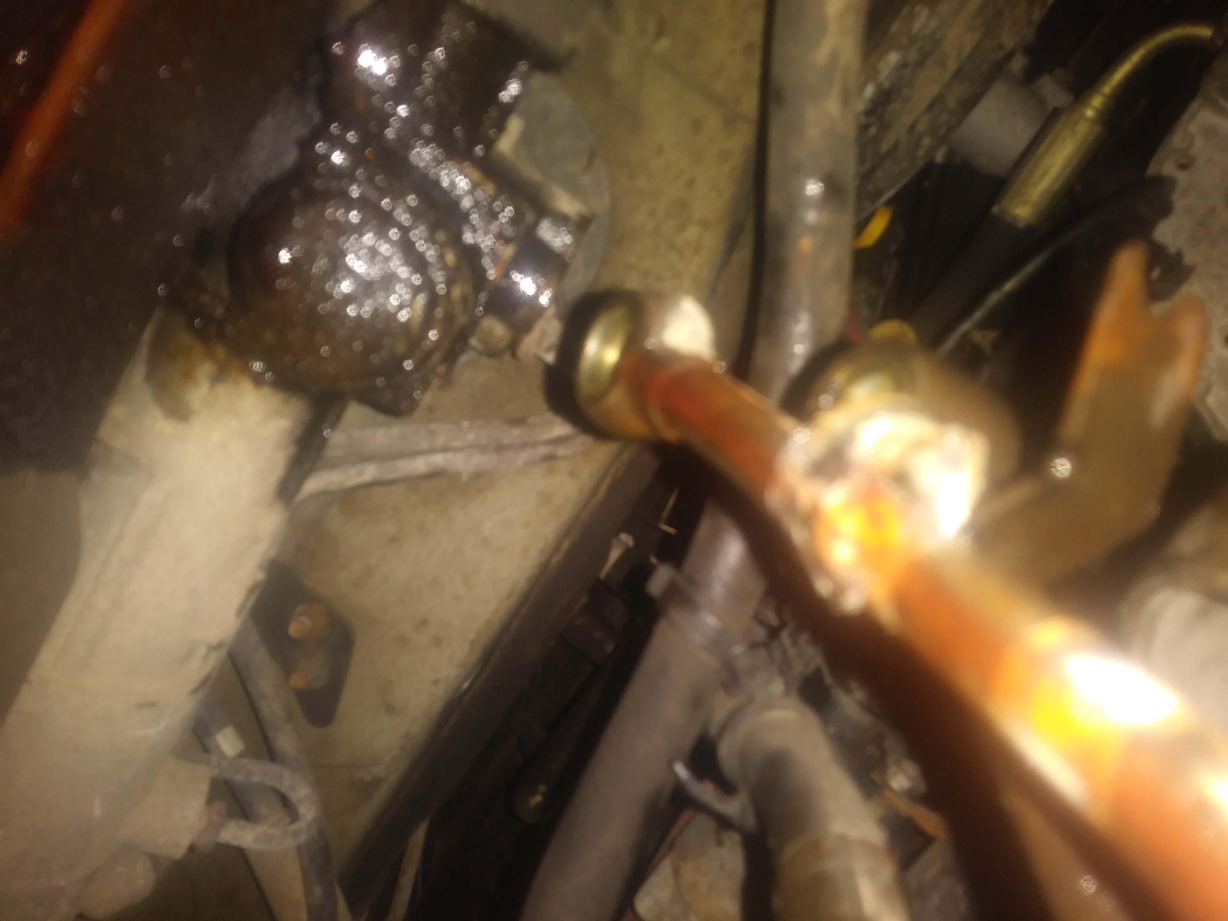

11) Get a suitable oil catching container and undo the 2 banjo bolts holding the power steering pipes to the rack. Tie up out of the way with a piece of baler twine:):).
12) Wiggle the alternator out.
