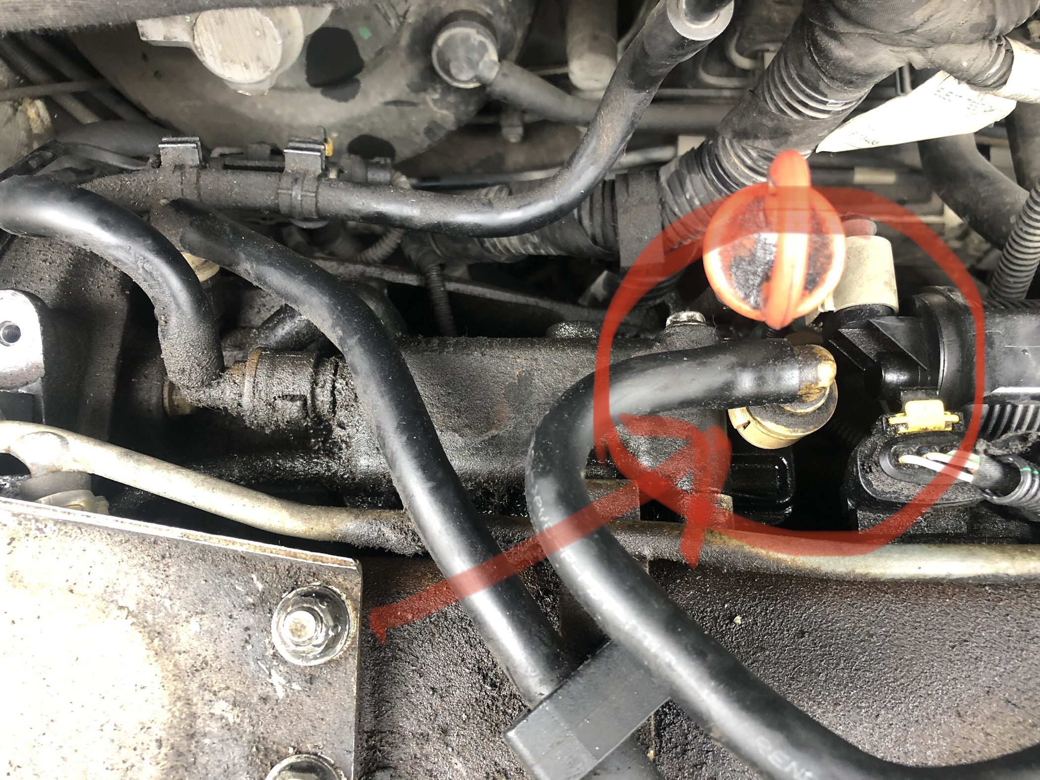

Think I’ve found the problem there a pipe leaking from/to the fuel filter but can’t decide weather the female pipe fitting is leaking or the plastic manifold? Male fitting is worn.
As it’s leaking I’m guessing air can get in. If I switch the ignition on and off a few times and let the pump run a bit each time it will fire up no problem
Anyone know the technical name for the plastic bit above the pump is?
As it’s Sunday will have a scoot around the internet to see if I can find a pipe and see if that stops the leak.
Cheers
Rich

Hi,
since i'm German i don't know the exact term but i searched on German ebay.
Could it be this one: https://www.ebay.de/itm/Kraftstoffschlauch-Rohr-fur-Fiat-Doblo-119-51743941-3/254160241324?fits=Model%3ADoblo|Make%3AFiat&hash=item3b2d2182ac:g:eek:n4AAOSwuhhc3Yf7?
Or, you dismount the part. Presumably you'll find a part number on it.
Another tip: I had a problem with negative pressure for the EGR in my gone VW Caddy. The tandem pump was ok, but the male nozzle had been worn out. The latter was not exchangeable, and i didn't want to pay about € 600 for a new pump.
I put some acrylic paste on the nozzle instead, put the plastic tube on, and fixed the latter by some binding wire.
It worked perfectly. OK, i harvested pairs of wide eyes from TÜV(MOT-equivalent)-checkers twice but the van passed the checks every time.

Was the pipe that went from the black plastic manifold above the pump, back to the filter. Old quick release connector no longer gripped the spigot above the pump and was spraying diesel all down the back of the engine and all under the top engine cover. Nothing is ever going to get rusty under there again. Starter was nightmare to remove when everything soaked in diesel.
