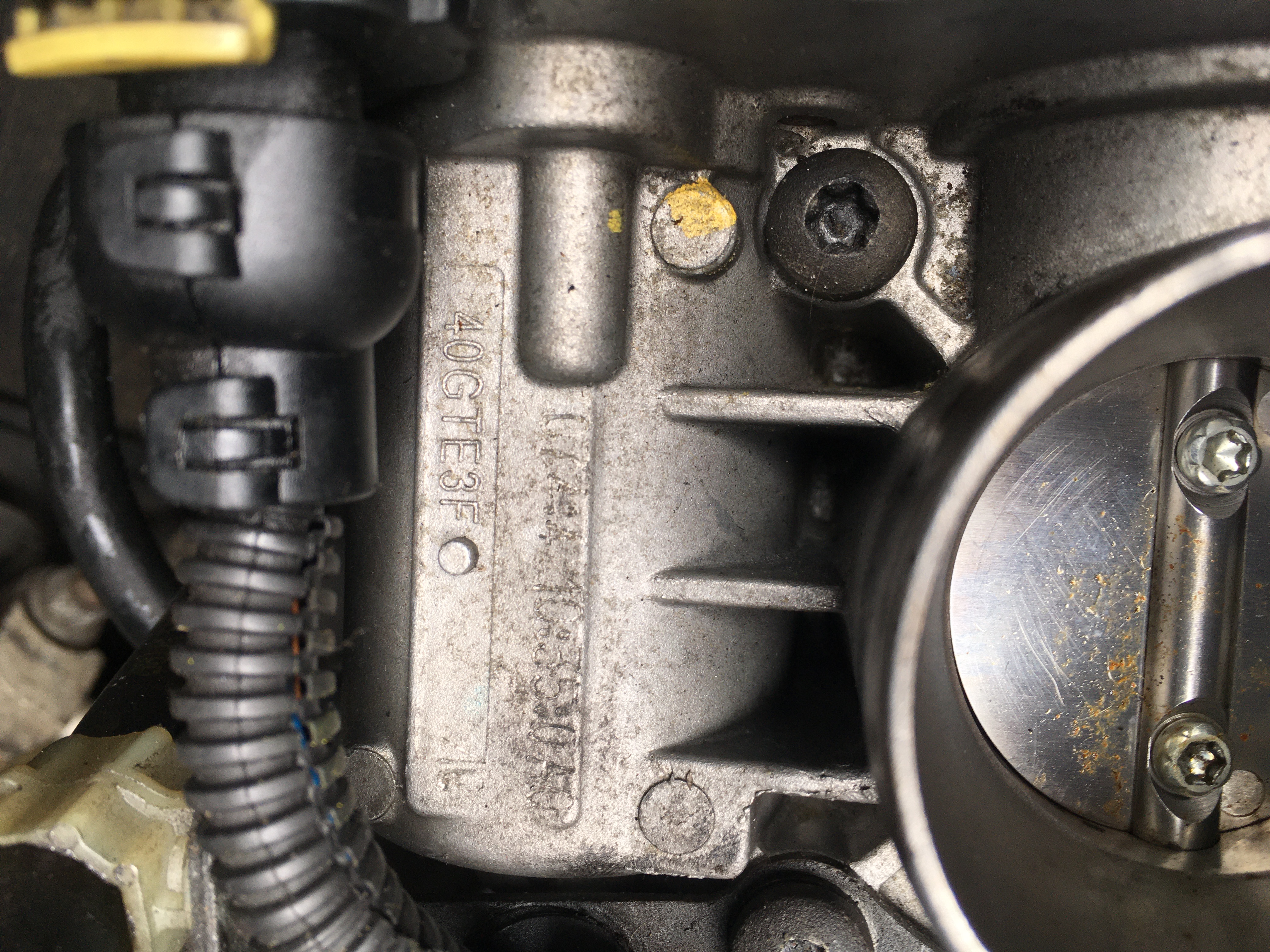

So I plugged in the details of my into a local breakers yard and they called to say they had the part (whoop!) went and picked it up for £35 went back to mechanic who compared the part to what was in the car and said it’s wrong and won’t fit. At this time I managed to snap a pic of the part and can see a serial number. Googling said serial number brings up loads of parts that look identical but says it for a fiat 500.
So, do you think I can risk it? The part number is 40GTE3F and from I can see fits the 500 as well as a Ford Ka. Does same number mean same part regardless of make/model?

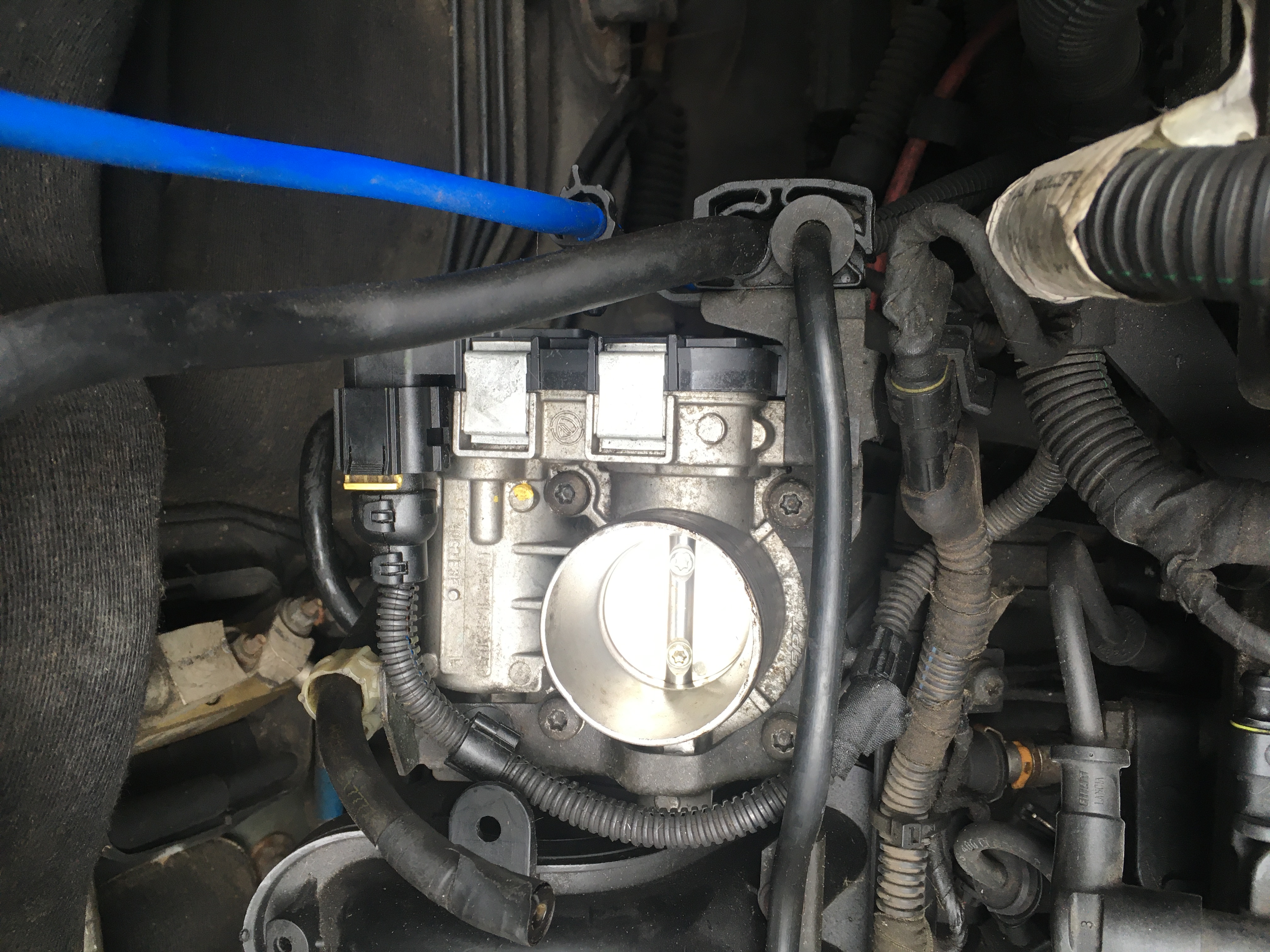

This is the throttle body in the car
Serial number

No part for a 1.2 is different to your 1.4
The number you can see in photo looks like a casting number to be not a part number.
Grande punto 2005 to 2015 1.4 78hp
Uses same throttle body
