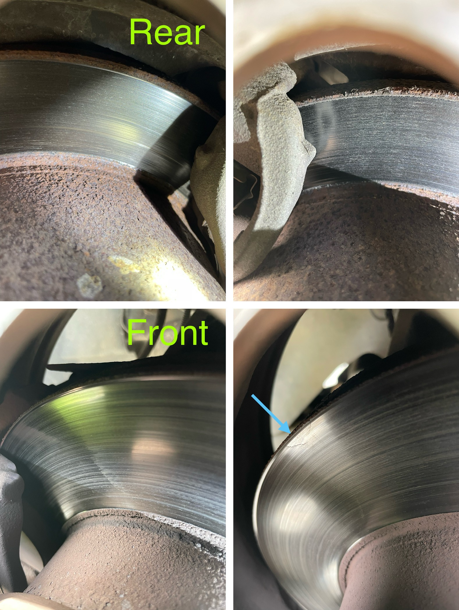

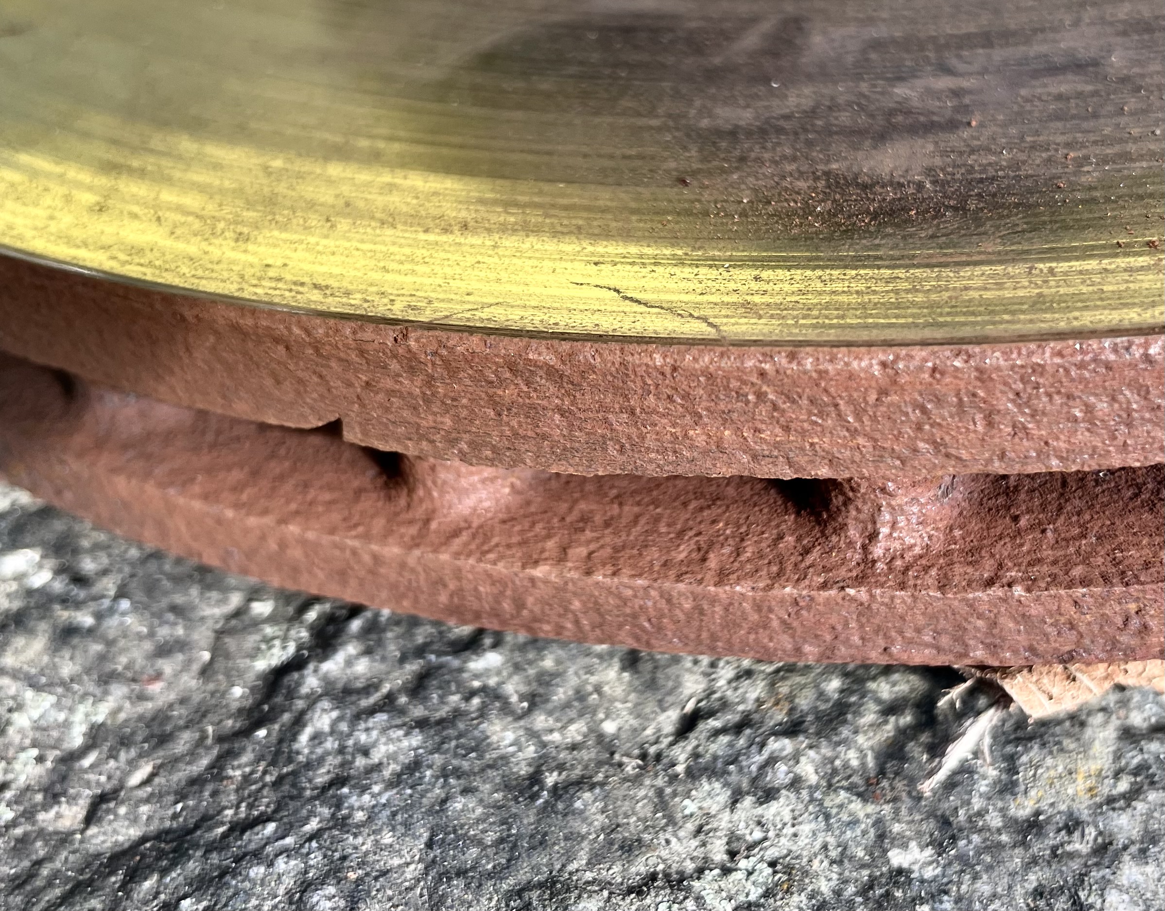

I noticed a crack in the rim of one of my front discs (see arrow). Is it a 'don't drive until it's fixed' kind of situation, or can it wait a few hundred kilometers?
Overall the discs show some wear and have 1mm of lip at the front, 1.8mm at the back. Would you replace all four of them now?
The discs look good, but that cracked front one is done as far as Im concerned. Its been hit or dropped at some point or has a manufacturing defect and that small piece could easily be detached adn cause a brake failure. I would say you must bite the bullet urgently even though they otherwise look on great condition

Definitely replace asap (and replace both sides just cos it's on the steering end of the car)

For starters, it's a very unusual looking failure. Don't think I've ever seem one quite like it before. If just that bit were to detach itself Then it would present a "cutting edge" to the pad which is likely to cut away that outer part of the pad meaning the effective braking area will be reduced so it may pull to one side. I doubt if you'd get a total failure unless other bits start cracking off. However, if it was mine, I'd be very unhappy with it and would be changing it asap. I'd probably risk using it for an emergency if the distance to be covered was short but certainly wouldn't be setting off on one of our Devon sojourns, and, as Panda Nut mentions above, it's a whole different ball game if it's a manufacturing defect as other cracks might manifest themselves. I agree also that both discs should be changed - and pads - to keep the braking performance equal on both sides (I suspect we're teaching you "how to suck eggs" by mentioning that, but others may not be aware.)
Thanks for chiming in. So the consensus is replace both front ASAP, leave the rear alone for now.
I don't know how long it's had this crack -- I have no records of a front disc or pad change and I've had the van for 40,000 km out of its 190,000. I've asked mechanics to check the brakes at each service but who knows if they were thorough.
Planning to go with a brembo set. Compared to the small car on which I got my license, the brakes never felt very strong, to the point where I've developed a reflex of downshifting for urgent braking, otherwise it doesn't feel like it's quite going to make it. They did check the braking force for its MOT though and found it sufficient. Wondering if this will improve after changing the discs and pads.
I'm puzzling over what might have caused the cracked bit on that disc and it's not obvious at all. Assuming it's not a defect? I'm wondering if it's been caused by injudicious use of a hammer? It's quite common practice to remove crusty rust deposits from the outside rim of discs by either scraping with a screwdriver or chisel, or using a hammer to dislodge heavier build up - done it myself often to stop rubbing noises. If the hammer had been used too "enthusiastically" then that might account for this damage?
Although the discs are wearing quite evenly, this is good because it would tend to show there's no problems with callipers seizing or other problems, they do show quite defined wear - look at the edge between the rusty hub area and the polished surface of the disc, there's quite a visible "step". Also quite heavy corrosion of the hub and outside edges of the disc. They're well past their best and, once the new pads have bedded in, I'd expect you to see the new brakes giving you a better experience. Do you have a good "hard" feeling brake pedal when you push down on it? I'm just wondering if the system might benefit from being bled while you're working on it? - Maybe renewing the fluid at the same time?
