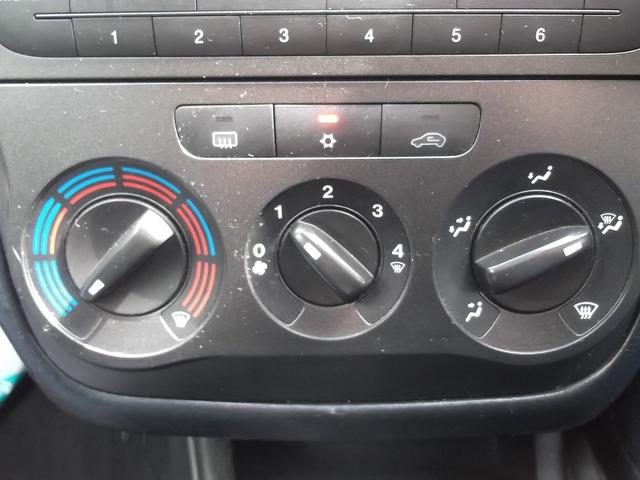

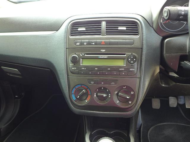

I have recently purchased an 08 fiat grande punto active. I have the snow flake button and air distributor button but neither work. When I spoke to the dealer he advised that the cat does not have these functions. Does anyone know if these come as standard, and how I can check if I do in fact have AC or if these are dummy buttons.

if you have the snowflake button between the heated rear screen and the air recirculate button you should have air conditioning......

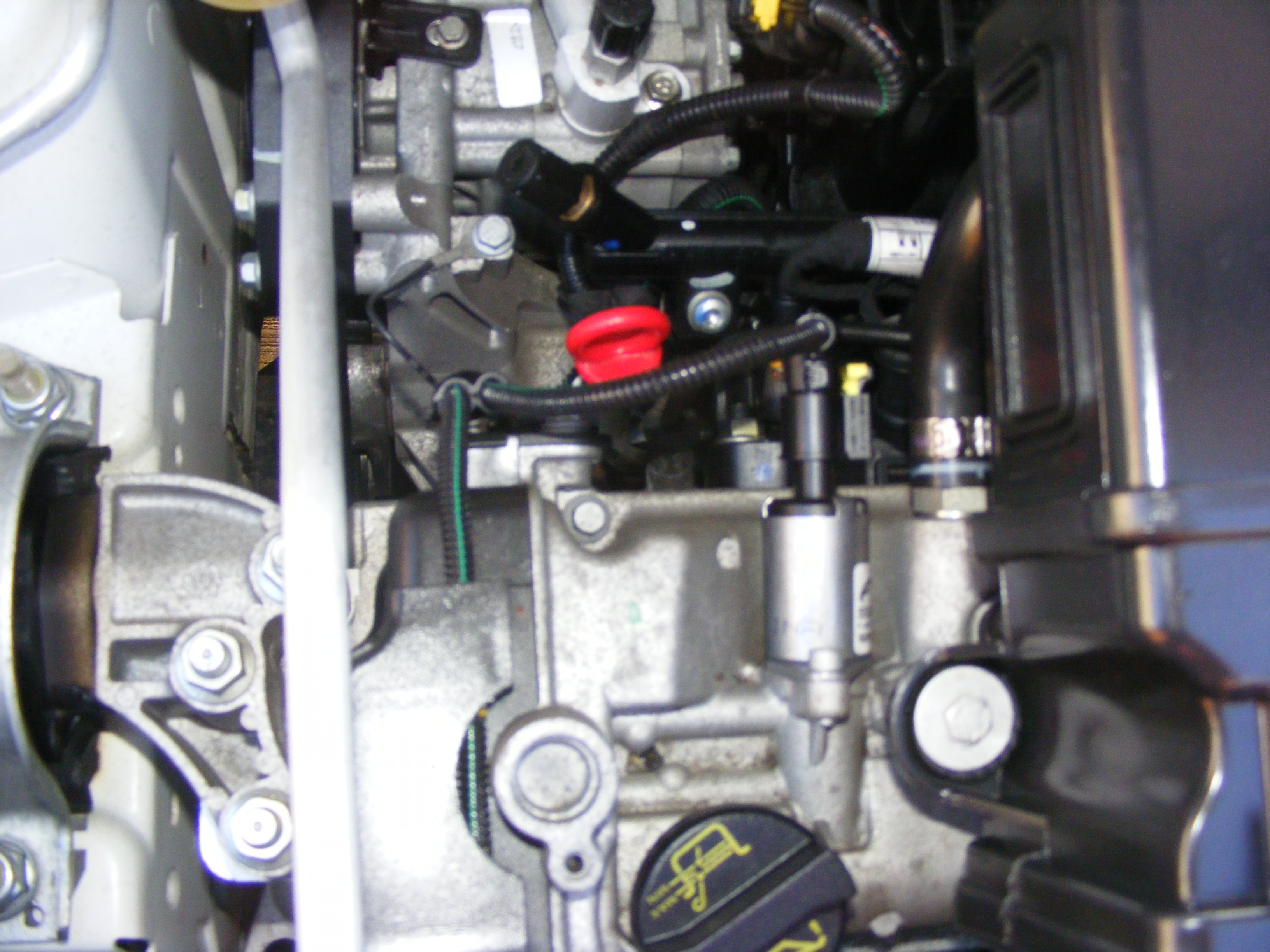

the cars wit AC have extra bit in the engine bay... if you let us know what engine you have i'll try and find a pic of a car with and without so you can compare....
this is a 1.2 without ac

If you have a snowflake button, you should have aircon. Without aircon button is either not there, or a dummy, with no logo.

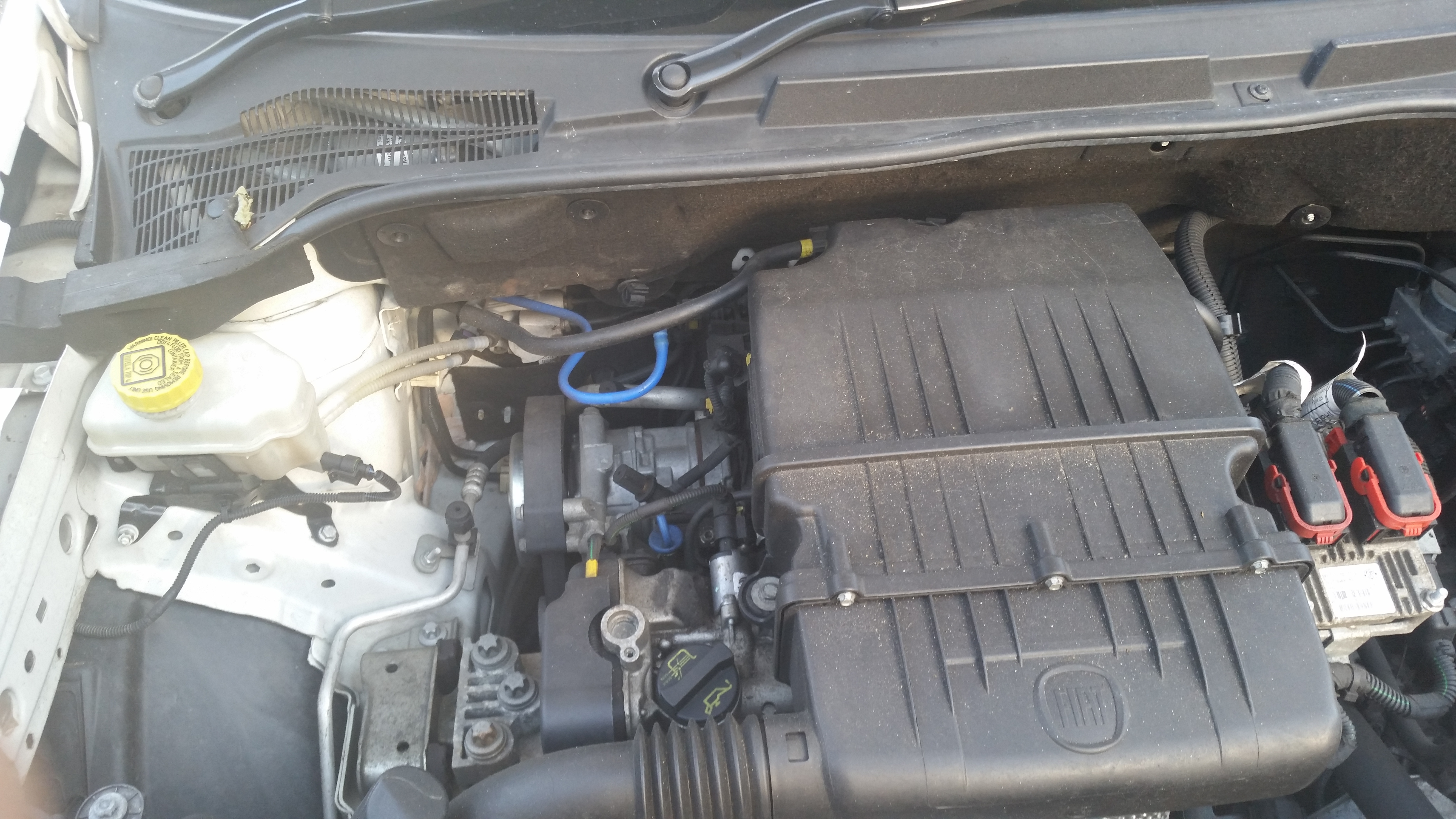

If the button isn't illuminating when pressed it might simply be that the wiring plug has worked loose from the back of the switch. Out of gas or not, the button should still light up. You can remove the small trim panels from the leading edge of the footwells (one screw each IIRC) and peep in.
You definitely have aircon. Therefore they should make it work. You don't need to fix anything.
On the pic you posted, under the blue curved pipe is a grey lump driven by the auxiliary belt. That is the aircon pump.
To its left is a grey pipe with a black valve on it. That is one of the aircon pipes and the valve is for access to the gas. Don't touch yourself, needs a specialist and connection to the proper equipment to extract old gas and replace with new.
