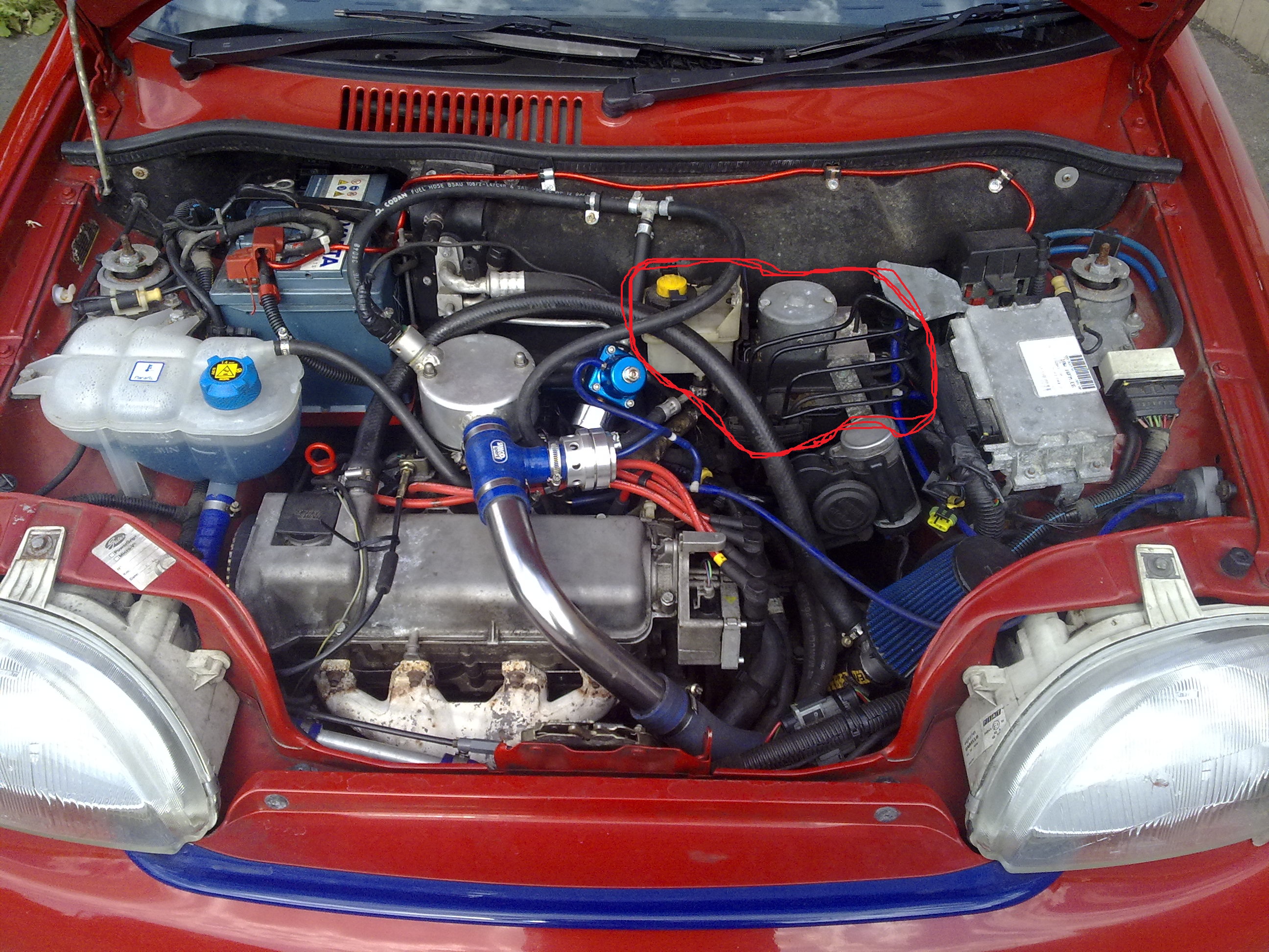

ignoring all the random turbo and non stock bits in my bay, see the abs pump and fluid reservoir circled in the attached pic, if you have that you have abs, if not you don't.
