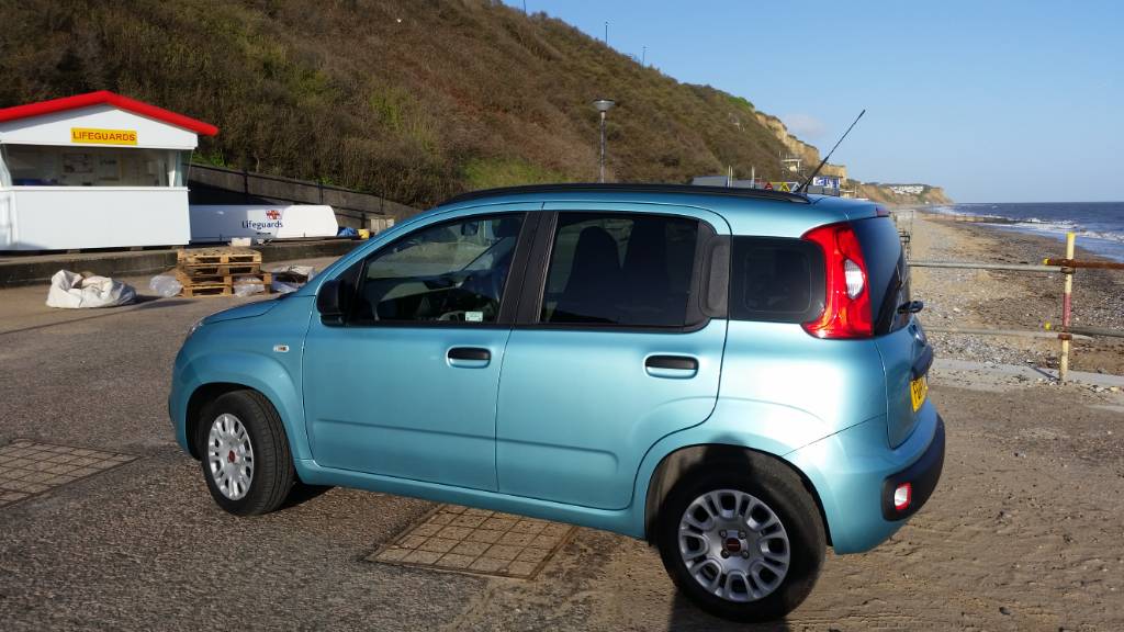

I had my panda done in norwich cost £200 4 years ago, glass taken out on rear window, pro job, looks fab with a lifetime gaurantee, they want £100 to do my abarth and have a waiting list of over a month, not cheap but after 4 years still looks like new. 20160419_074414.jpeg
