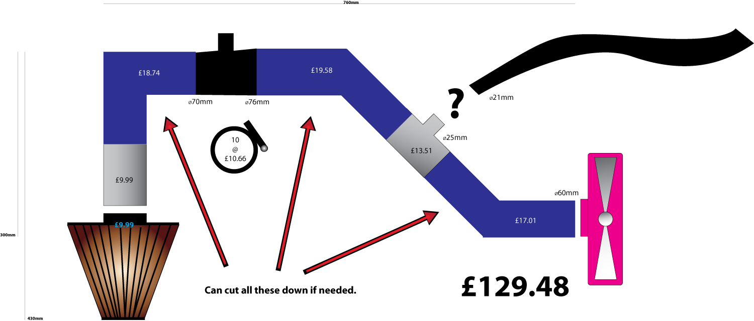

OK so thanks to Adam (adamcot) who's lent me his standard airbox gear. I've now got the measurements and have ordered the parts I need.
Diagram below for anyone else who may like to try, including sizes parts and prices.
Parts from Auto Performance Silicone Hoses
http://www.auto-performance.co.uk/ - Silver is Alloy, Blue is Silicone, Black is a standard part of the system and I have a lovely pink turbo.

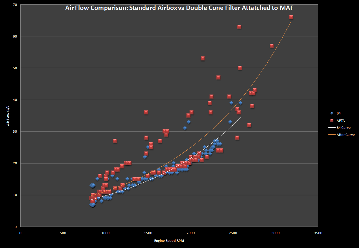

Filter arrived today ahead of the rest of the bits (Love Royal Mail Muchly) sadly it was silver not gold, so me being me popped it onto the MAF but not before taking some before airmass readings.
Sounds totally amazing if a little loud (Linz hates the sound) but hopefully that will quieten when the pipework arrives and I can redirect the filter into some nice cold air down in the bumper.
Graph shows a significant increase with the cone onto the MAF and that on average there is almost a 13% increase in airflow.
Some of the After data points are all over the place as I think i became a little lead footed due to the sound, but all of the outliers are filtered out of the final stats below.
Sorry for being all scientifical but if I'm doing it then I'm proving its worthwhile.
