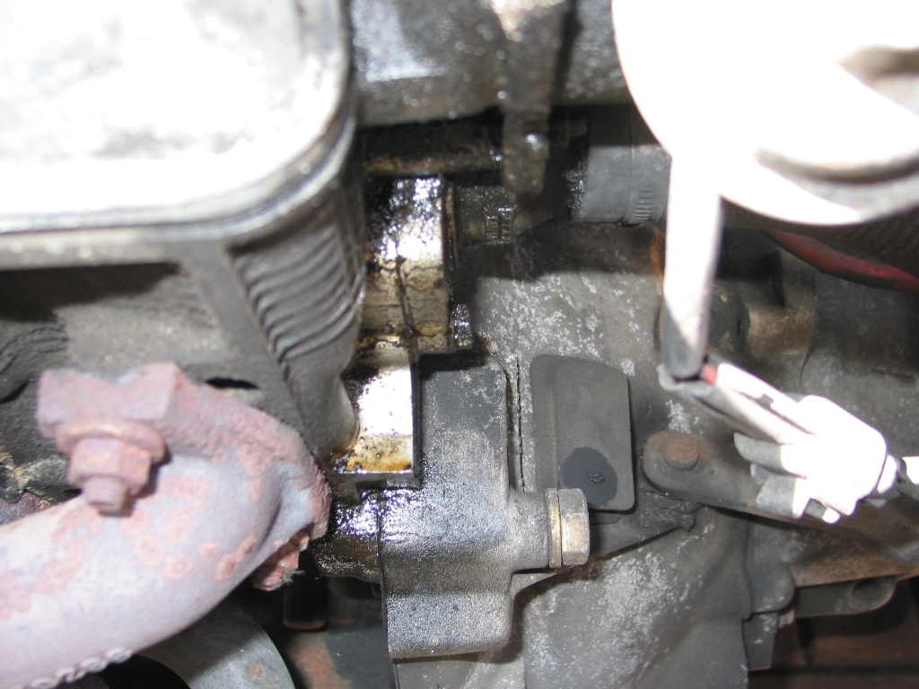

OK I think its better to remove the distributor completely and take the opportunity to check vacuum advance. Steps E and F ore optional, but good practice.
First of all, allow a good afternoon for the job – You don’t want to rush to finish as things easily go wrong. Start early if your working outdoors - you don’t want to run out of light. – then again – I took loads of pictures :)
This is exactly how I would do It,

H. Don’t let oil drip onto the coolant pipe below – if it does – clean it off. I moved the rags for this picture BTW.
If there is no oil leek – this could mean the cam is running dry, perhaps due to a blocked oil pipe, which will need further investigation. It’s a separate job, which doesn’t need distributor off, and will need at least a cam cover gasket at least.
H. Cleans the old o-ring gasket off face 1-2. I used WD40, sprayed onto a rag to avoid getting any inside the cam. – If there are any stubborn bits I’d say don’t scrape off with anything metal as scratching this face will affect the future seal. If any bits fall inside the cam hole, fish them out, as they won’t do any good in there.

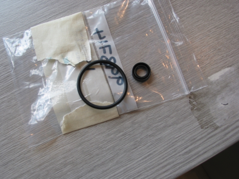

Attached photo shows what I bought back from Fiat parts.
The larger, correct ring gasket, was the cheaper one. Really glad you told me about the correct part number Louie, otherwise I'd have had to wait another week + more trips.
The smaller one was the more expensive £4 thing! Looks like it could be the inner distributor gasket seal? It has a small spring like piece within its rubber groove.
If this smaller one is the inner gasket, then it can be bought in the UK - good to know if you need it.
