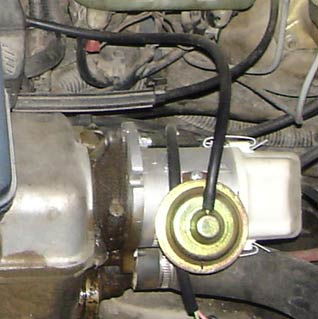

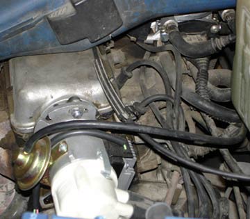

i thought it would be usefull to tell you a story about the distributor replacement in a Fiat 1108 ie engine, since i replaced it before 1 month and had some strange problems.
For the last 3-4 years i knew that the distributor centrifugal weight springs had problems and the ignition advance wasn't correct in all rev range. I tried to change only the springs and i thought it was fixed. But... the problems appeared again :(
So, i decided to replace the whole distributor with a new one. After searching the market they told me that there is one for the 1.1 ie engine. It was a Marelli ditributor with cost about 130 Euros. I bought it and the replacement was easy with instructions from Haynes manual. Then i went to a local fiat garage and asked them to set the correct ignition advance because i don't have an ignition strobo instrument.
But, they couldn't set the correct advance because if they set it at the correct advance degrees (13-16 BTDC) the engine idle revs were at 1000 - 1200 rpms instead 800-900 that is the correct idle revs. So they decided to set the advance at lower degrees and the car wasn't going well as in the past.
I started searching and i found that the distributor model was Marelli SE101AB but the model that the 1.1ie engine uses is the Marelli SE101C. I asked about this model and they told me that Marelli produces now only SE101AB now and SE101C has stopped. I also found that that the SE101AB is for the 1000cc engine.
I was lucky i had a fiat mechanic friend and he told me to keep the SE101AB distributor and change the vacuum advance diaphragm with one for the 1108 engine because it has a longer plastic driver, then the one that came with the SE101AB distributor, and a little harder diaphragm.
I did it and it was possible to set the correct ignition advance with no problems.

Excellent post Geom esp with your use of pics.
The distributor/vacum system on Unos seems to be a common problem.
I had a similar problem with my 1108cc engine and luckily ended up with a distributor and vacum advance from an abandoned wreck for free which done the trick

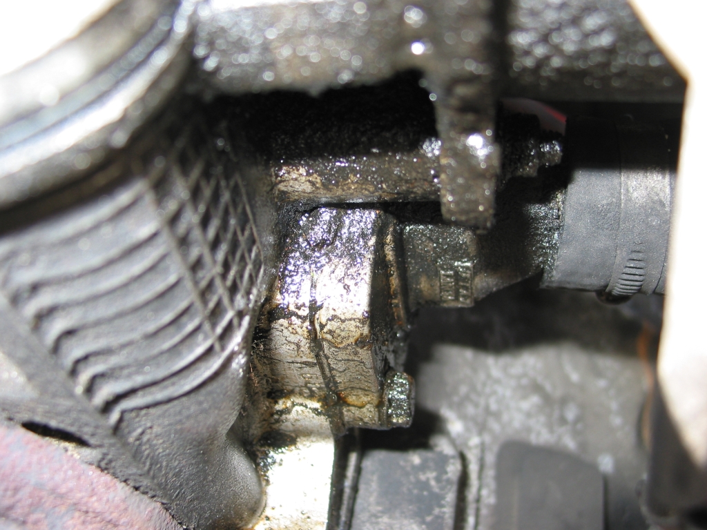

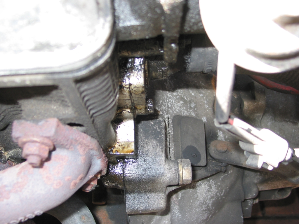

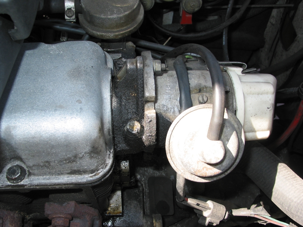

Alex, I know :) but I don't get clutch judder or anything like that, just a dirty engine bay really.
Thing is, my distributor cap isn't filling with oil at all. It's been off/on twice since I've had the car (about 7k miles now). I think it might be the O-ring gasket. I've tried to figure out your description by looking at my engine bay and the haynes manual. What's the worst that can happen? Is it possible to actually mess anything up etc.? Do remember I'm no mechanic as such and the car does run fine, so to break the car would cost quite much to get my mechanic to fix (on the distributor part alone).
Louie - there are no 'symptoms'! The car runs fine like it has always done. The leak makes the engine bay look really dirty, and is if there is something wrong with the engine. The cam/rocker cover gasket has already been changed before.
I've attached photos. Maybe from that it's more obvious?

ts86, that was exactly the same problem i had at the exact location. I think it's not a problem except the dirty engine.
ts86 and Louie,
Well good news then - thanks for the updates, so it looks like just the O-ring to replace ;)
Sorry for my misjudgement...
I think the diagnosis thus goes "oil inside cap: shaft seal", and "oil leaking from distributor: O-ring". The ones I've seen have had oil inside the cap - but obviously, that's not always going to be the case!

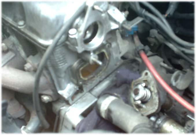

A picture from last time my distributor was out – also the thermostat is removed, as I was about to replace it.
When the 2 10MM Nuts are off, a gentle twist distributor and it will come out. There should be a small oil leak from the new hole, so have a rag ready. If no oil leak, the cam’s oil pipe may be blocked, and no oil is being fed into the upper section of the engine – Luke can tell you more about this – and what happens next :p.
Replace the O ring, Give the distributor a polish (optional), twist the rotor arm to the same angle, Marry up with the cam – maybe a little bit of twisting involved – the rotor arm may fit 180 degrees out, I’ve heard the engine will work OK if out of phase. Align the marks you made earlier and tighten (not too much) Hey presto – 1 less Oil leak LOL.

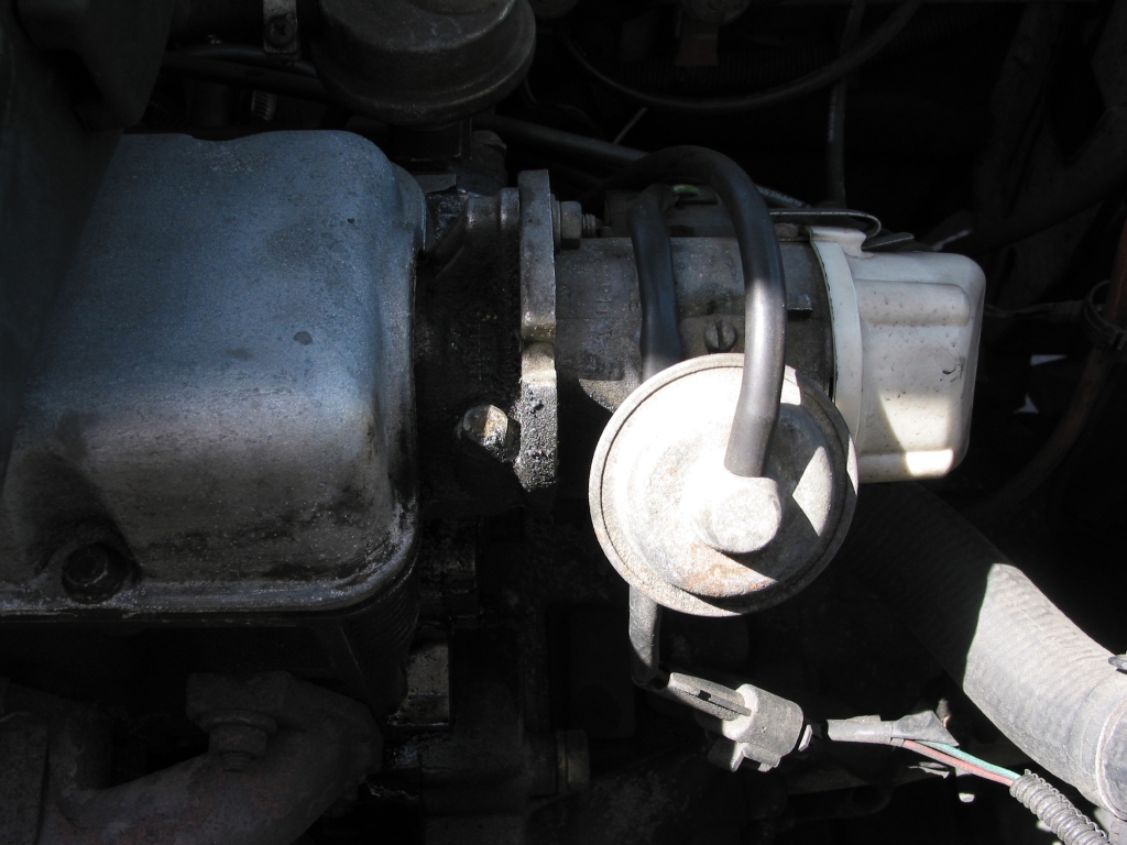

Key
1 – cam Cover
2 – Cylinder head to distributor join
3 – Distributor
4 – distributor cap
5 – distributor cap retention clip (lower one not in view)
6 – vacuum advance diaphragm
7 – vacuum advance pipe
8 – distributor electrical connector block
9 – Distributor mountain nut and washer – (lower one not in view)
A. with ignition off at all times!!! And engine cold Spray nut and washer 9 with WD40 or other penetrating fluid. Do the lower one too. Put a rag below 2 as there should be a small oil leak when you remove 3.

Key2
1-0 – Coolant pipe on thermostat
2-0 - Cylinder head to distributor join
H. Don’t let oil drip onto the coolant pipe below – if it does – clean it off. I moved the rags for this picture BTW.
If there is no oil leek – this could mean the cam is running dry, perhaps due to a blocked oil pipe, which will need further investigation. It’s a separate job, which doesn’t need distributor off, and will need at least a cam cover gasket at least.
H. Cleans the old o-ring gasket off face 1-2. I used WD40, sprayed onto a rag to avoid getting any inside the cam. – If there are any stubborn bits I’d say don’t scrape off with anything metal as scratching this face will affect the future seal. If any bits fall inside the cam hole, fish them out, as they won’t do any good in there.
I. Blue Peter time – make 2-1 look like 2-2, using same method as in H.
