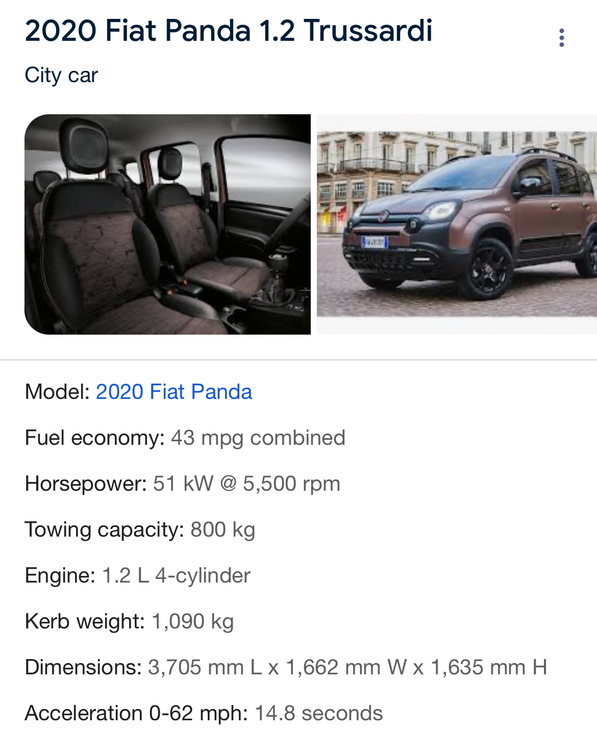

I bought a 2020 city cross in August and love it, but found out sadly today that I am not able to tow a little teardrop with it. I researched before I bought it and all the sites online says is able to tow up to 800kg braked and 400Kg unbraked .

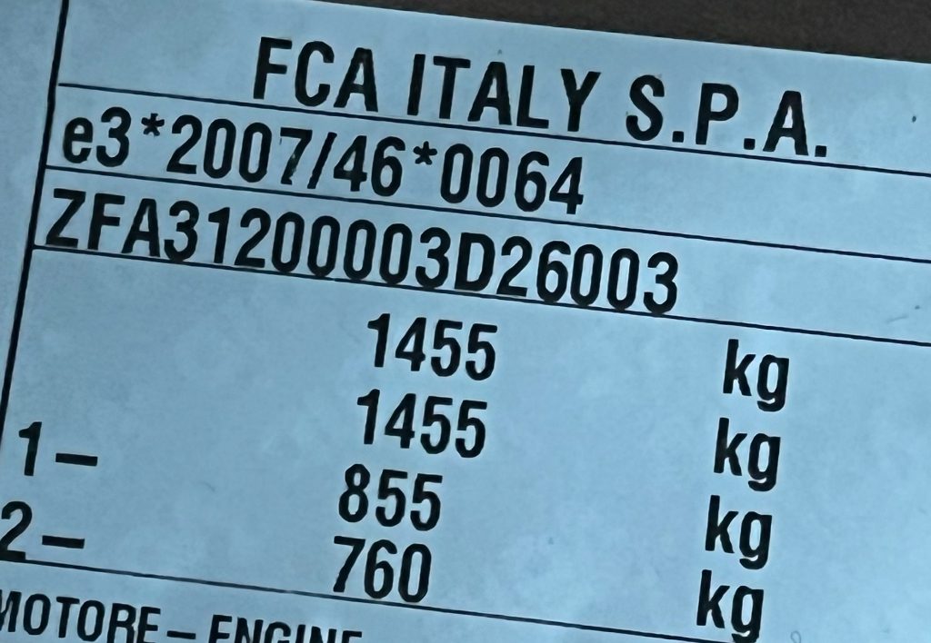

Went to have a tow bar fitted today and the VIN has the same weight on the top two lines so is unable to tow. `
i can’t understand why it can’t tow.
Anyone got round this. The tow fitting company whom I’ve used many times before are as baffled as I am

I think the 500 tow bar also suited the 2005-2012 Panda as basically same cars underneath. Post 2012 Panda is bigger/wider and the 500 bar won’t fit.
As in a post above, several newer versions of existing small cars have now been marked as unsuitable for towing - probably related to engine emissions/weight limits. Older versions of the same car can still be used: it depends on what’s shown on the VIN plate.

The tow-bar company said it was probably to do with the emissions, it is easier to say no towing than put it in a higher emissions bracket.

Doesn’t seem fair especially as all the information online says it can tow.
