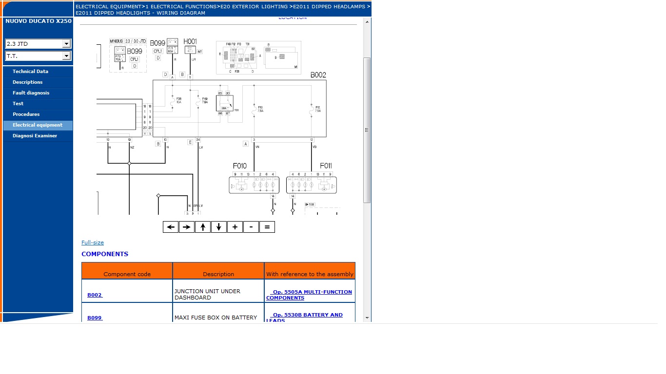

  • FIAT X250 Lights.pdf

The lights are switched via the body computer. The steering wheel stalk connects to the body computer and various resistor values are selected depending upon the function i.e. sidelights, dipped beams and main beam. This allows the stalk to connect to the body computer by a single pair of wires. The lamp clusters connect directly to the body computer.
Look at the circuit diagram in my earlier post.

Hello Jon450. It's true that the body computer M001 controls the dipped headlights, but it does it indirectly by activating the coil of Relay T01 which is part of the junction unit under the dash B002. The connection between them is via Pin 8 of Connector Y on the body computer and Pin 8 of Connector X on the junction unit.
This means that the body computer only has to handle the small relay coil current. The larger current for the lamps themselves (about 8 Amps) flows through the contacts of Relay T01, where it splits in two and flows to the lamp clusters F010 and F011 via individual fuses F13 and F12 which are also housed in the Junction unit B002.
Since both your lights fail together, I would concentrate on checking Relay T01 and its socket, and the signal from Body Computer M001 to junction unit B002 on Pin 8 of their respective connectors, which should be +12 volts for lights off and a low voltage for lights on.

Further to the above post; If the relay is removed and a link placed across contacts 30 & 87 the dipped beams should be on.
