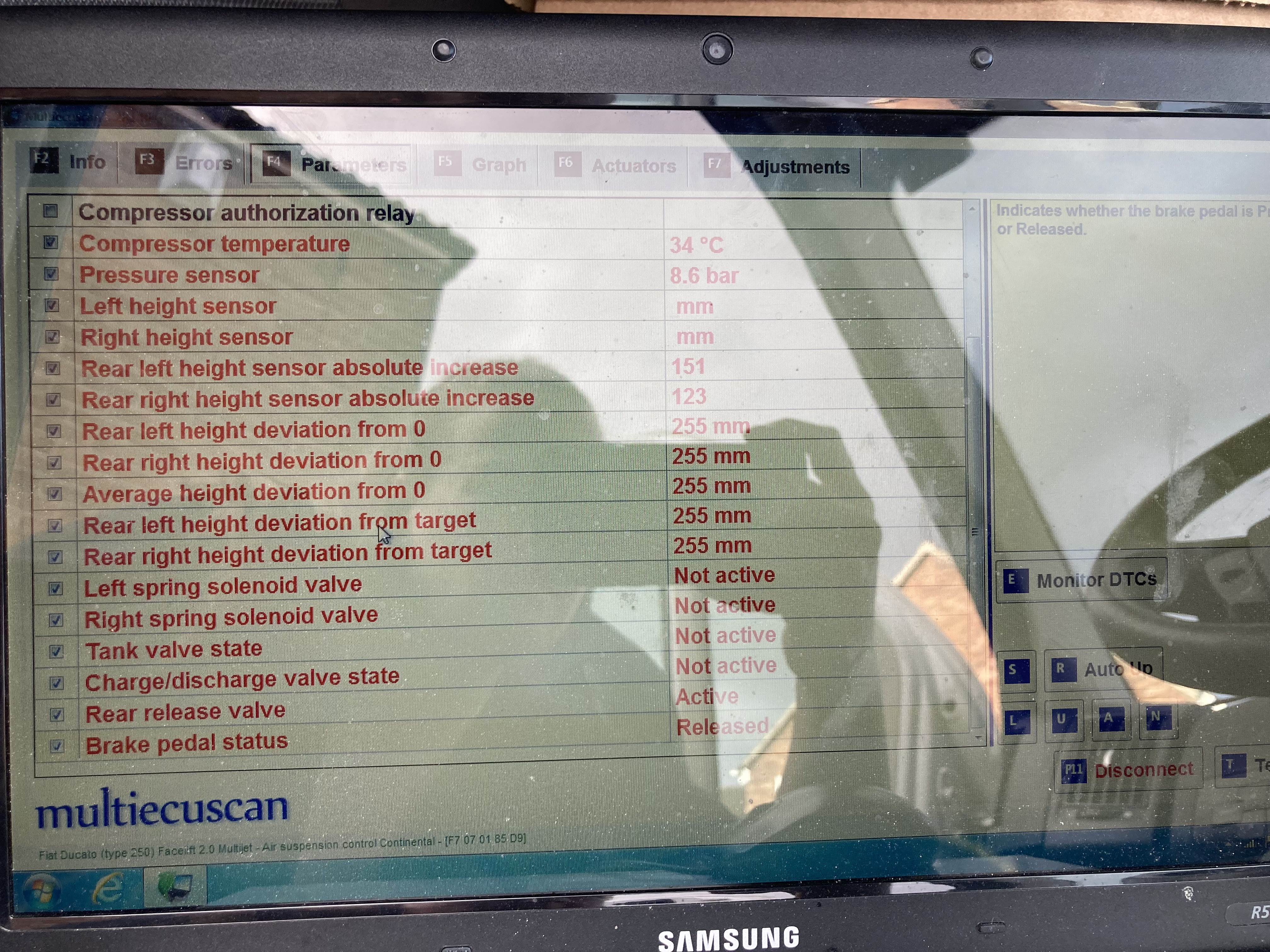

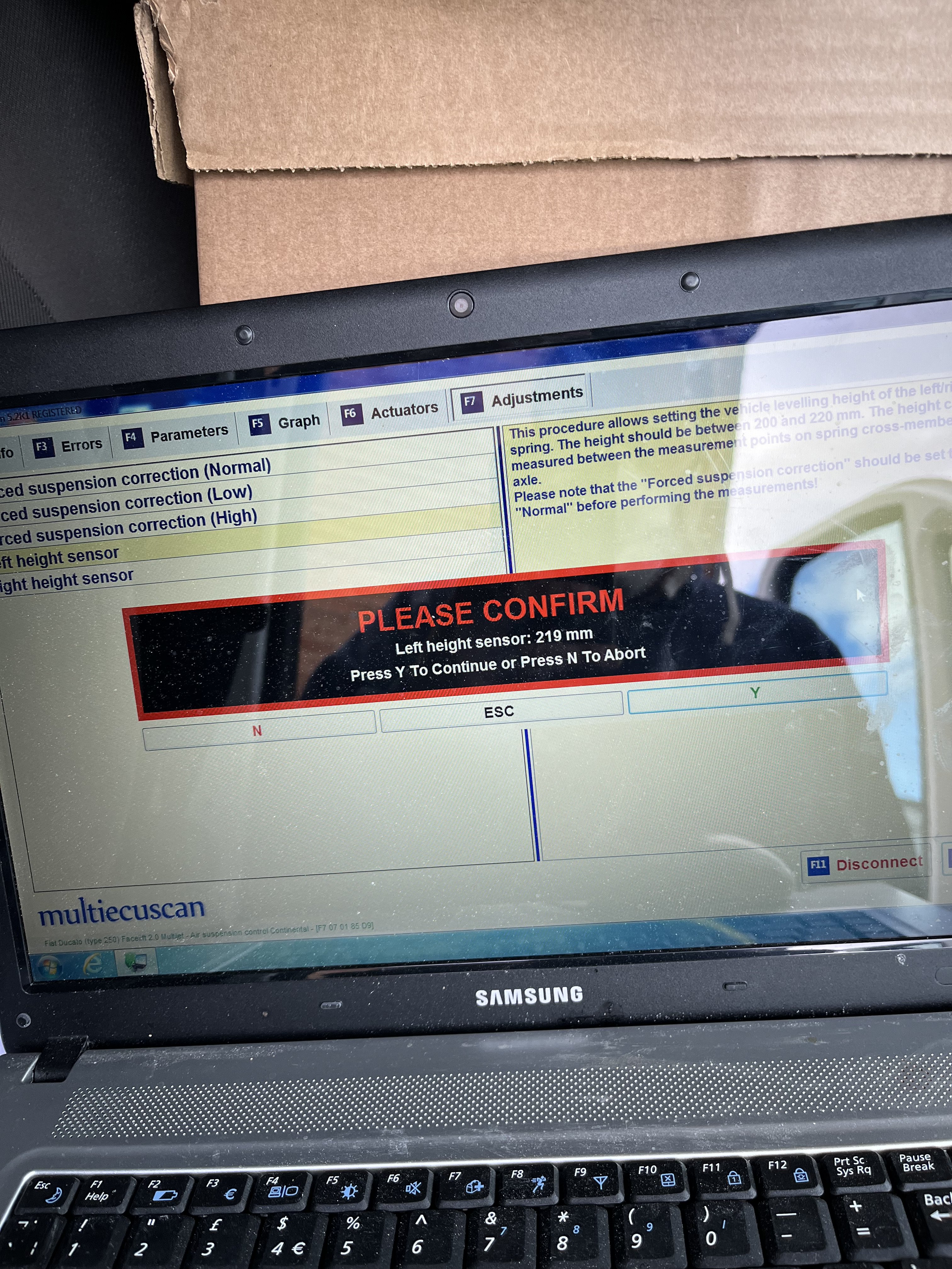

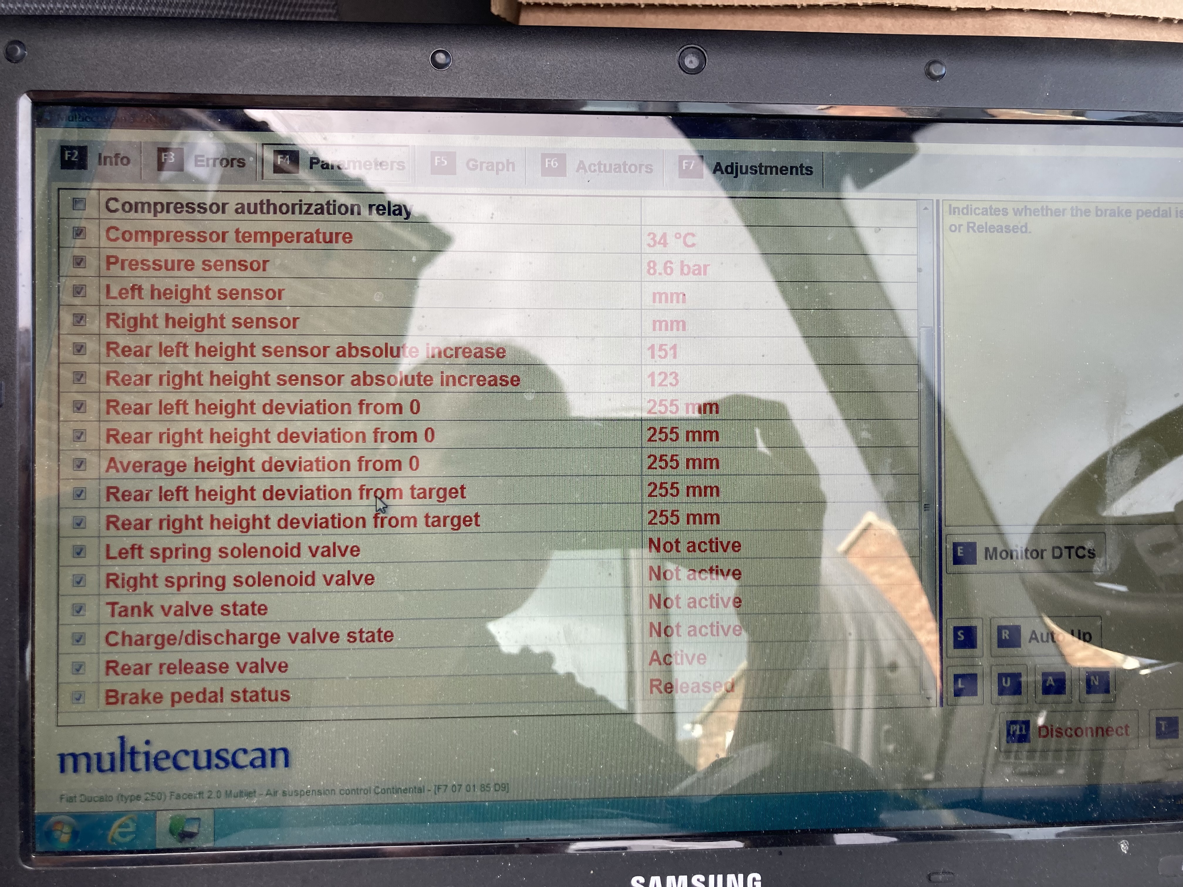

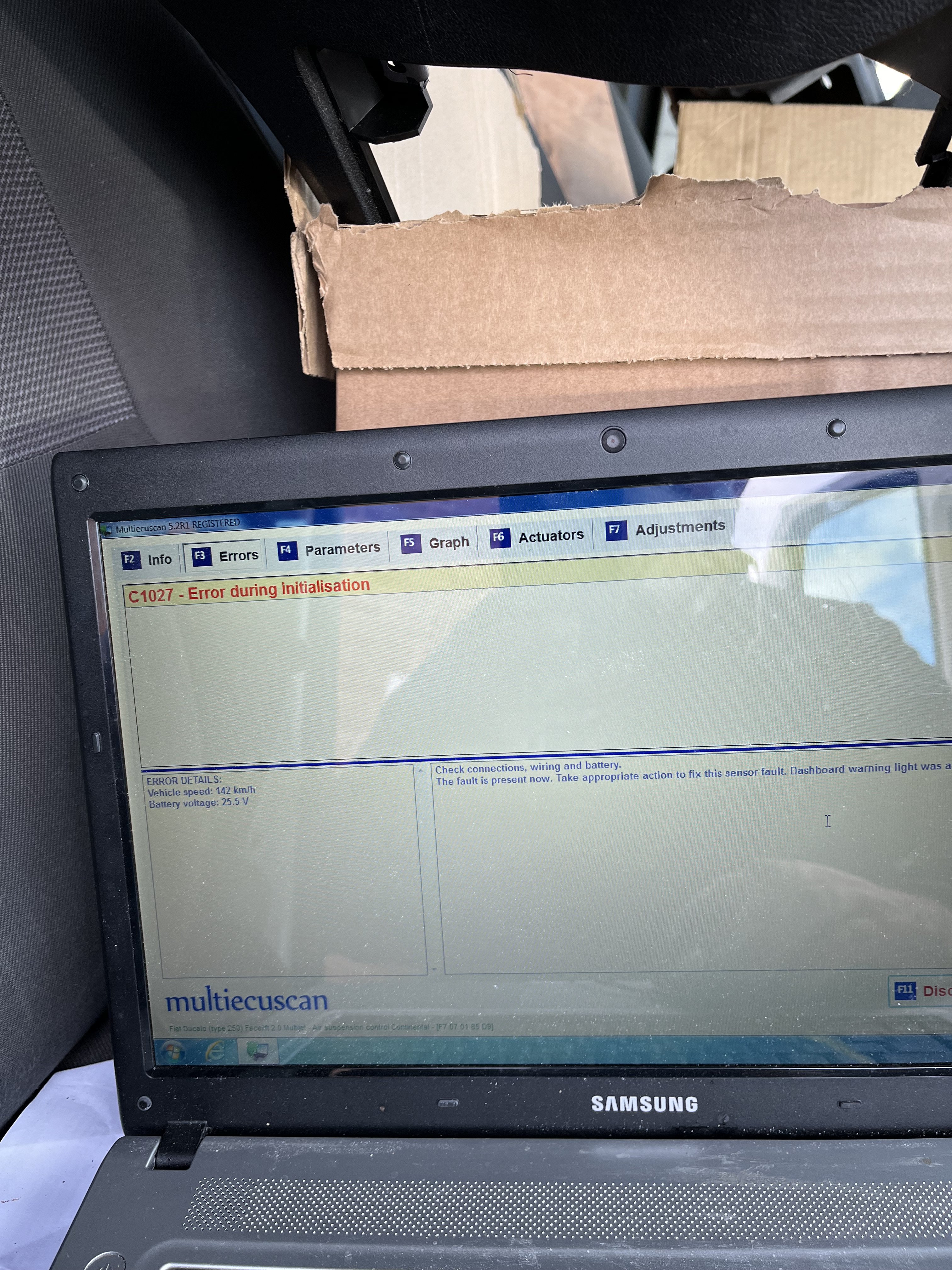

Hi all have a boxer which is basically a ducato have been playing with fiat MultiescanEcu to fix rear suspension I can use the tool to set normal high and low I also have measured the hight and set the hight sensors to 219mm suspension is still up but still have error on dash and button in cab does nothing i’m thinking hight level sensors.
When setting the left hight sensor it took 3 goes to execute right one went through no problem.
