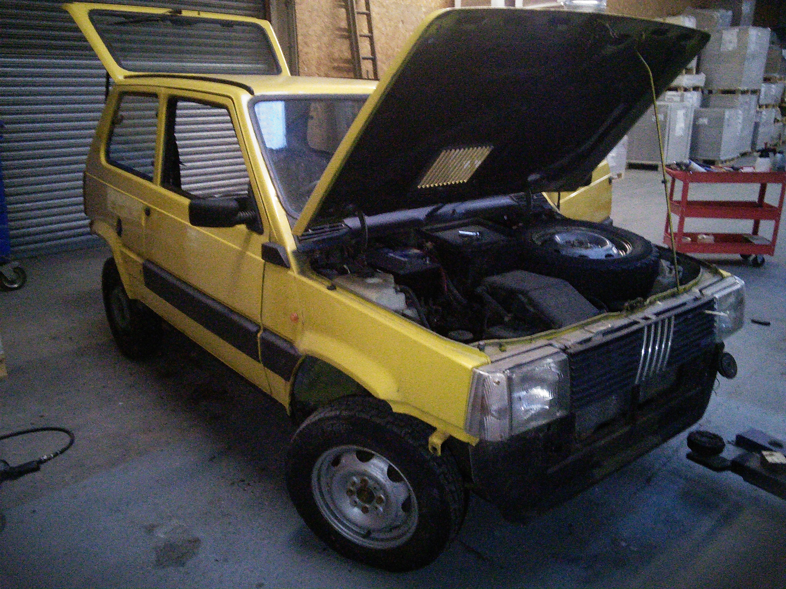

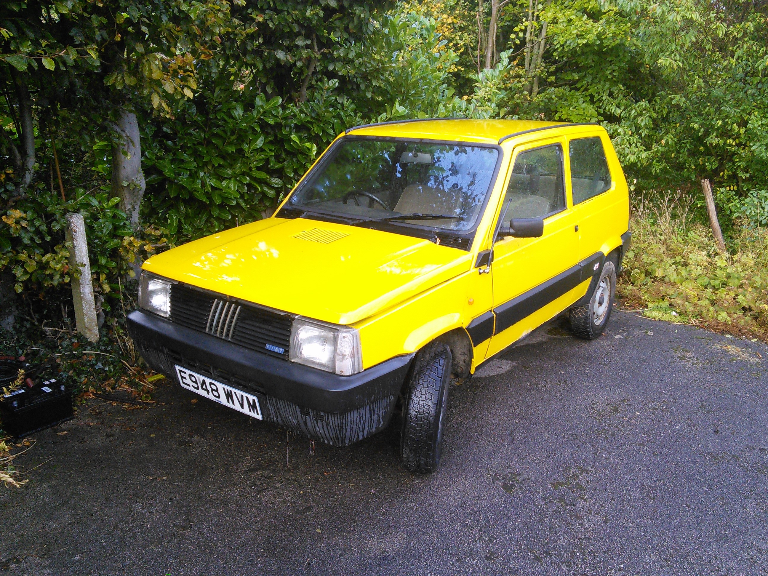

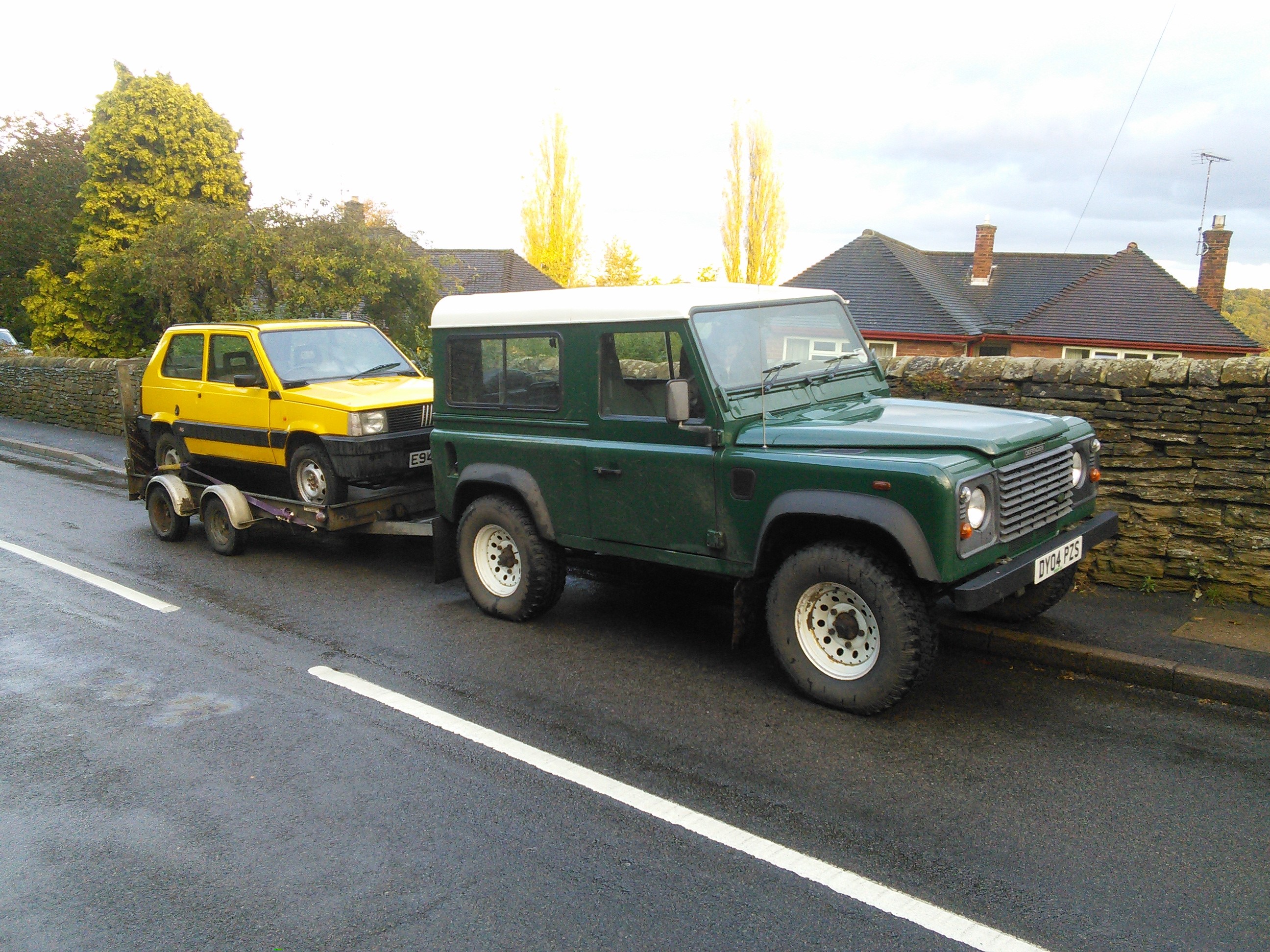

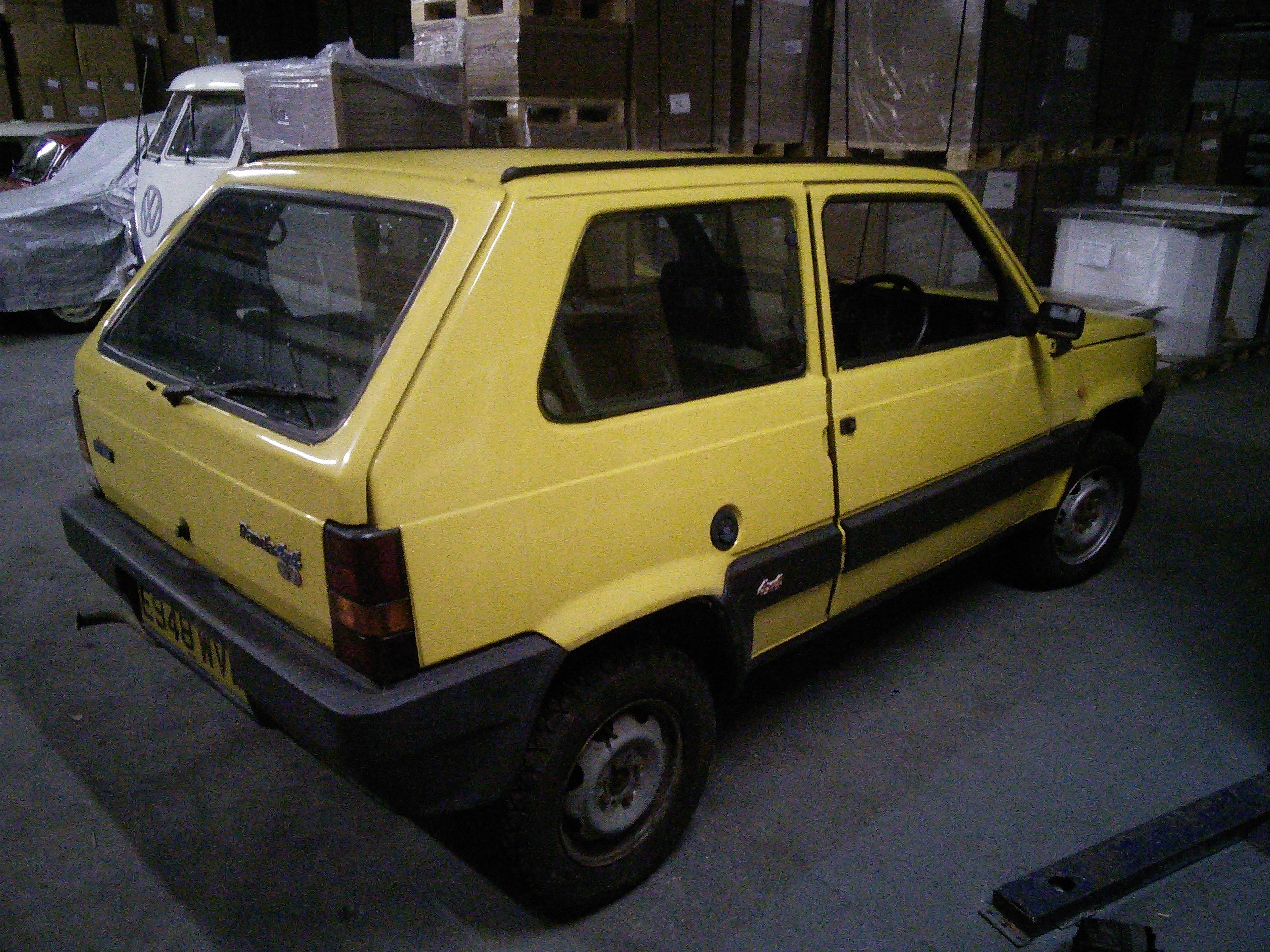

So, I've been after a 4x4 for using on the rough stuff for a while, and today I've finally got one:D
Let me introduce Digger:
Named by my Dad due to his JCB yellow paint job! He's been off the road for 12 years in dry storage and as to be expected he needs all the usual Panda stuff attending to, the biggest problem being rust of course! Mechanically, he has faired well, and should just need a recommissioning rather than any major surgery.
After going to see it last weekend, I was outbid in the last few seconds of the eBay auction, lucky for me, (not so the for the seller) the winning bidder was a complete time waster so I got a second chance offer and arranged collection for today. As usual my Land Rover was on towing duty:
Good job the 4wd on Digger works as I needed it to get onto the trailer! Anyway we dropped him off at my workshop (actually the corner of my Dads warehouse:eek:) and tomorrow I'll give him a good clean (including evicting the many spiders living in the engine bay) and a proper look over.
I'd like to get him back on the road fairly quickly, in time for AndyPanda4x4's next Yorkshire weekend;) And then a few mods to improve his off road ability will be on the cards I think.

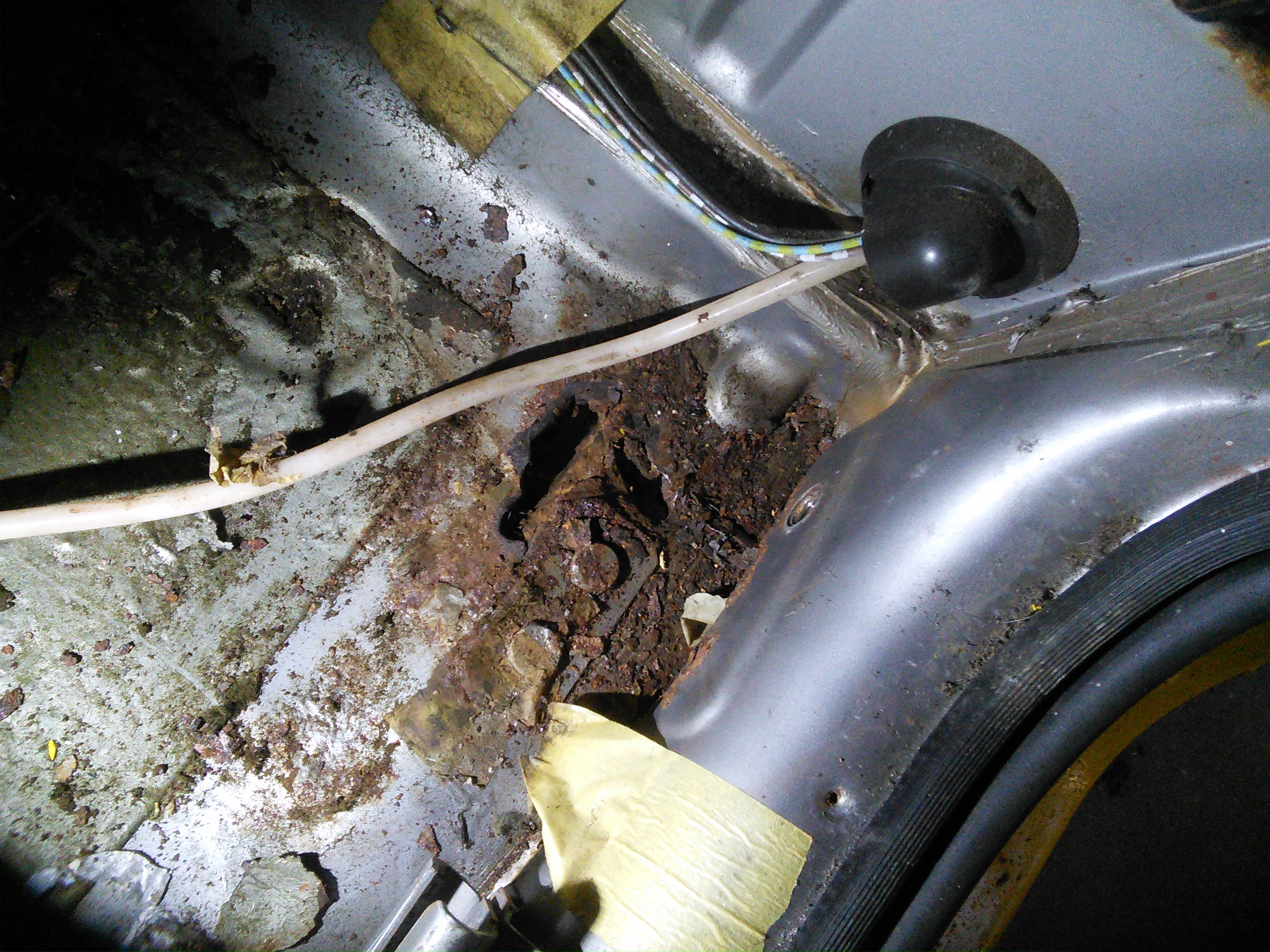

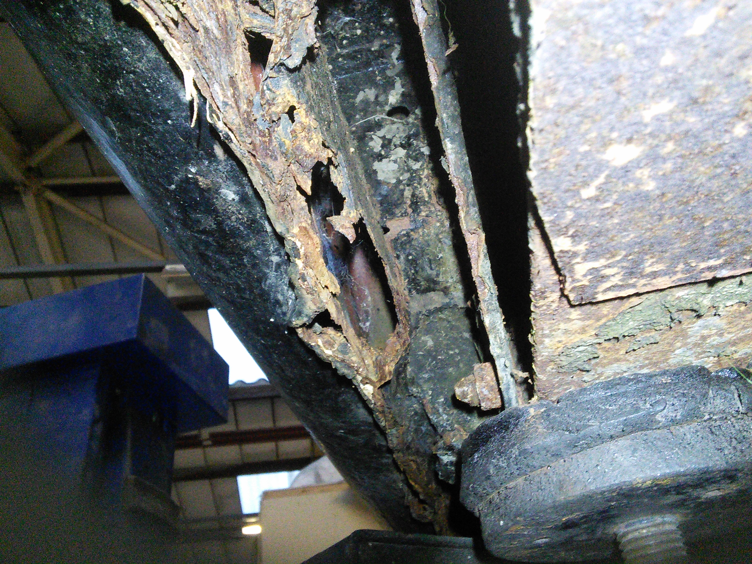

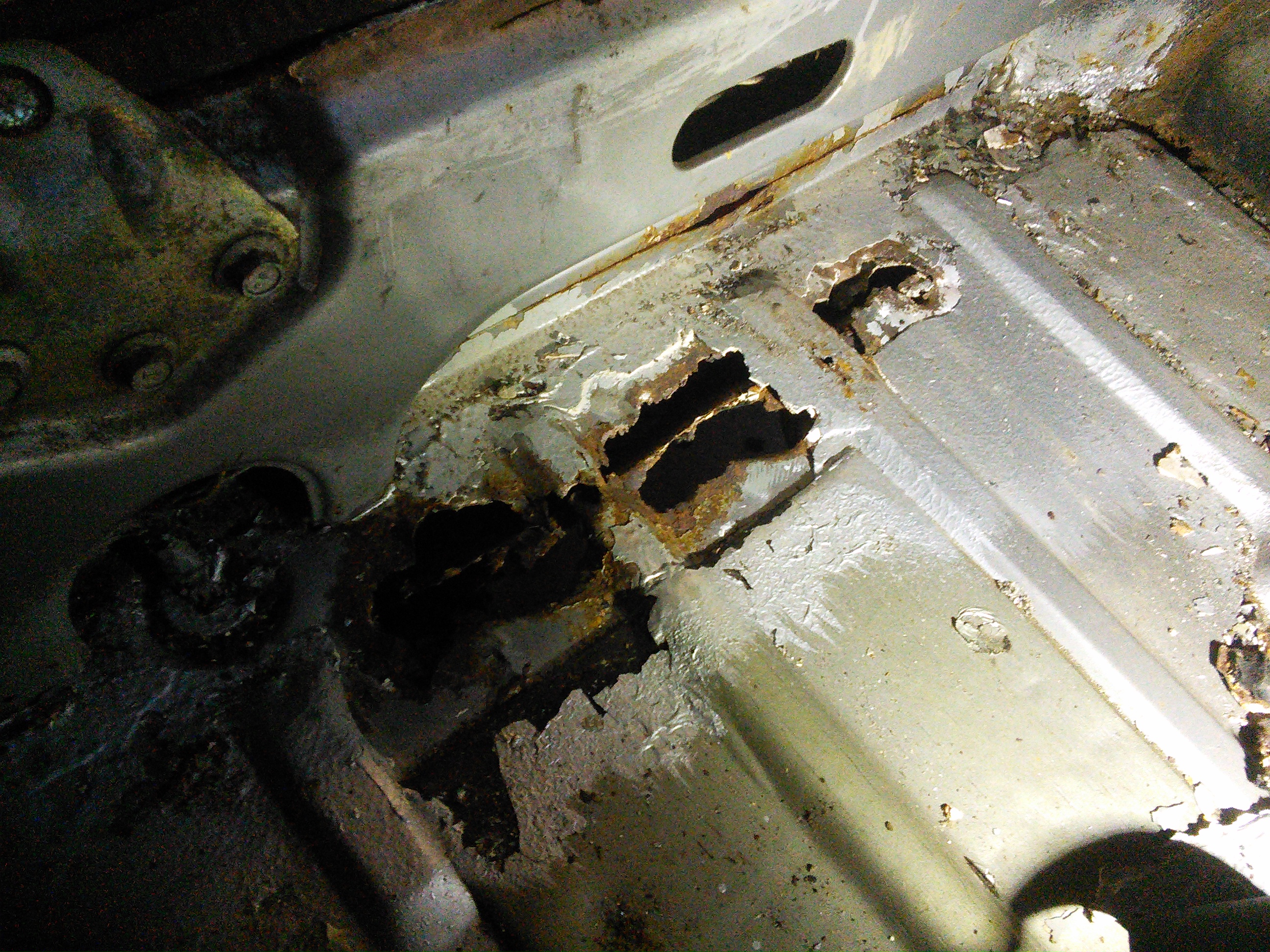

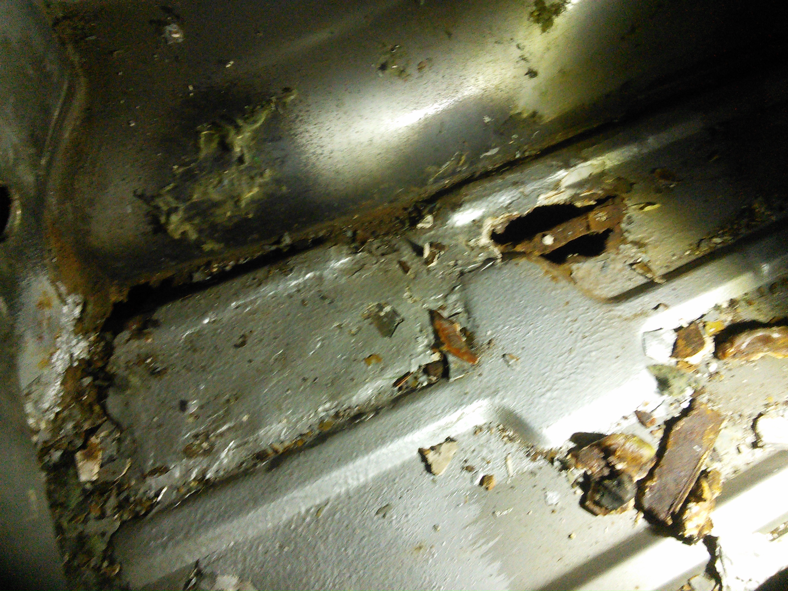

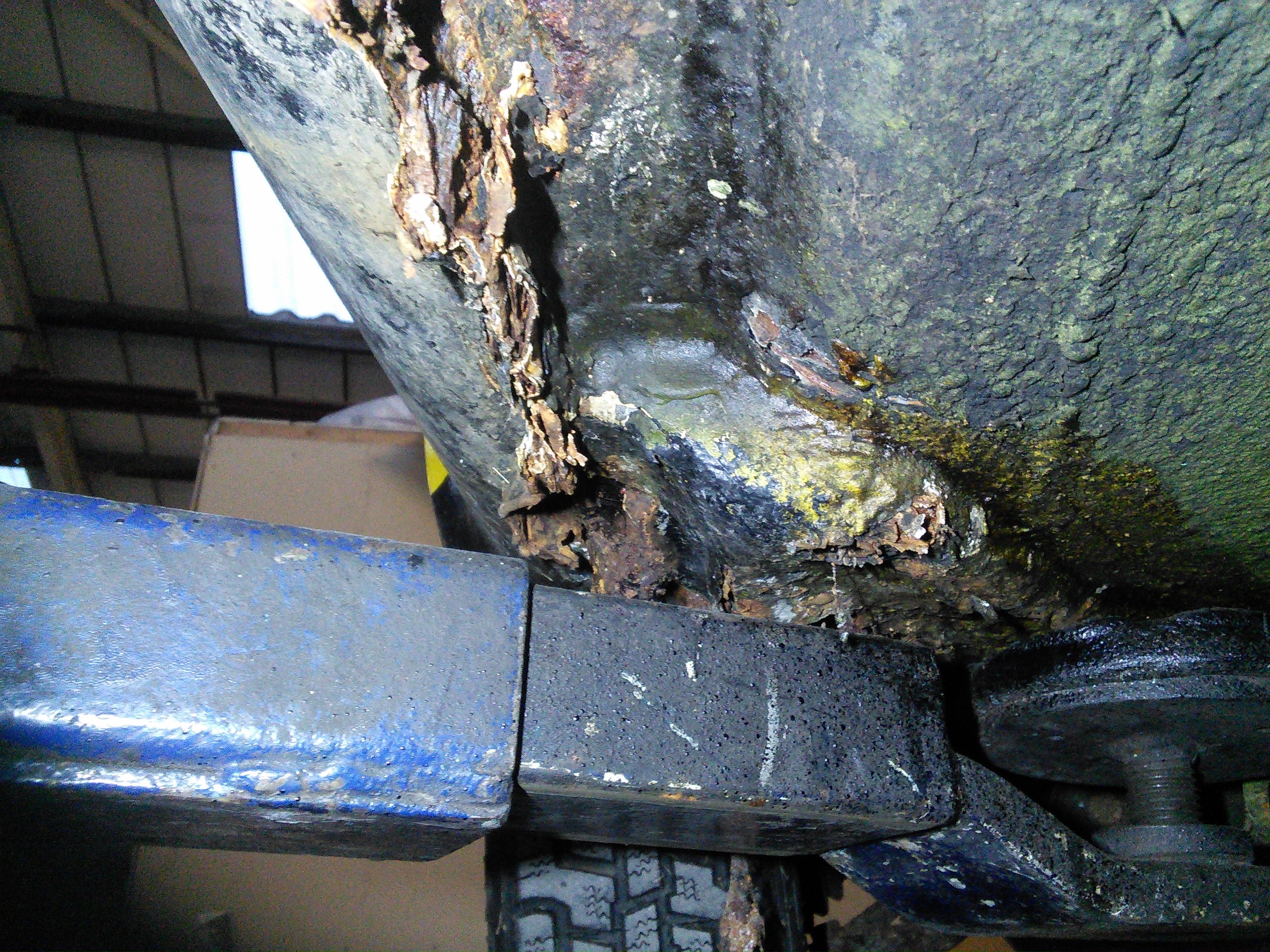

A question on this area mentioned above. I have the same problem possibly worse on the Y10. Corrosion has spread between the suspension mount and the floorpan rail its spot welded to.
I've cut out the floor above the area and plan to cut into the step in the floorpan that's at the base of the rear seat as you have here. Ideally I'd like to attack it from the sill side as well but that will involve cutting outer & inner sills off at least. If it's kept on its wheels do you think the shell can stand so much being cut out if its kept on its wheels.
Aslong as you can brace the door opening then that should prevent movement. A brace between the B pillars might also be a good idea. The weight being on the wheels is probably not a bad thing since it should mean the car is sitting straight and level and it shouldn't have much twisting force on it, that can easily happen when on axle stands.

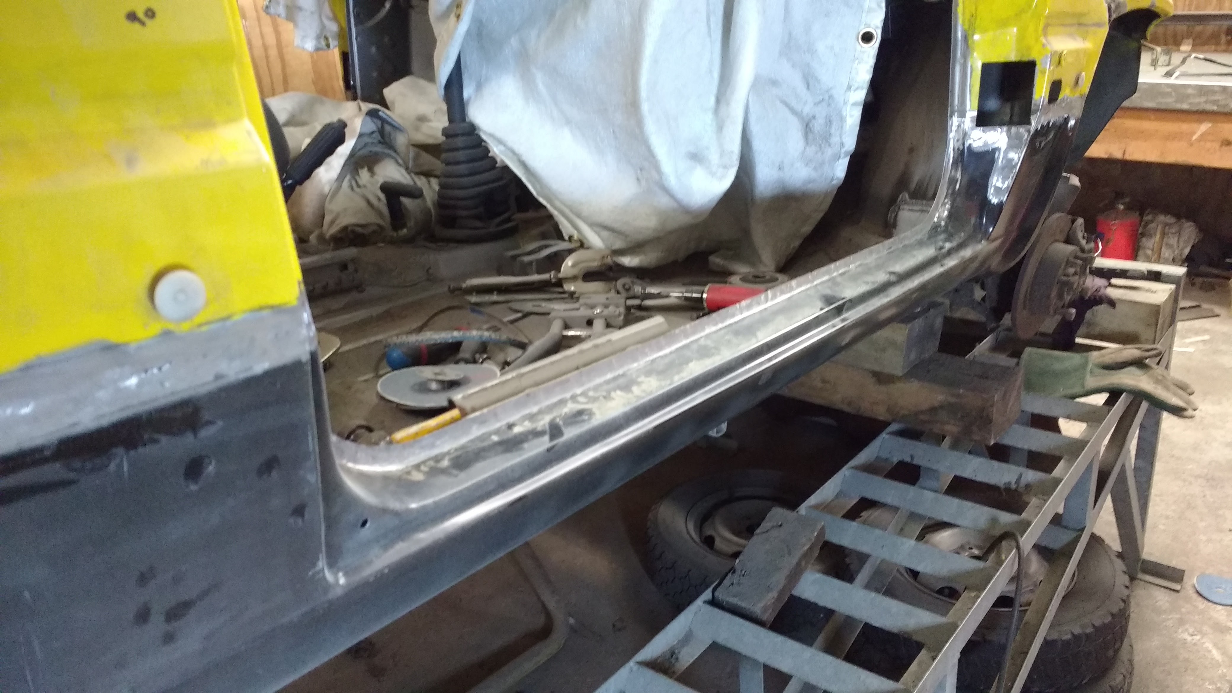

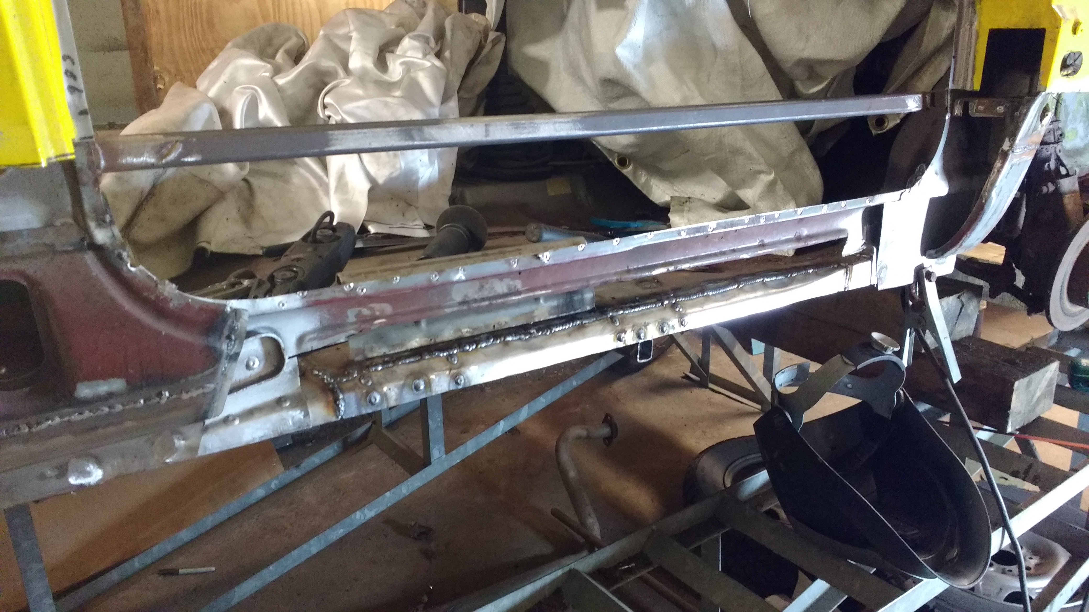

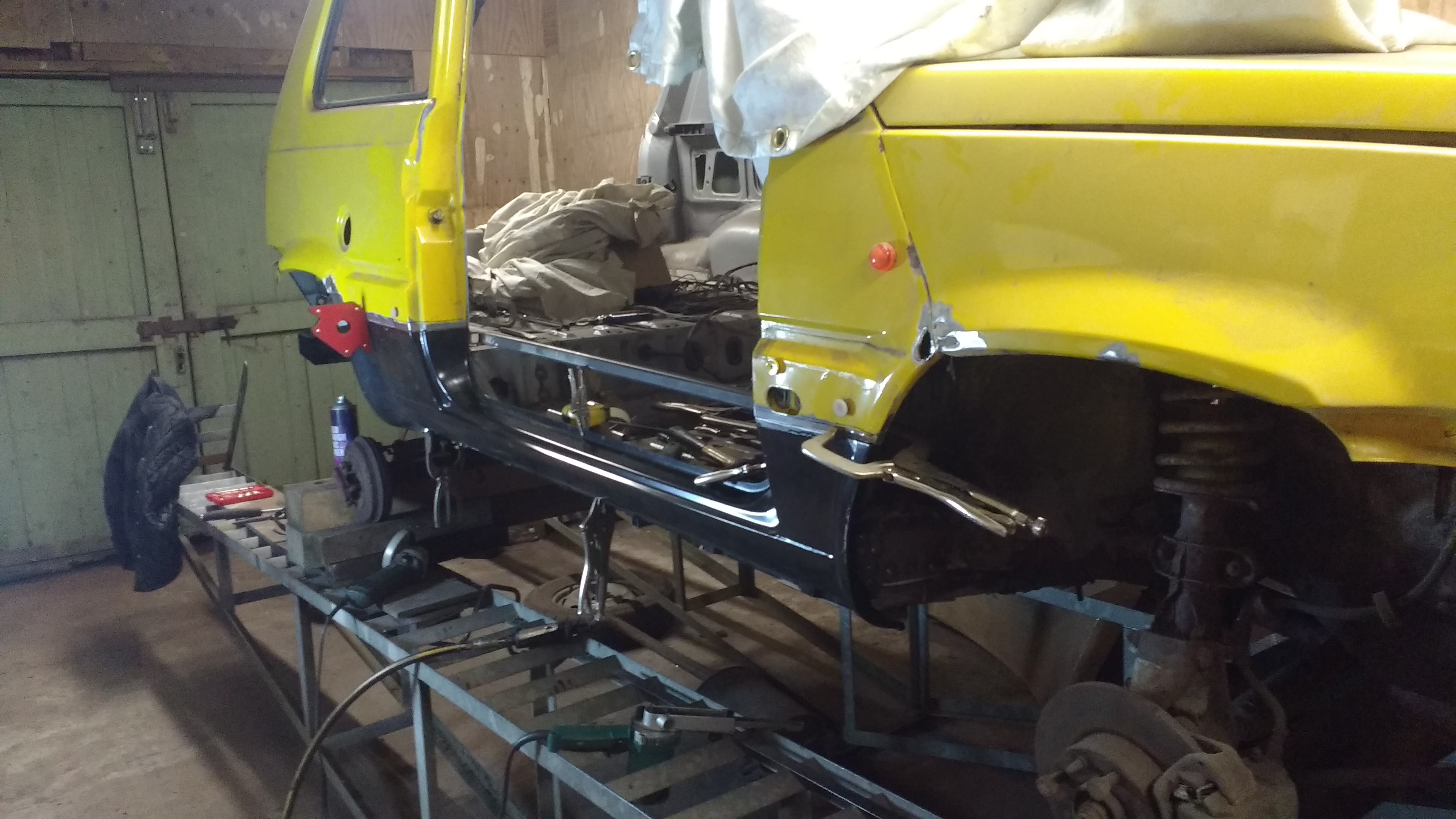

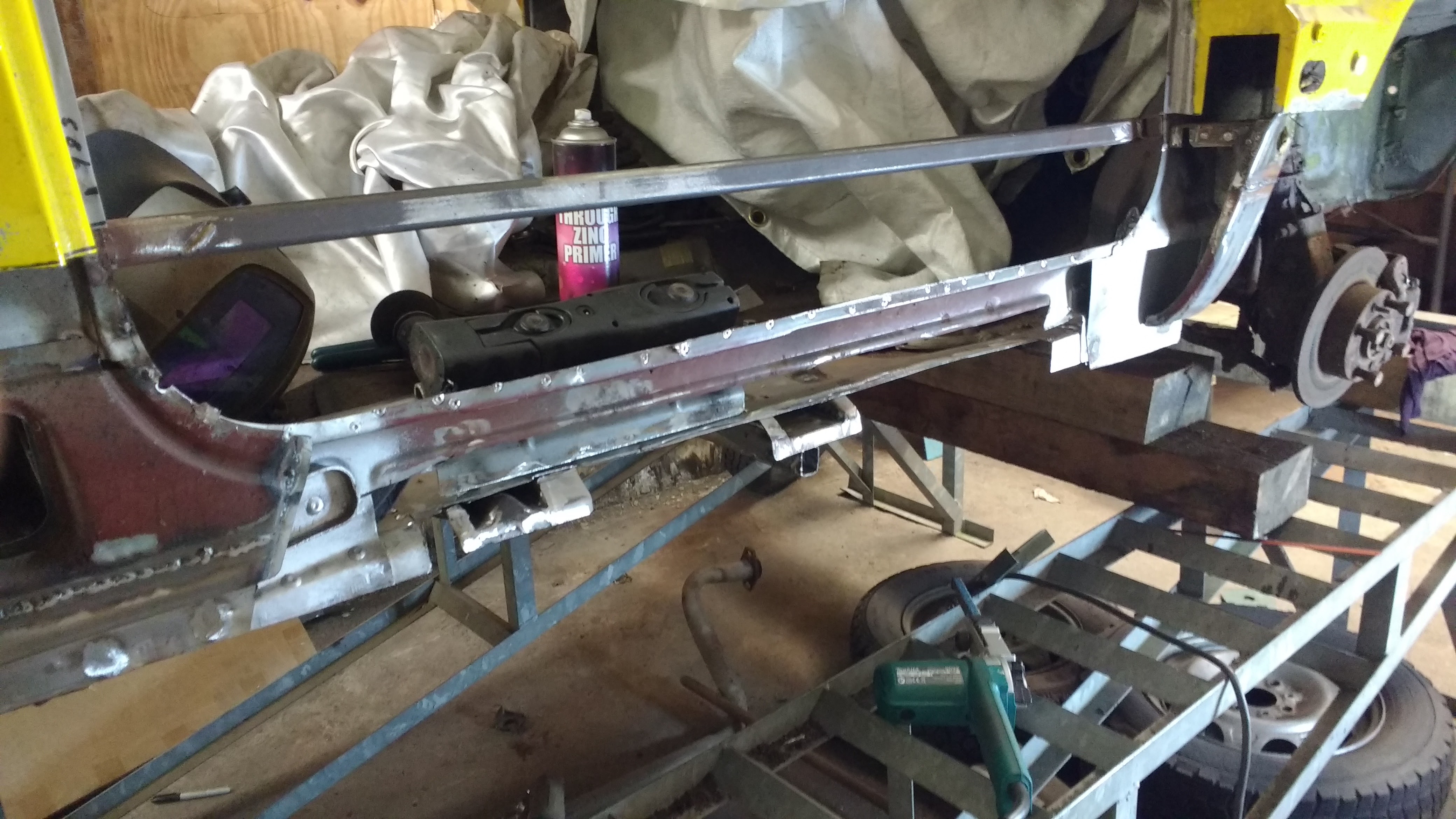

After last time I finished repairing the chassis rail and moved onto the inner sill sections. Rear part done first before doing the central section including the underfloor crossmembers and jacking point.
The outer sill could then be finally fitted up and the door fitted to check the fit. A few will probably recognise the door;)
The door fit was just as factory i.e massive gaps all round!
After that the outer sill was then made permanent, care being taken to prevent excessive heat build up and warping of the panels.

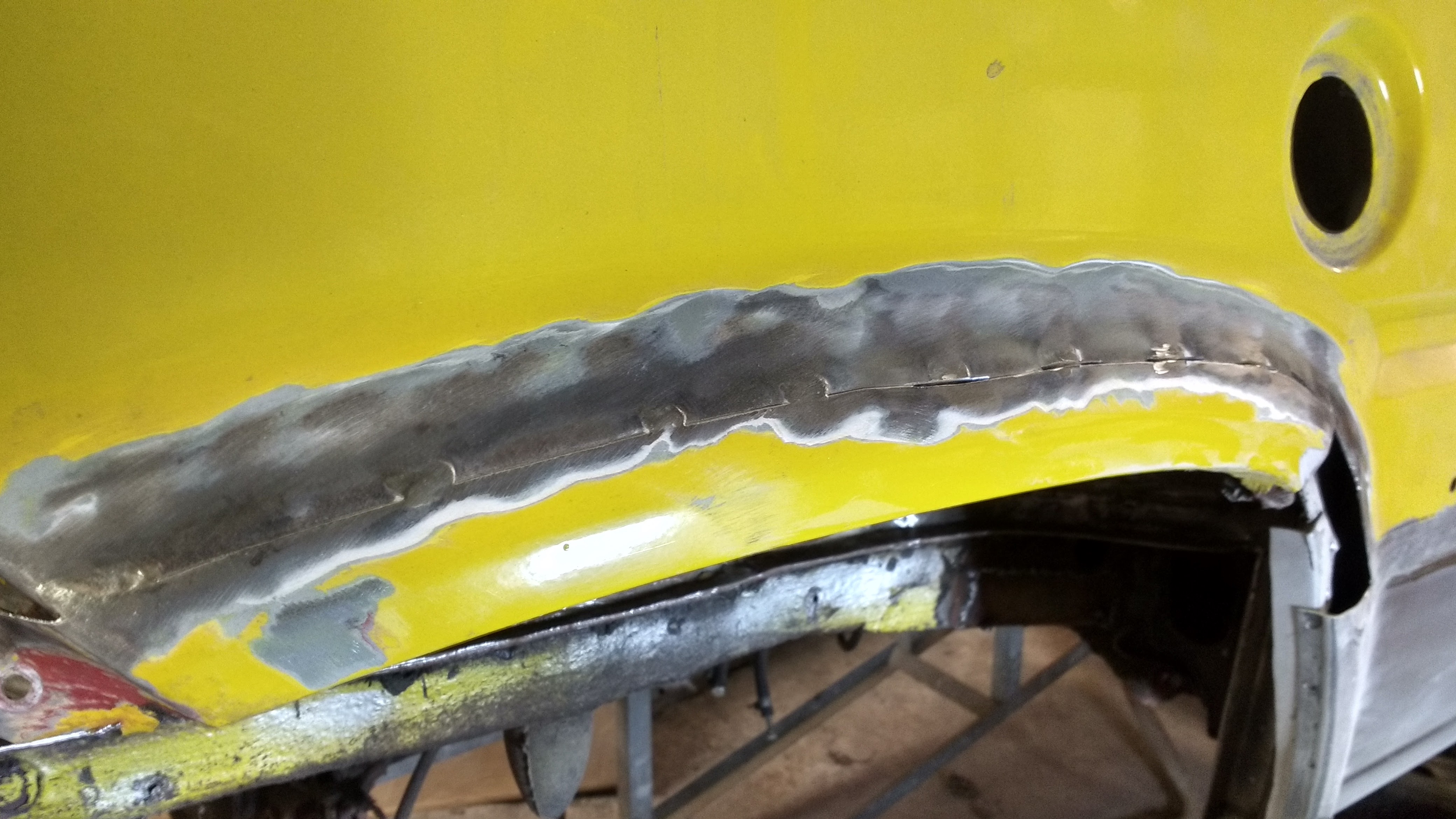

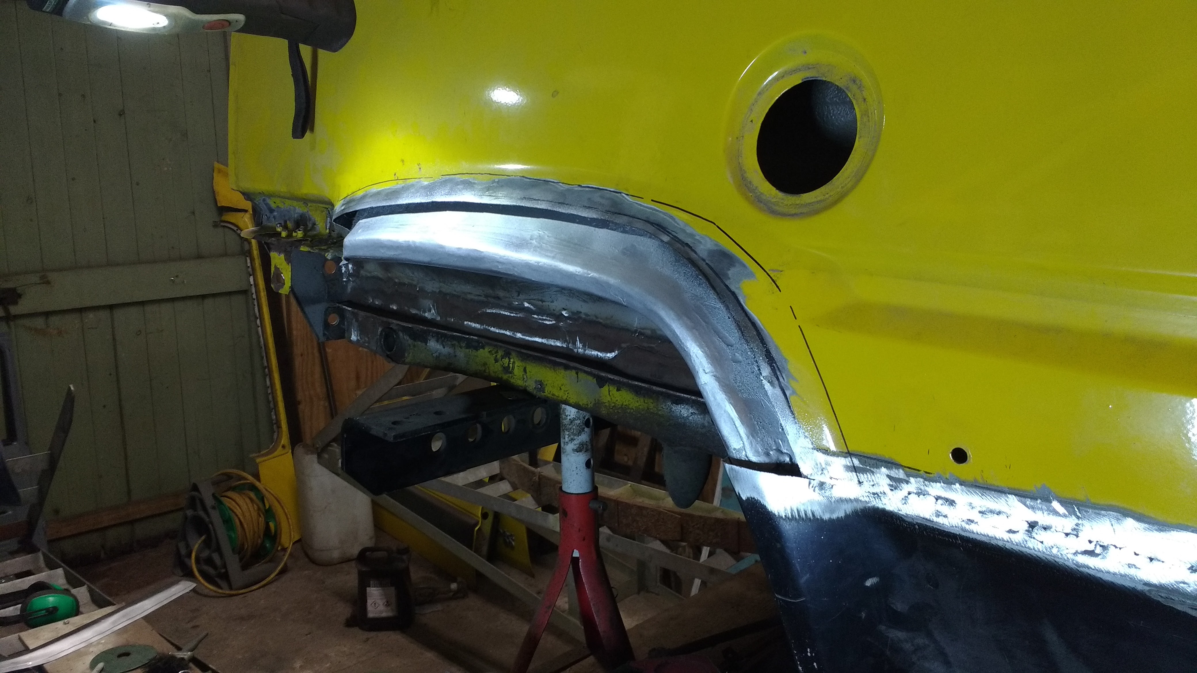

When I originally cut the sill off a year ago I discovered the rear arch had some filler in it, turns out a previous repair had been done, this was held in with braze and rivets and then filled over. The bumper mounting has also been repaired using rivets.
I could probably cope with the brazing alone but the rivets had to go so I chopped out the arch and am in the process of welding in a new section. Handily I had a quarter panel left over from when I did my Sisley so I am able to cut the arch section from that, just leaving me with the inner arch edge to remake.

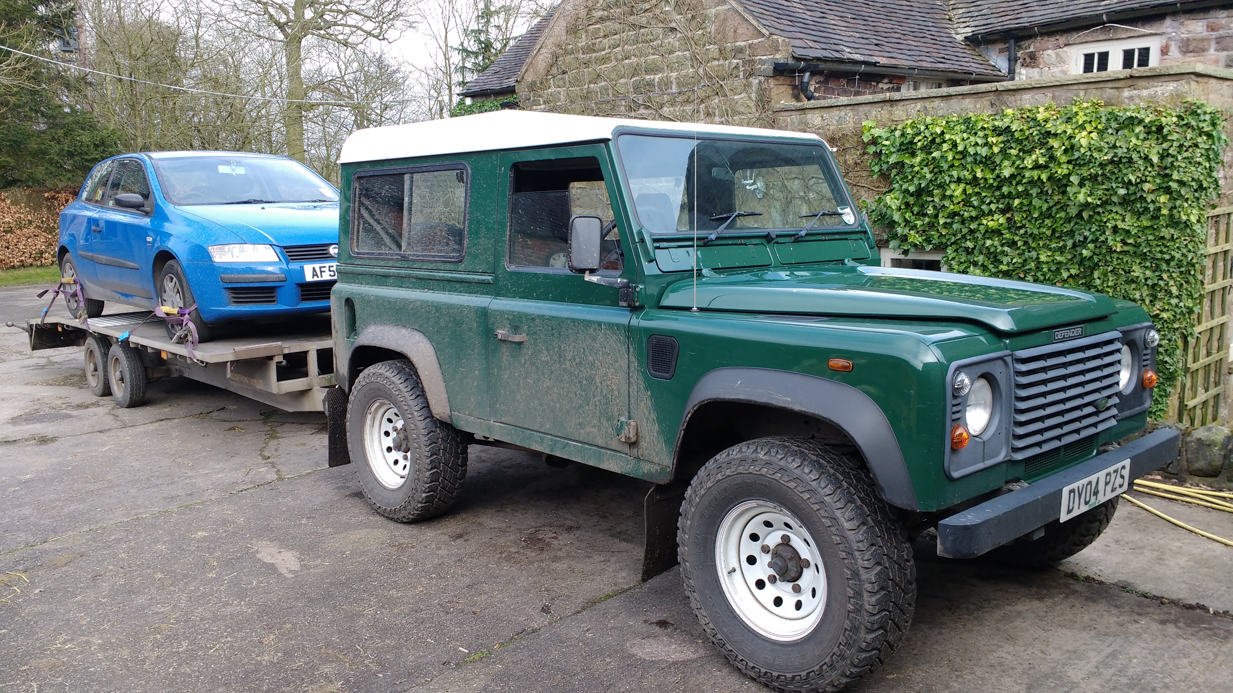

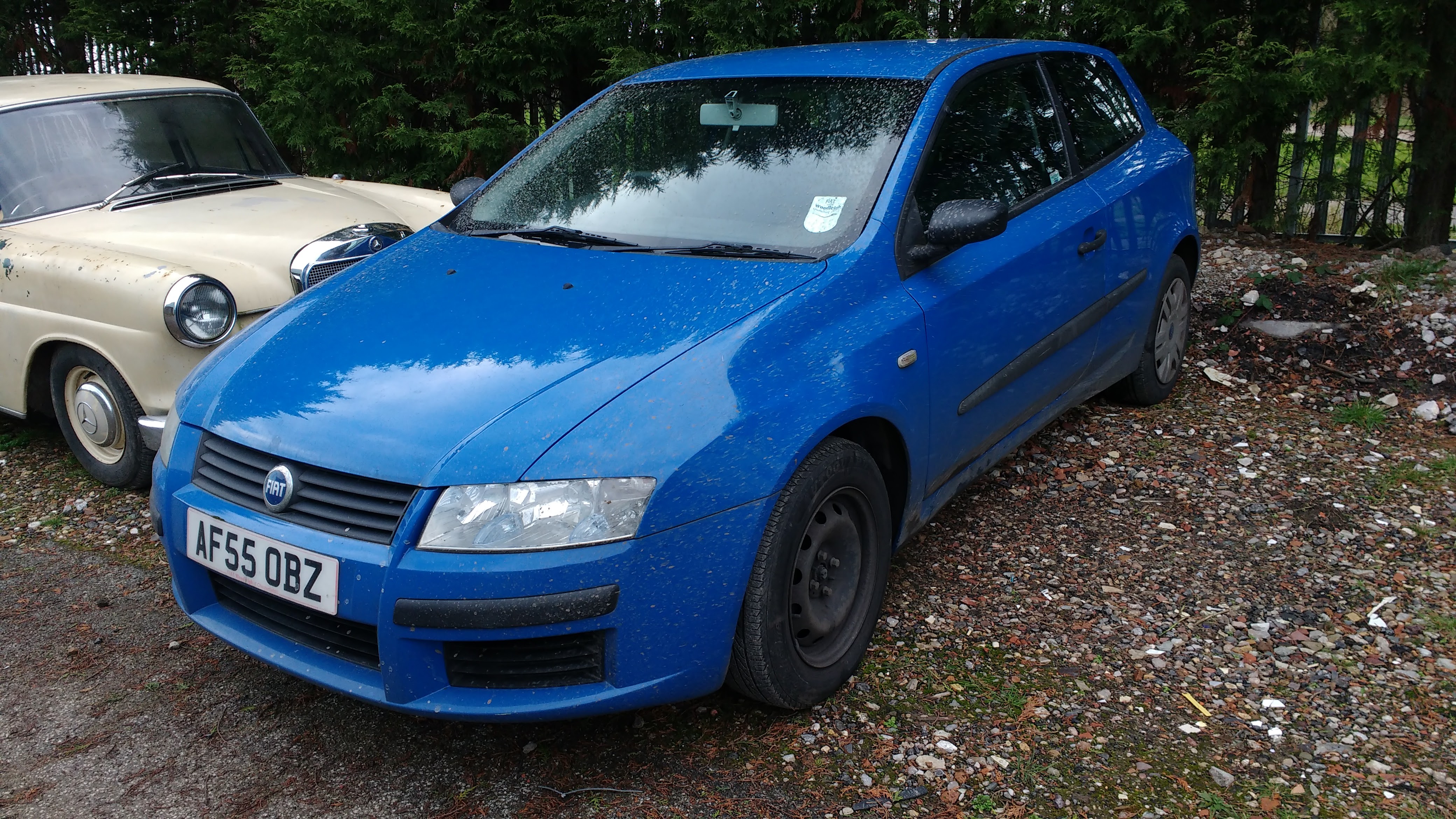

Away from the welding I have purchased Digger's engine donor in the shape of a 1.4 16v Stilo, should make for some lively performance I think!

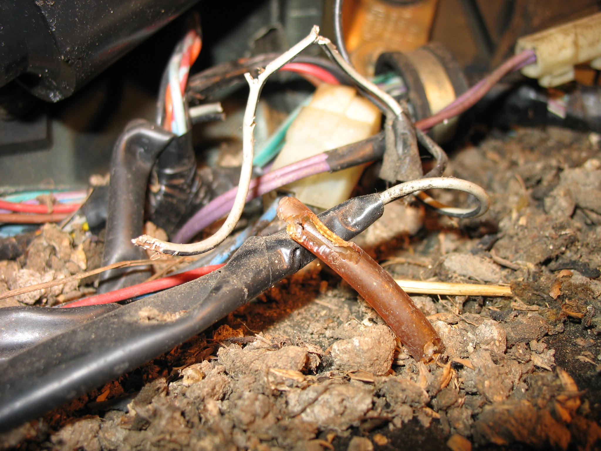

Think my Panda has avoided the mouse nest situation by way of lots of stray tom cats using it as a marking post... think I'd rather deal with the chewed wires :yuck:.
