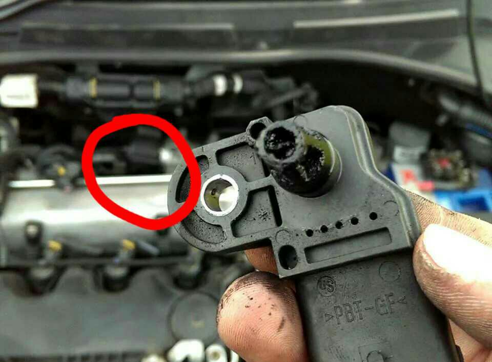

Boost pressure sensor is on the back of the intake manifold, take your engine cover off and you will see it just to the left of the egr. Held on by a single bolt.
Might be worth taking out (easy job) and seeing how clean it is, mine was pretty sooted up with gunk!

The MAP(Manifold Air Pressure) and the boost pressure sensor are the same thing... Think about it, The turbo pumps air into the inlet manifold.
Clean it with EGR cleaner as its the same filth that blocks it up. I call it derv cake :D.

Oh and before you ask its the one stephano referred too on back of manifold next to EGR valve.
