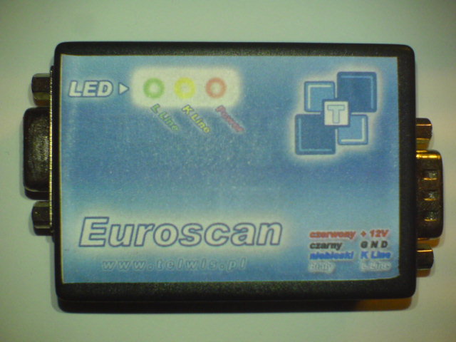

I have made a lot of search for diagnostics and i have to tell you that ELM dosnt work to your car!ELM works only on vehicles up to 2000 and a few models for bravo brava marea. I have ended to Uniscan Visa 1.83. It works very good with all Fiats and other brands and made under 2000.I have a fiat Brava 1999 80 16V and it worked perfectly! The only slag is that you will need an old PC or laptop which must have 2 com ports and win95 or win98 because it runs under DOS, byt as i said it works fine!!!! See on a search machine about this interface!

which software did you try using a OBDII to RS232 converter with? i've seen an OBDII to RS232 converter working with the fiat 3 pin connector before on a 1.6 16v bravo. it is the same thing as in your attached pic, the only difference is it doesnt come in a black plastic cover when you make it yourself. take the lid off and have a look, its the same as the ELM converter.
The foto you have is not the ELM interface but the Uniscan or Euroscan Visa.Is completely different interface! I have made my own the interface ELM327 which says that is compatible with K-Line cars, software was ScanMaster byt no result!Jug if you tried ELM323 or ELM327 I would like more infos about the cars year and with what software was the interface talked to ECU.cheers!
