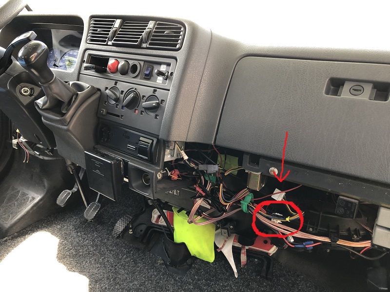

I cannot offer any further suggestions for the ECU access, other than on forum or wider searches, as I have no direct experience of the 230 model. You seem to have fixed your problem. I have read several posts relating to problems caused by the under dash connector, and a common fix is to remove the connector, and solder the wires together.

For clarity can you please confirm that by just inside, you mean on the cabin side of the firewall, not the engine side. My understanding is that the correct connector, which has been described as under/behind the dashboard, is on the cabin side.

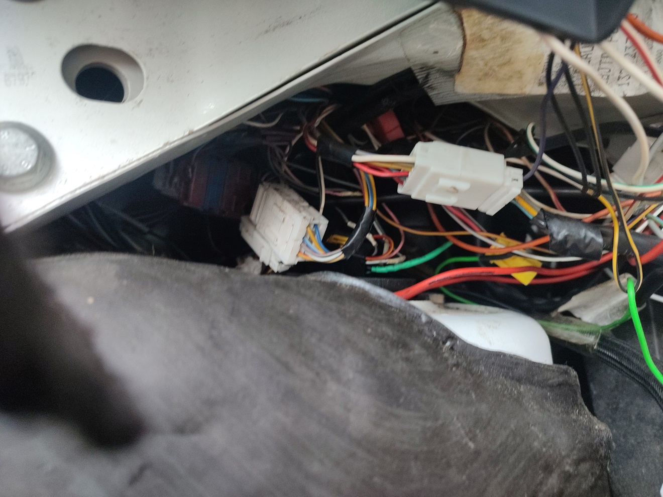

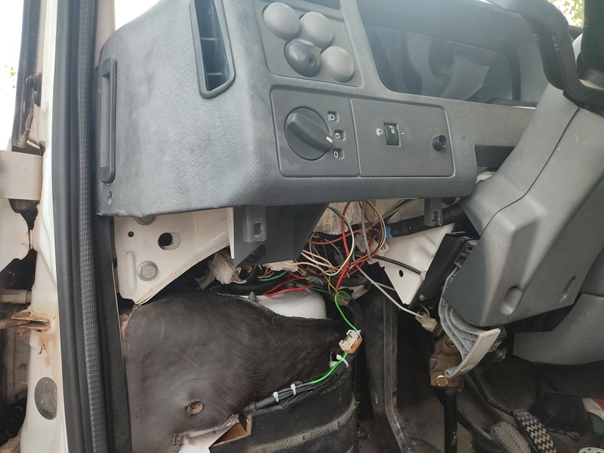

Yes it was on the drivers side of the cabin, near the cable passthrough in the firewall.
Attached pictures is from the other thread:
