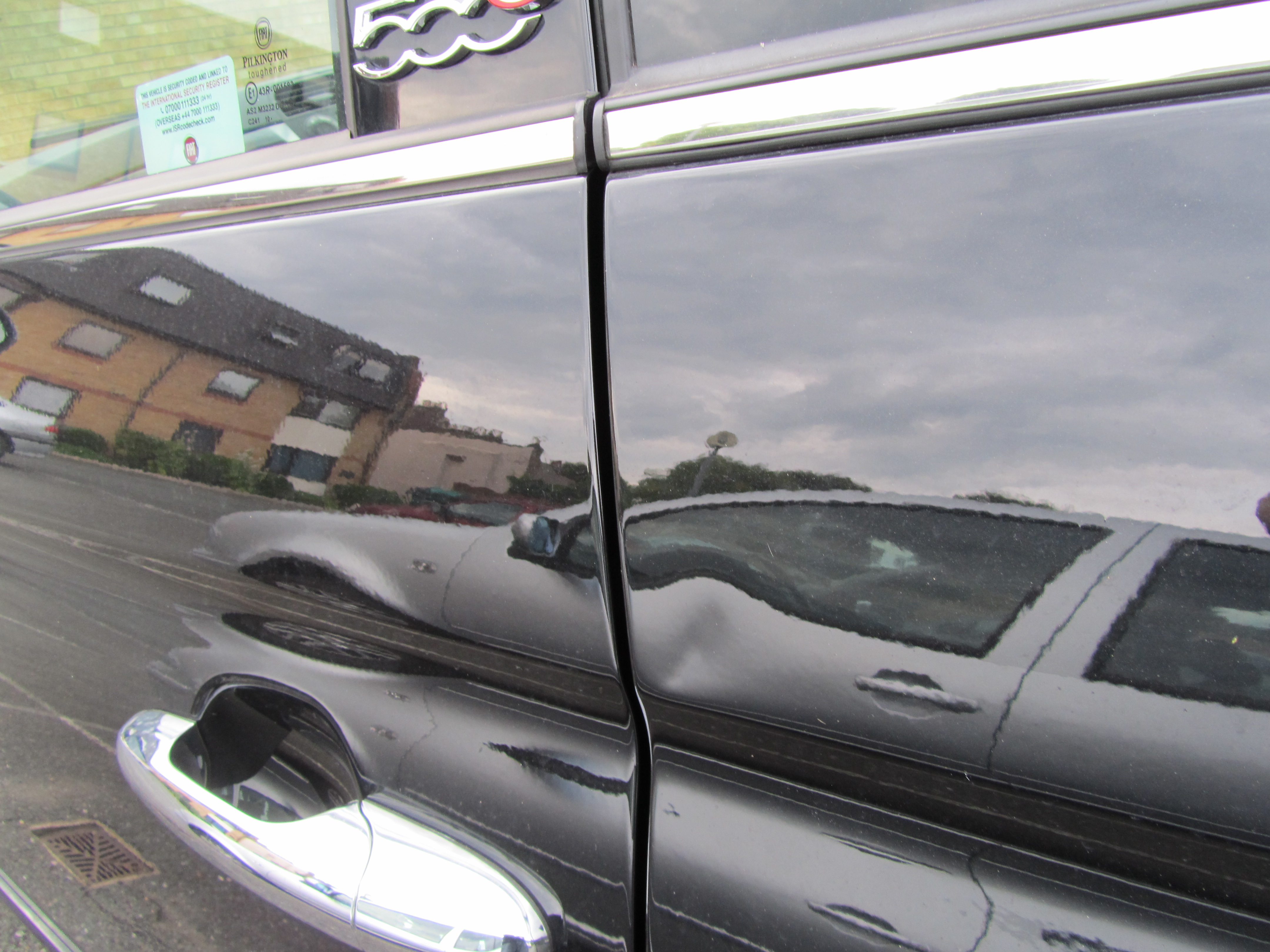

Can you post a picture of the dent ?
EDIT: If you double click (or treble click ?) on the link you'll see the dent over the rear wheel on the wheel arch.
Yes, it is metallic black. Photo of the damage attached.
It won't need a respray as the paint isn't damaged. I see where you're coming from with regards to leaving a small dent on the car but it's almost new and in perfect condition so having a dent, even a small one, would really bug me. I think I'll get the dent man to come and have a look and see what he can do.

I very much doubt that the 'dent puller' will remove all the dent since it is too close to the edge as you already mentioned.
The whole side quarter panel would need to be resprayed.

They dont pull out the dent they push it out from the inside. I am sure they will be able to get that fixed.
In the trade you pay about £40/50 per panel to be fixed, even if it has a few dents in it. £120 is quite a lot but if you are not paying then who cares.

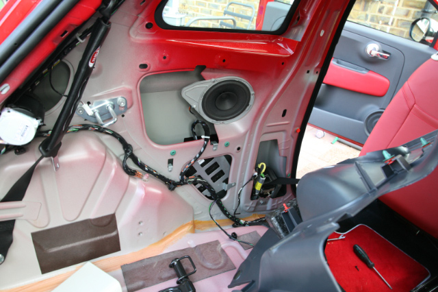

Pearce_jj should be able to answer this as he has stripped all his panels etc. out of the car to fit sound deadening. I'll have a look through his guide to see if there are any photos that might be helpful.
<EDIT> added photo
Luckily this photo shows exactly the area where the dent is located and as you can see it would be far easier to access it from here as I cannot possibly see how it would be accessible from under the wheelarch.
I would have thought that the car would be double skinned there though and that there would be an interior skin if you removed the interior panel.

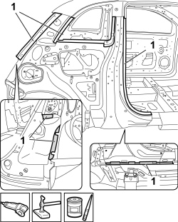

The rear quarter panel itself is a single skin but looking at the location of the dent the centre pillar is immediately behind it. No idea how much clearance there will be between the skin & the centre pillar, but it won't be much. If there is any access at all, then it will be had by removing the interior trim panel as grimwau has said.
I've attached a couple of FIAT diagrams showing this part of the chassis with the wing in situ & with it removed.

I reckon a good dent man will get that out. Access doesn't look too bad.
It is amazing what they can do, but always depends on the operators skill. I know a brilliant dent removal man down here in the Southampton area.
They might use a combination of pushing from the inside and pulling from the outside using the hot glue method. I had one done this way on my Mito's roof pillar where there was no access.
What I meant was that there was an inner skin as indicated on the photos Grimwau posted, not that the the outer skin was a double skin :) I was replying to the person who said that they would need to remove the inner wheel arch and wheel as there is no access through there.
