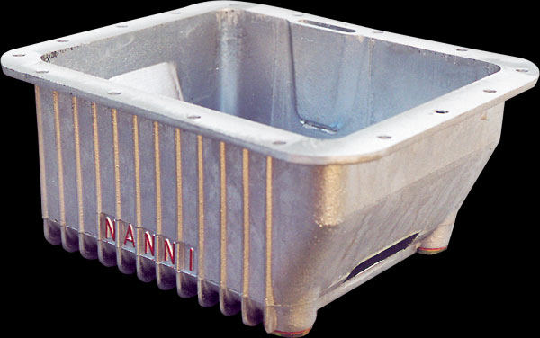

The original oil pan, on stationary movement has airflow directed to it from the engine fan, tin work and it's design. Pretty much all aftermarket alu pans do not.
The only aftermarket oil pan I've seen with inbuilt capability for airflow whilst not moving is from Nanni. But I've no data on how effective this is.
So I would leave the original pan on and see how you get on. Fitting an oil temp gauge is easy enough and I would advise doing so.
