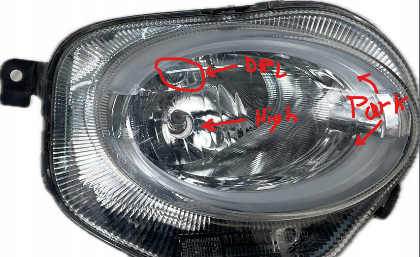

I have a 500 purchased only a few months ago. Only today someone pointed out to me that the daytime lights were not working, which I hadn't realised until now.
The manual suggests that there is a menu setting to deactivate them. The only thing I can find is See Navigation. Is this the setting, or what does this mean? Suggestions appreciated
Just to be sure we are talking about the same thing, The LED's are NOT the DRL, they are parking lights (sidelights?).
There's some confusion about that as most cars have LED DRLs nowadays. DRL is the 21 Watt incandescent bulb just above the H7 high beam bulb.
DRL should be on when the ignition is on and the main beam (or dipped beam) is off. They turn off when the main beam is turned on. (The LEDs will be on)
Yes it's definitely the DRL. The head and side lights are OK. The lowest ones in the photo.

I have a 2012 500 with the same problem. It isn't serious. The replacement part is no longer available in the US. I have decided to just leave it off. Do not really need and my turn signal is still working. As I understand it, because these run all the time when driving, the wiring gets "hot" and over time the connection harness wiring needs to be replaced. Pricey little item!! I'm letting it go for now.
Not the case with mine, its not a fault with the wiring. Just a setting which enables you to toggle DRL on or off. On mine this is accessed via "settings" on the central radio display panel. Other versions may have the setting on the speedometer menu
In our Europe assembled cars the "holder" for the bulb gets VERY Hot, and the plastic crumbles
My 1st bulb failed to light at 42,000 miles illuminated,
When opposite bulb struggled to light @55,000 miles it was simply a poor connection
Wiring has been ok
Have you attempted to swap holders left to right and Right to Left?
No I haven't tried the swap. Do not know if that would solve my problem as
the "right" harness needs to be replaced and in the US the part is no longer
available.
