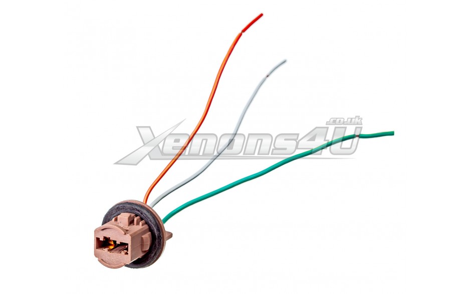

Hi ziggy, it's a holder type that a T20 bulb fits into, The connections are part of it so no wires it's like a butterfly wing that's on the back of it to tighten it in place.I don't have a pic right now but will post one tomorrow

Connector is similar to this but no cables

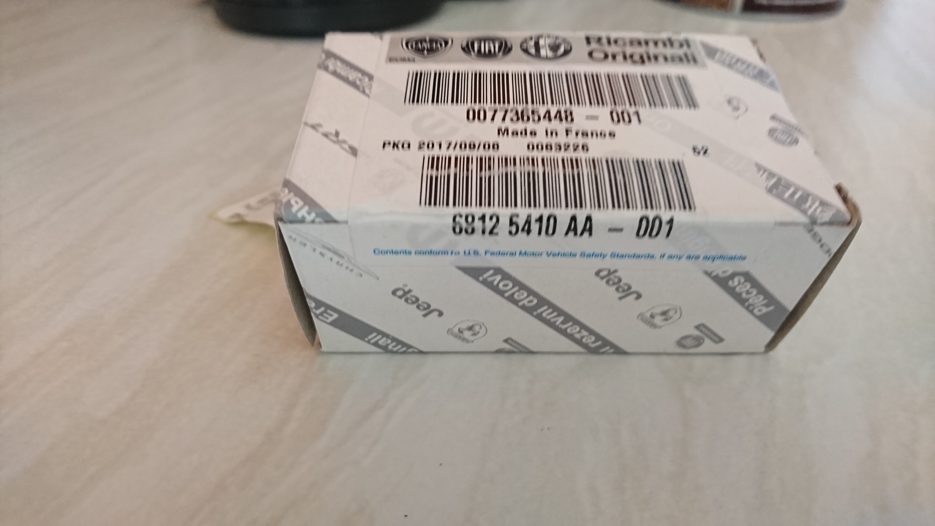

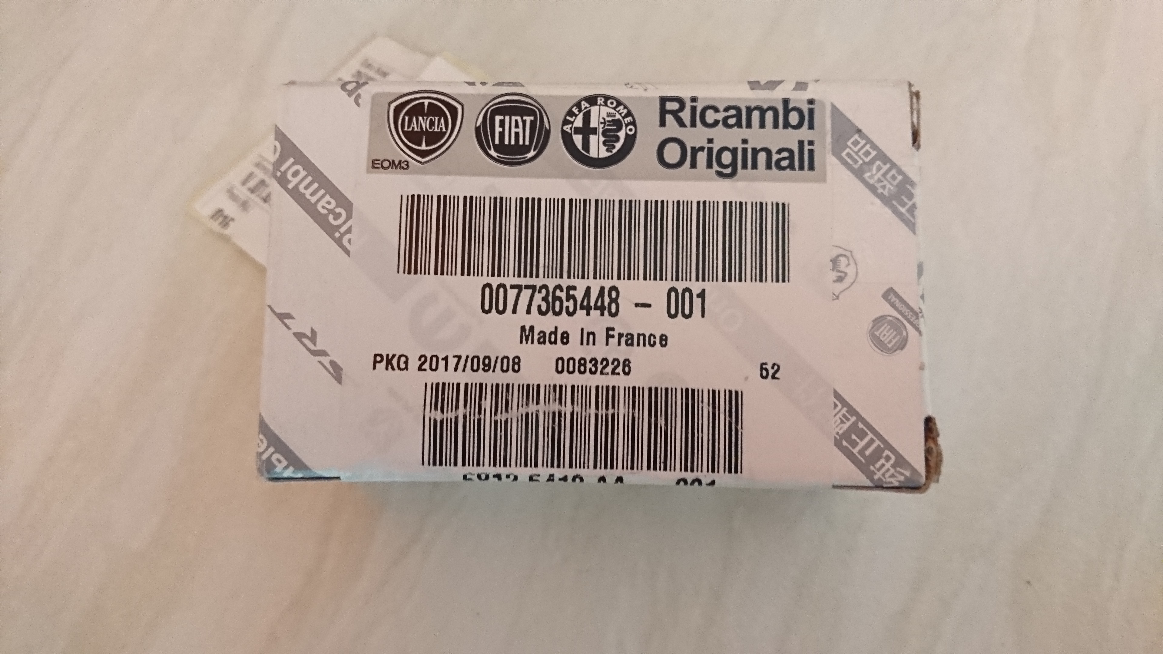

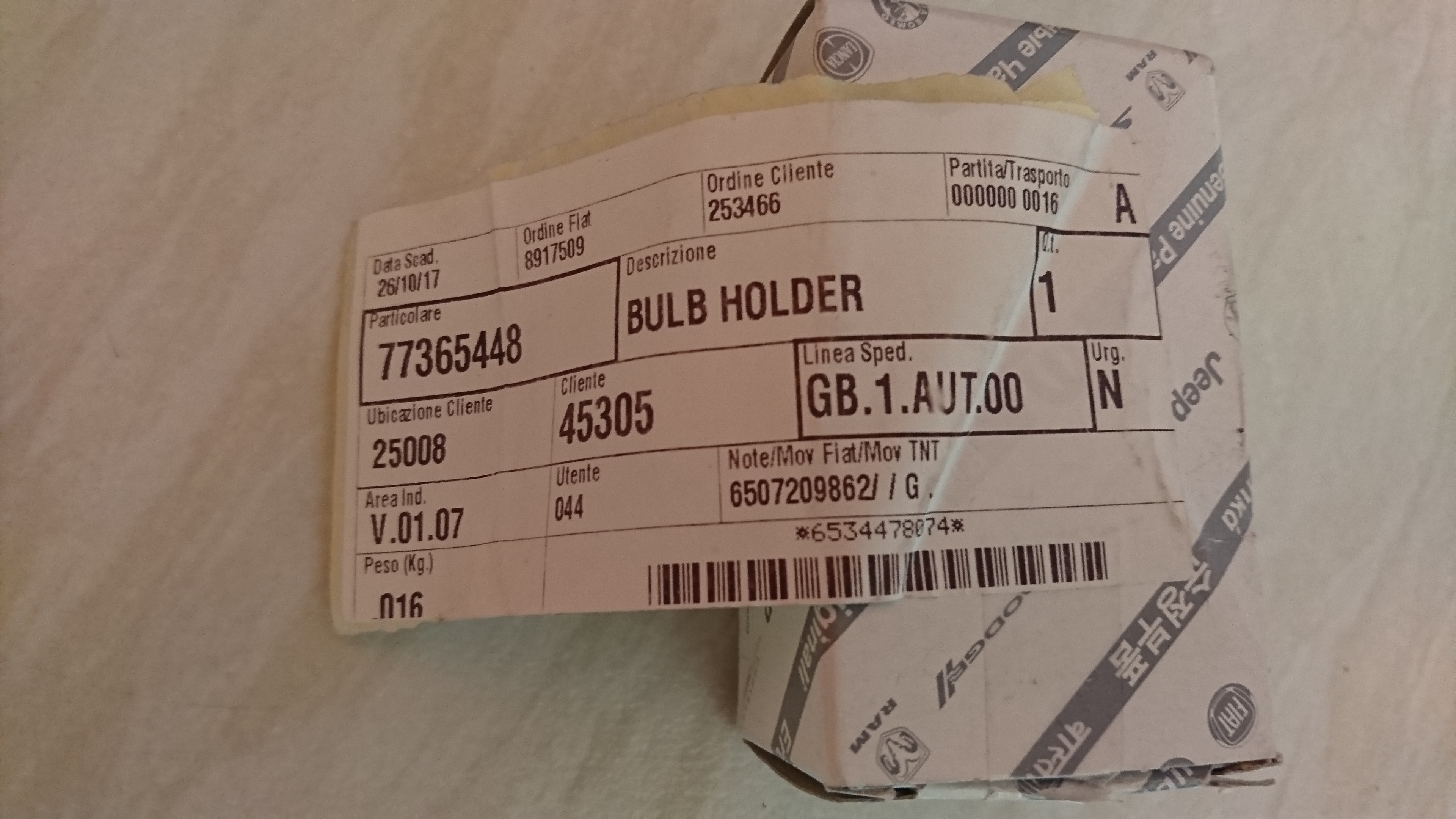

Hi Tony hope this helps...
