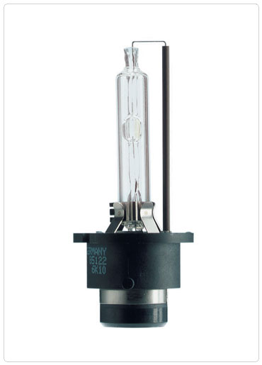

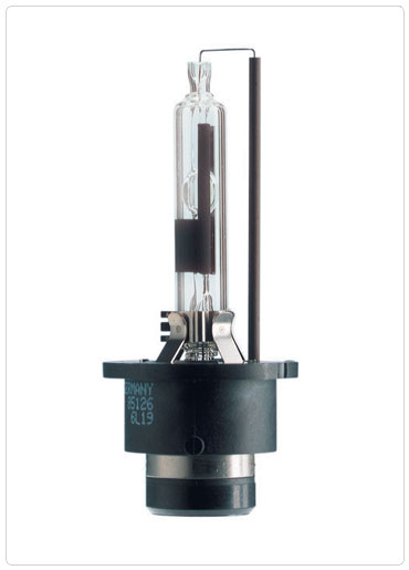

The locating notch on the base of D2R and D2S burners are slightly different. You may be able to force fit them but that could seriously alter the beam pattern.
Also, D2Rs are designed for reflector lamp housings as in the Stilo headlamps, whereas D2Ss are designed for projector lamp housings. D2Ss don't have the metal or ceramic shield on the glass vial which could also alter the beam pattern.
EDIT: If you get them, could you let me know what manufacturer is printed on the box and on the bulb base, and also whether they are "E" marked.
