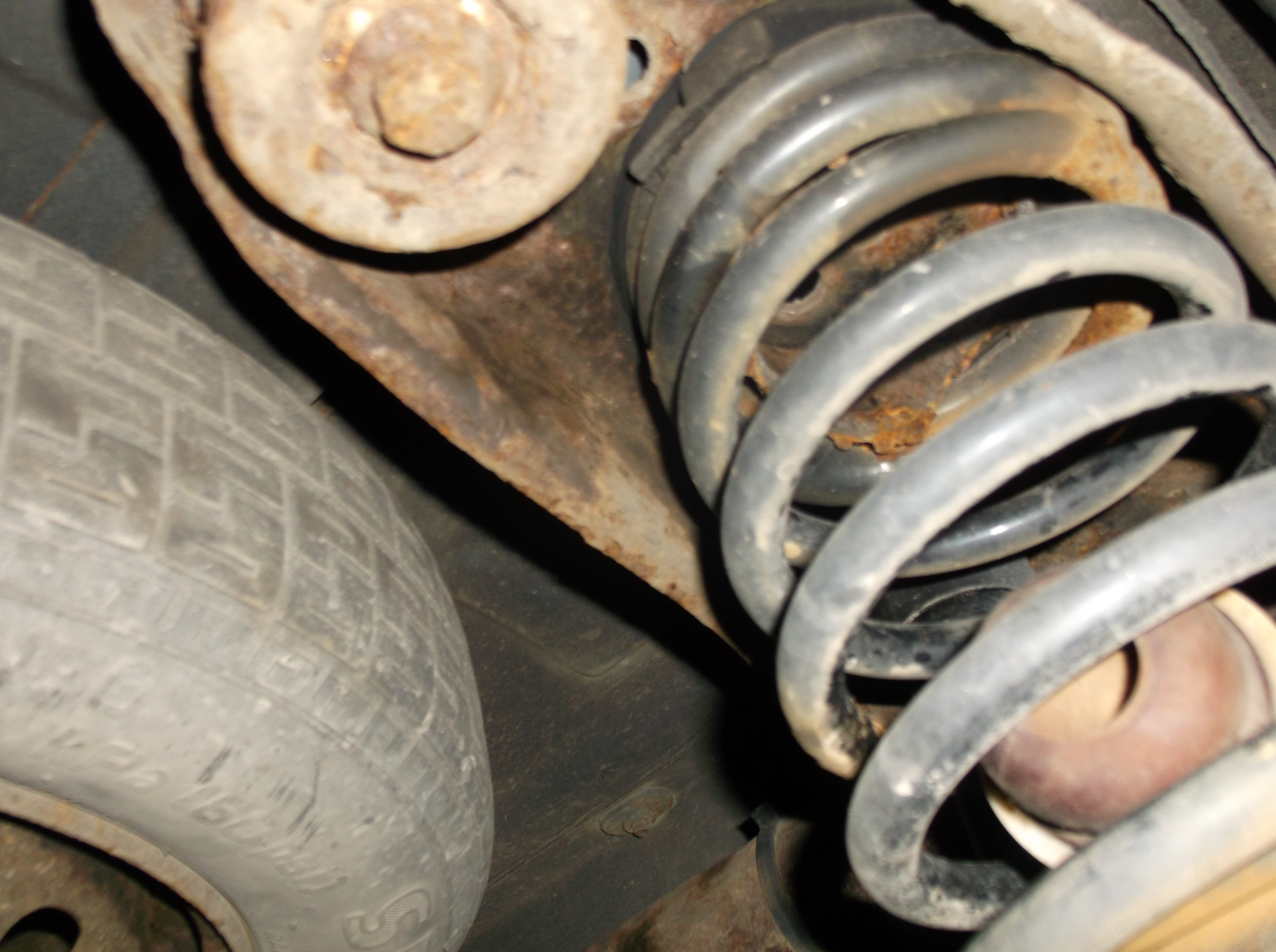

Where is the corrosion?
I'm guessing that the corrosion is like mine. The turrets which the bump stops fit into have largely rusted away, and the rust will start to eat the surrounding metalwork, where the tops of the springs sit.
This is a photo I took of the good side (nearside) in 2011.
That's pretty much correct Chris, except my springson the right side are completely detached. Noticed it when changing the drums and shoes a month ago.
