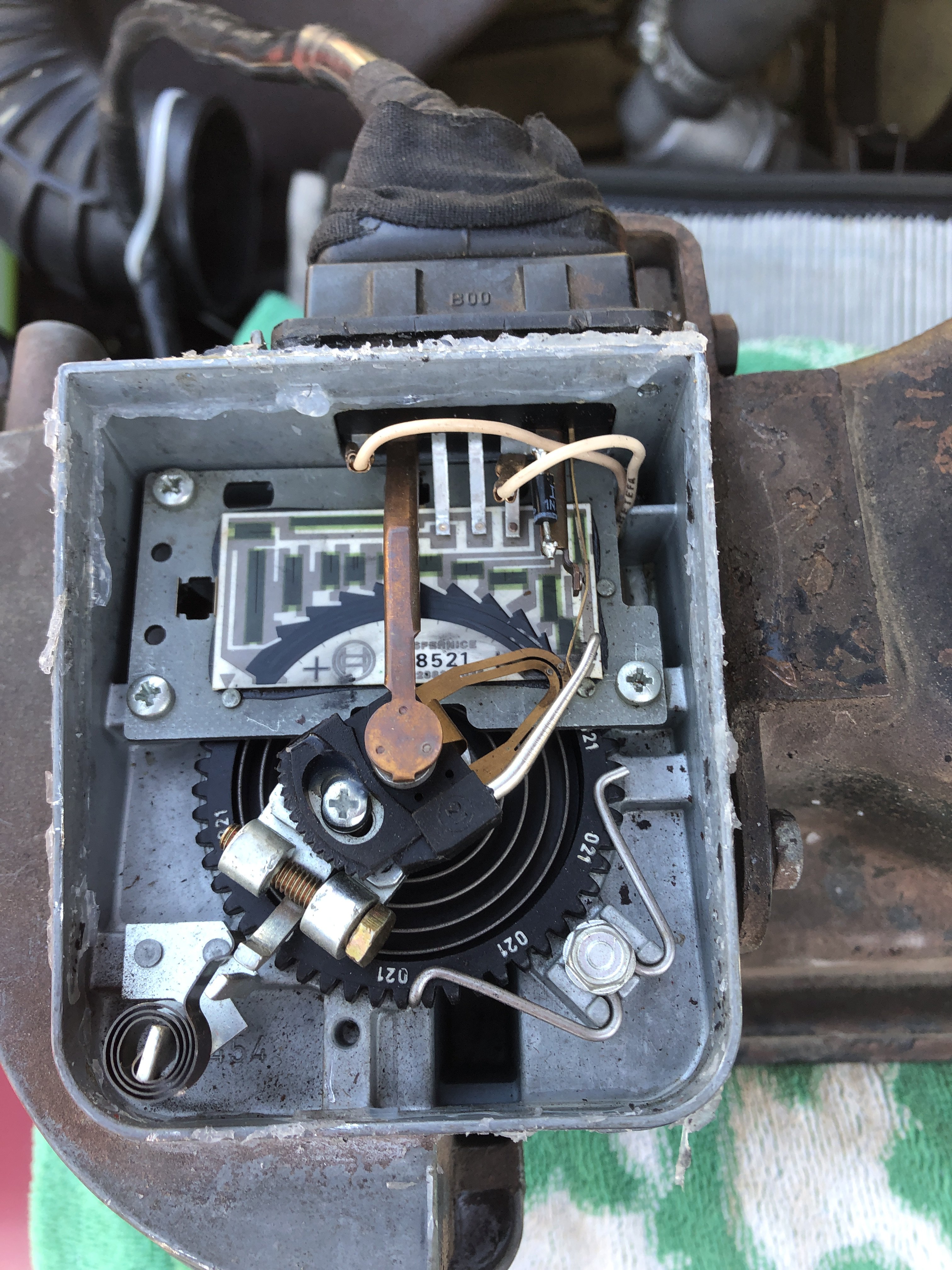

Update. I ordered and rec'd a new ECU from Midwest-Bayless. Great service from Matt. Unfortunately Canada Customs decided to sit on it for three weeks! Just rec'd it today. We've been having abnormal hot weather for October in Montreal so all excited to get it installed and running again. It started up first crank. Took it around the block only to have it sputter again. Such a discouraging disappointment. This time for whatever freaking reason. The tach was jumping all over the place.
The only thing left to change is the MFS. I opened it up but not sure what I'm looking at. It could be dirty. I cleaned gently it with a Q-tip. But no change. Not sure if the wear surface could be worn, but why would it sputter?
I hoped to have overcome the issue. Now, i'm just going to store it for the winter and then decide what happens next spring.
