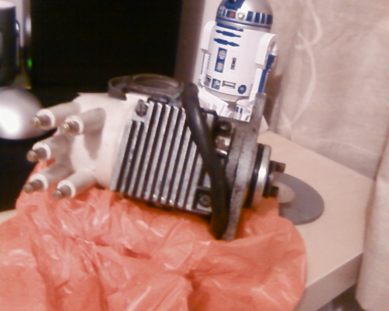

Difficulty starting and stalling when warm - dizzy ignition amplifier module?
Is it likly to be this?
Will change it next then me thinks.
Anyone a spare one to sell? It's one of these ones, with the cooling fins look
Pic pinched from firstcar-y10 I think from another thread :eek:
I assume all 4x4's were 'points' less, and electronic, wern't they :confused:
Jon.
I would put money on it being that thing*looks up*
Had lots of fun when mine started playing up... mainly at traffic lights, T junctions and roundabouts (n)
The two distributors, Marelli and Ducellier, will interchange mechanically but the wiring connections will not. I do not know if the looms/plugs are in any way compatible as I have never had a Ducellier unit to compare.
Although both Marelli and Ducellier distributors are available with points or electronic components, on the 4x4's from 86on ( and possibly before ) only electronic units were fitted.
Re the Marelli distributors AMP, remove the screws and carefully lift the AMP away from the body, look for cracks in the insulation of the two wires where they exit the black sealant. I think that you will find that this is what "Default User" is referring to.

Hi Jon. Check the two wires going into the amp on the dizzy. They have a nasty habit of breaking right where they enter and can't be changed. They might be making and breaking contact intermittently.
I think I know exactly where you mean. Just by the plug? Similar is happening on the 1988 Sisley, the wire is changeable on that though (when I get around to it)
